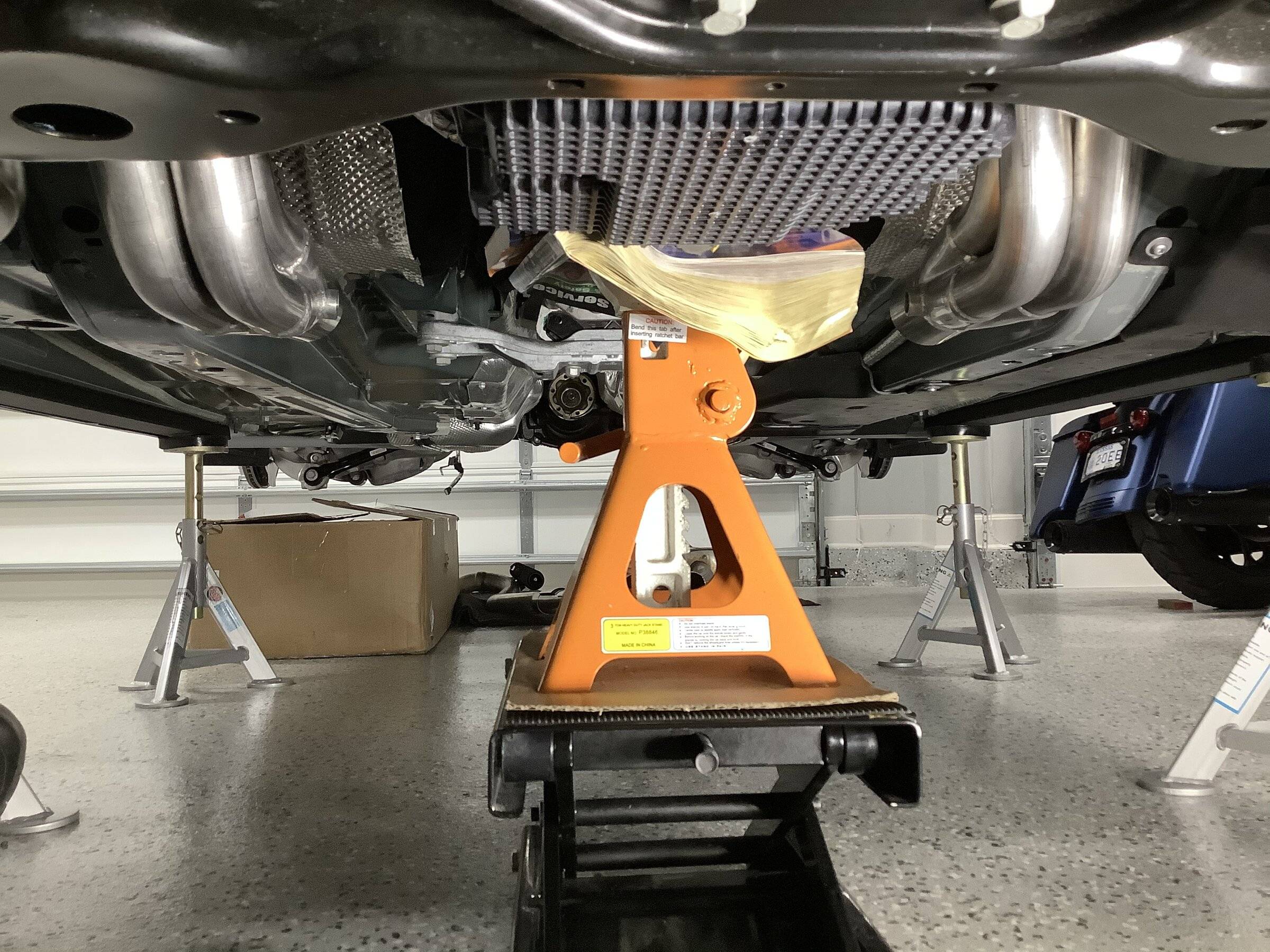

Yes, use an old phone book (yellow pages or white pages) and put it in this location and you won’t have to worry about damaging the oil pan.
Do you have it placed on the transmission bellhousing ?
