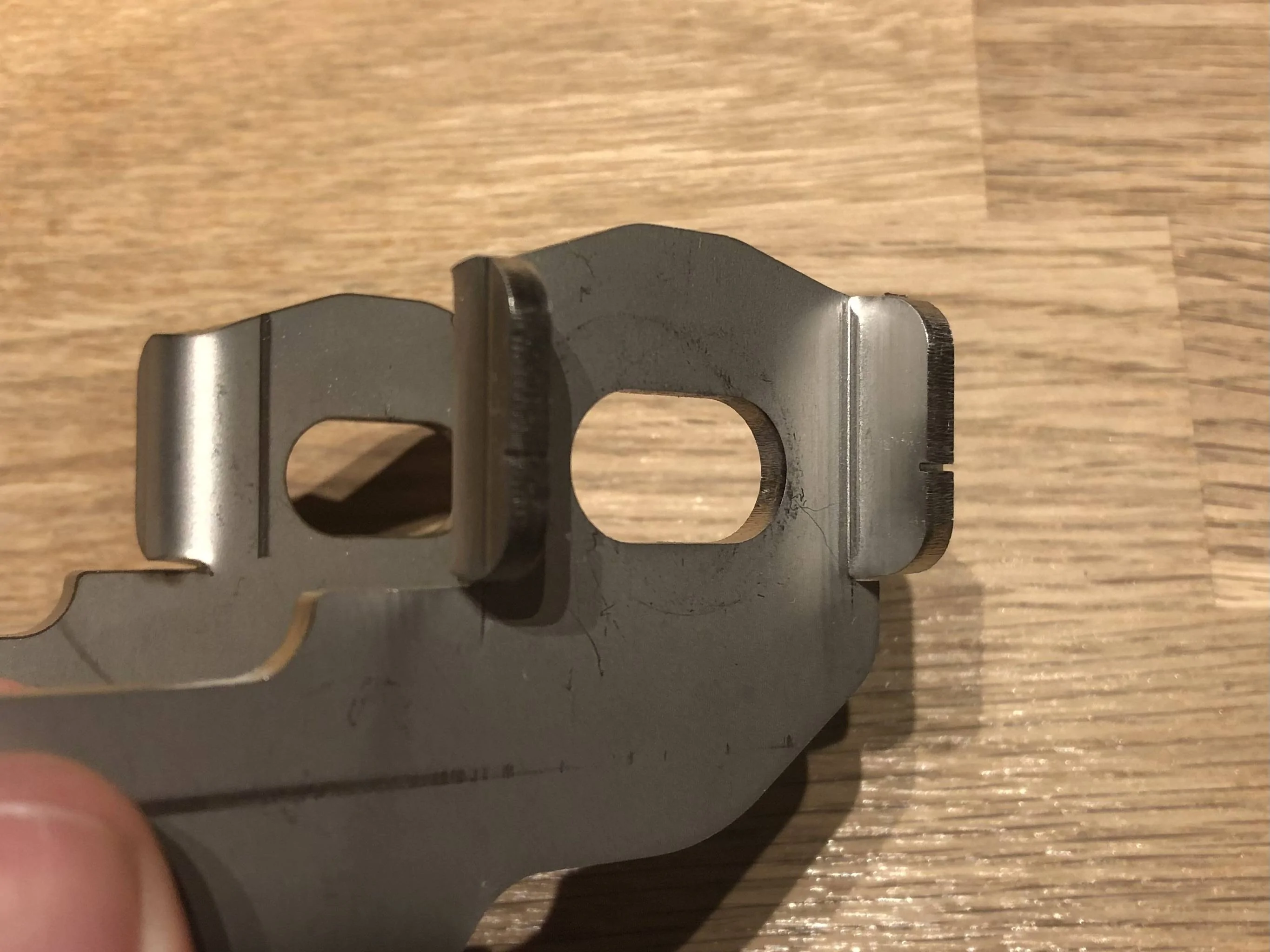

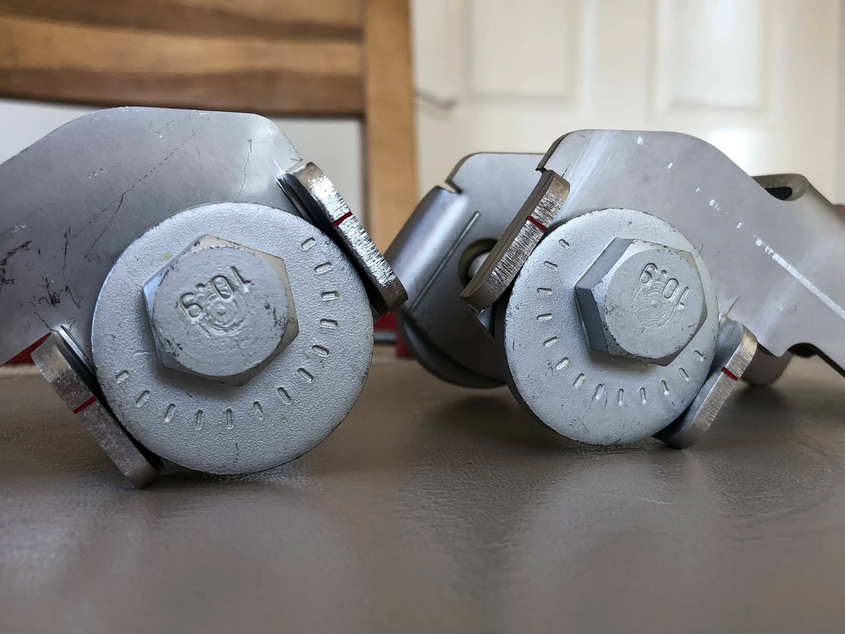

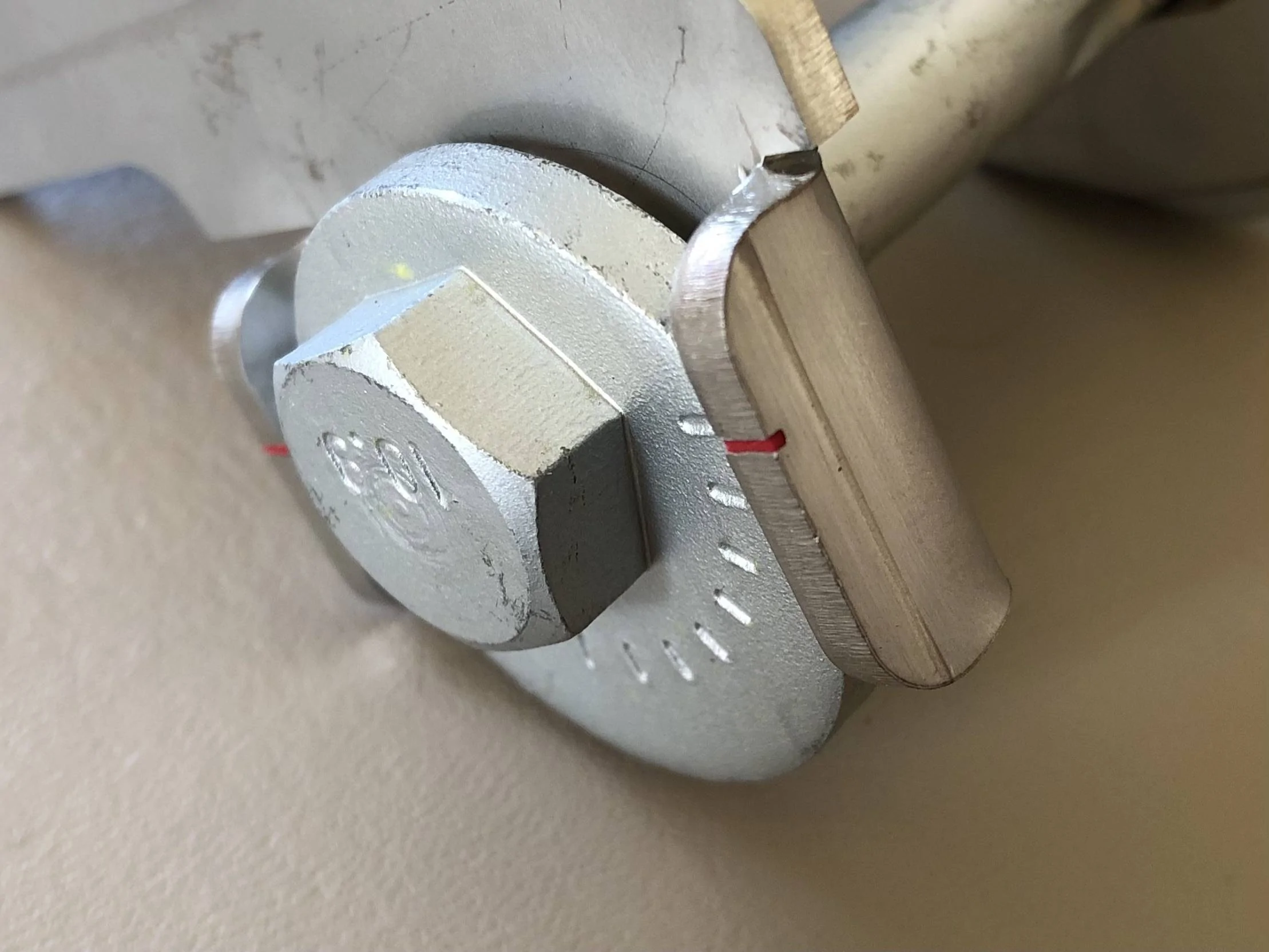

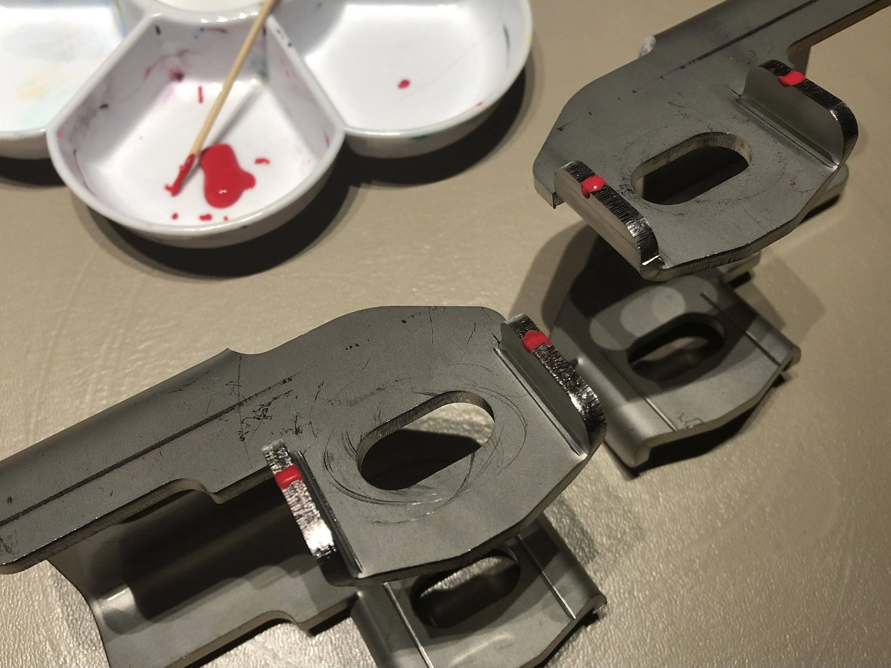

If it helps, and if I have done my sums correctly :
Slight mod with the hacksaw :
Some of my eldest daughters craft supplies :
Quick wipe with thinners :
Hopefully this will remove some of the guesswork :
I understand that 'Approx' 1mm of movement = 0.15 deg, so if I've done my measurements and maths correctly, each notch should move the camber approx 0.13 deg.

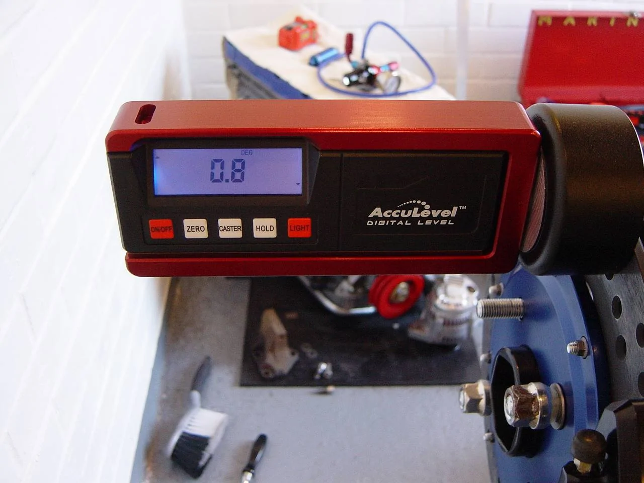

I just use a small square magnetic angle gauge from eBay for $12. It can be placed 90* and then zeroed out. Clips right onto the rotor.

Yeah, but that can't be zeroed out on a flat but non-level surface, right?
Pluss my little guy is only 2" square and can be easily placed with the wheel on. I just have to turn on its backlight to read.

There is a zero button.
I also built a zeroing function into the wheel adaptor that I made.
I’ve no problem with the critique - there were very few other options at the time I bought it, truth be known and if I was doing it again ā€˜today’, I would probably just use inclinometer on the iPhone … lol
