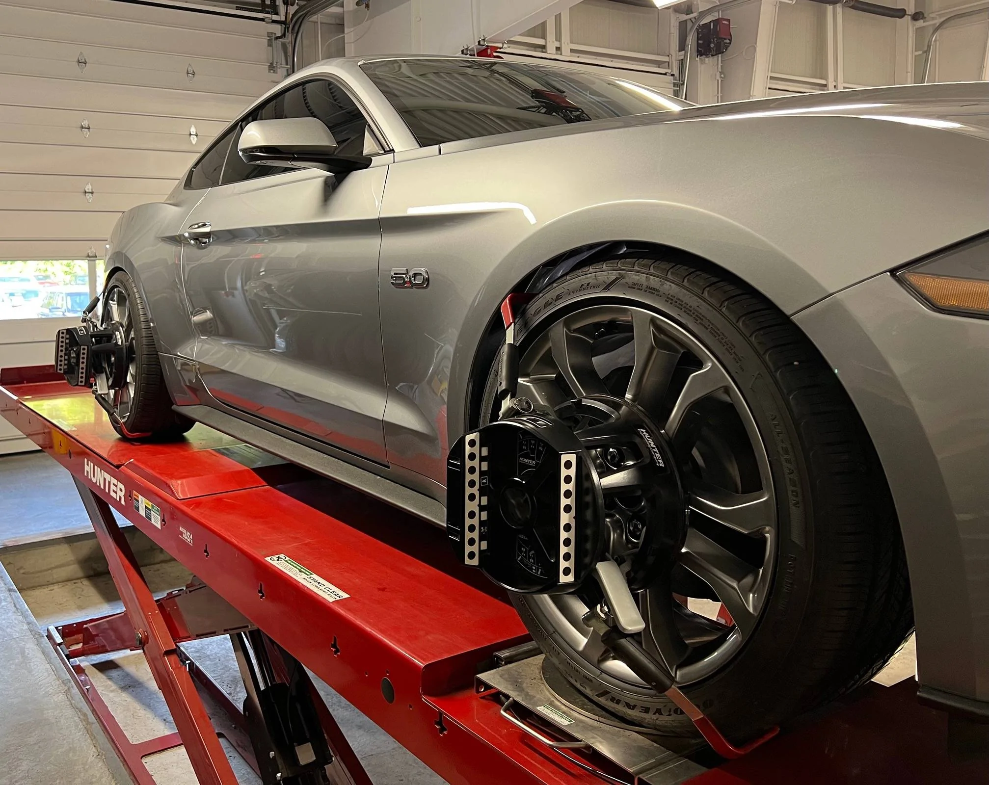

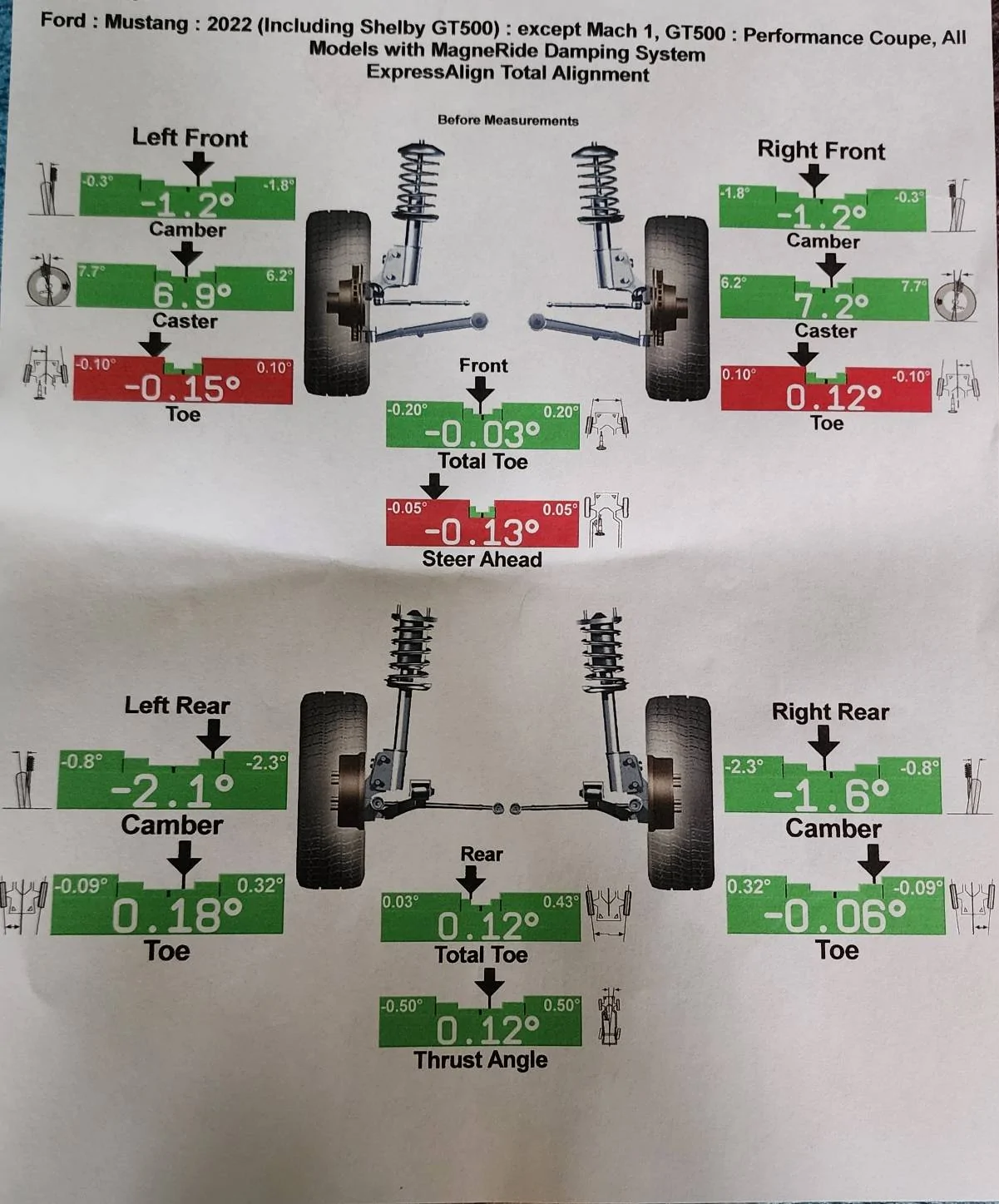

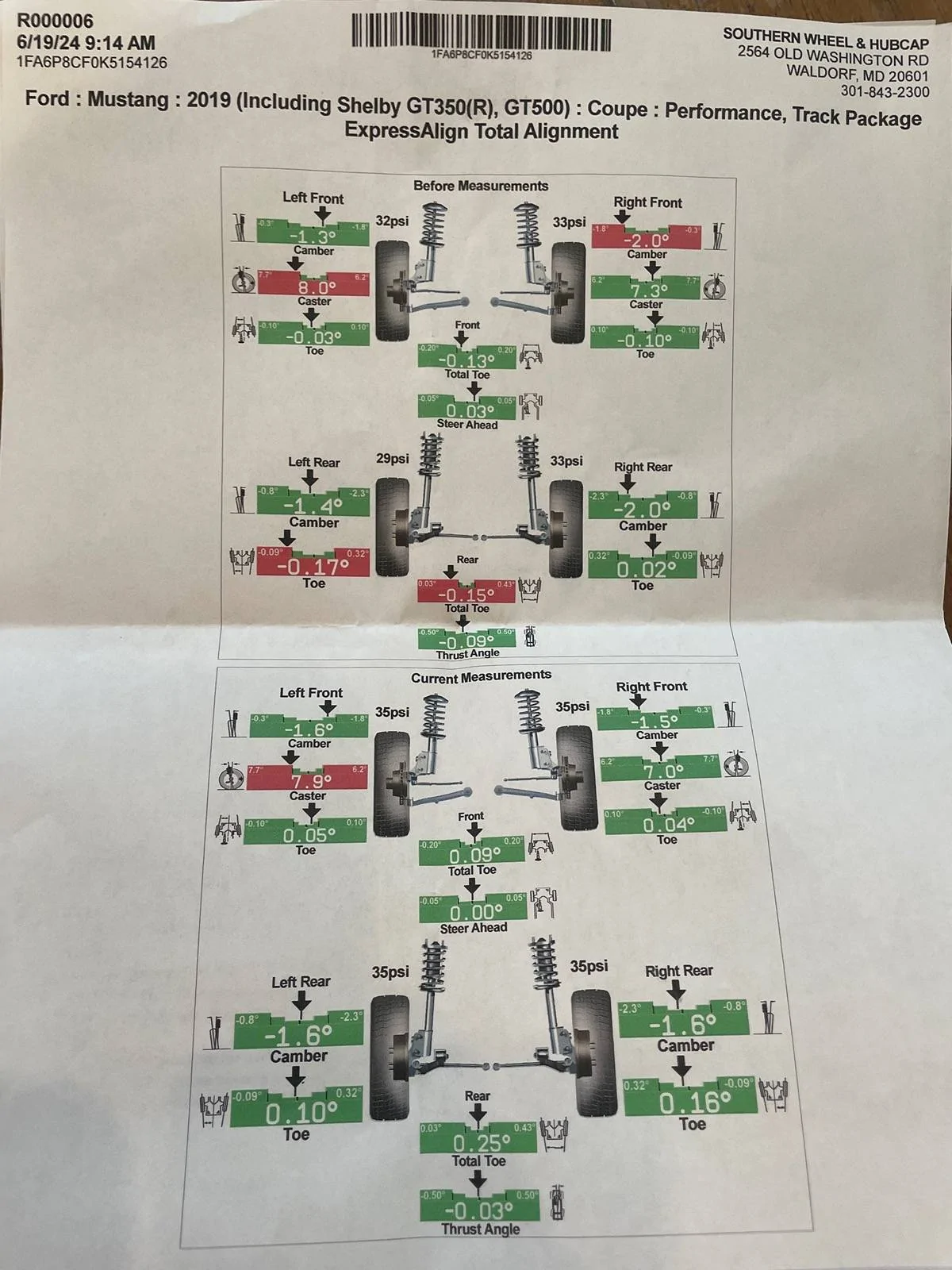

So, I'm going to chalk this up as a learning experience. I've owned many cars over the years, but this is the first one that I am actually doing something with.
I've at least found someone that wasn't afraid to do the alignment. I guess 5th option was a charm. They made the adjustments and got it cleaned up to were it looks better than before. However, in the end the subframe alignment will need to be done to get it truly where it should be. It's not far off from where it should be, and I'm nitpicking but thats what owners do. I got the parts but it looks good for now. Will save that job for winter or next spring when I lower it.
Thank you to all those who offered up advice and direction.

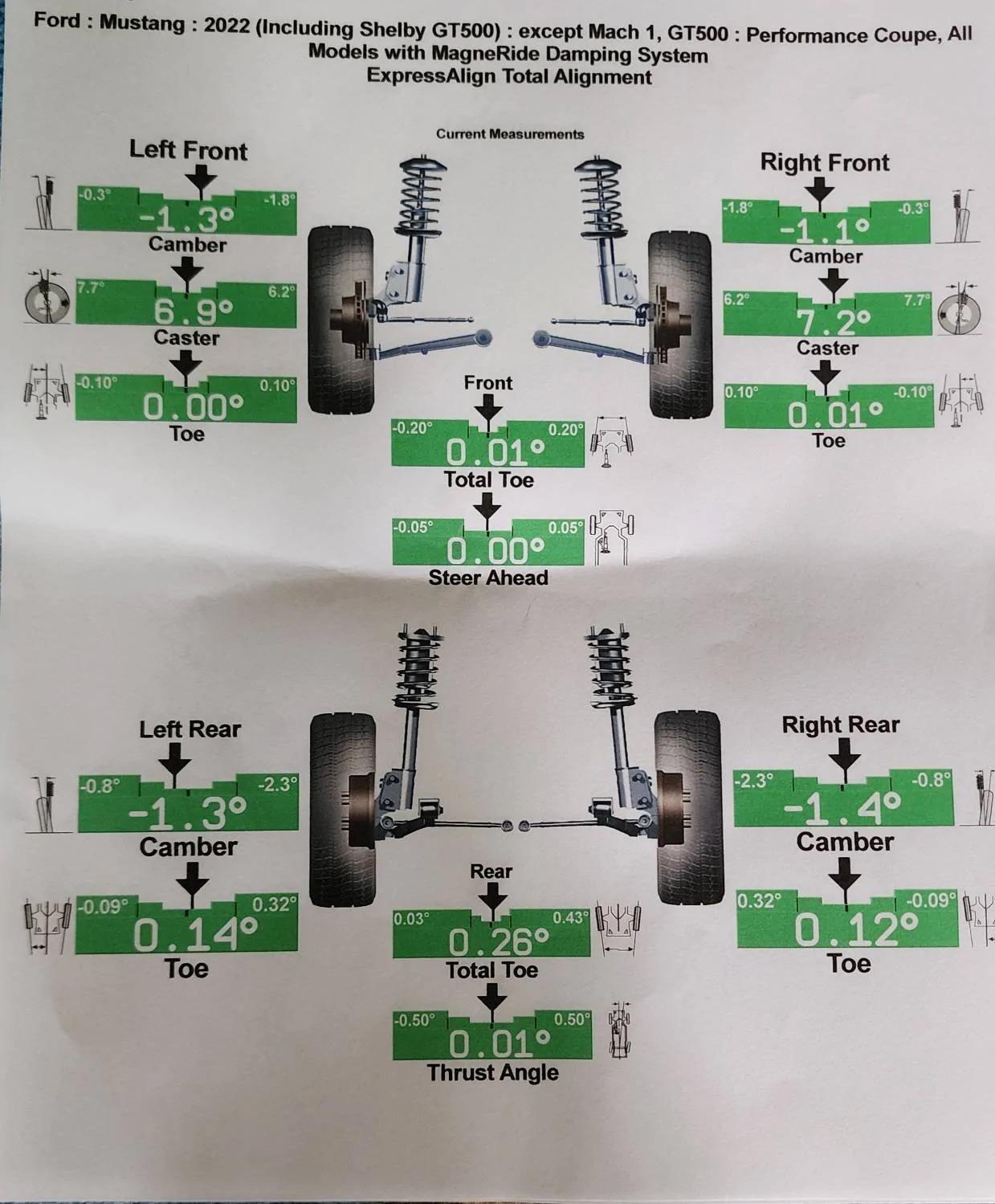

Before and after.

Glad you found someone to do the alignment and that it's closer than it was. More often than not, the subframes are not exactly where they should be and the problem is, they can be off fore and aft, side-to-side and rotationally (about the vertical axis, obviously not the longitudinal axis). This compounds (through tolerance stacking) any misalignment in camber, toe, etc., hence the need to base the alignment on a zero reference. Math is great, but unless one does all the math, one won't quite be there yet.

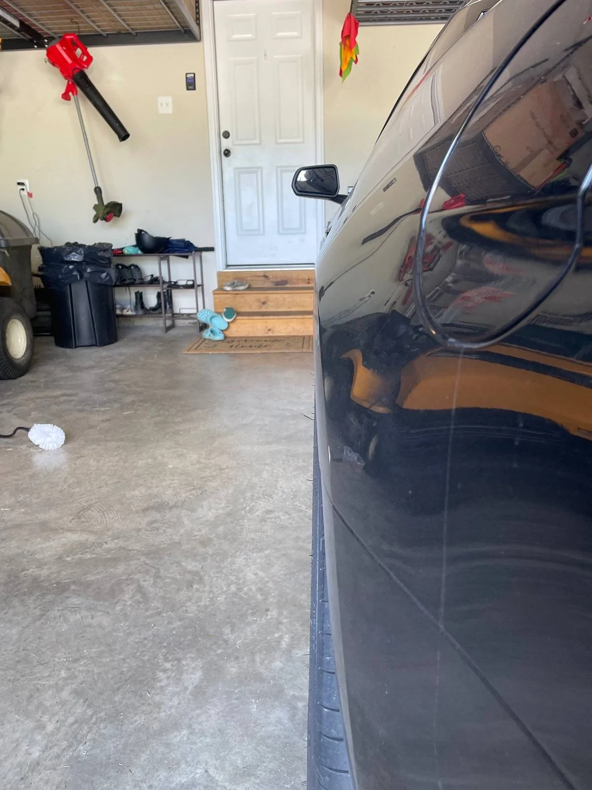

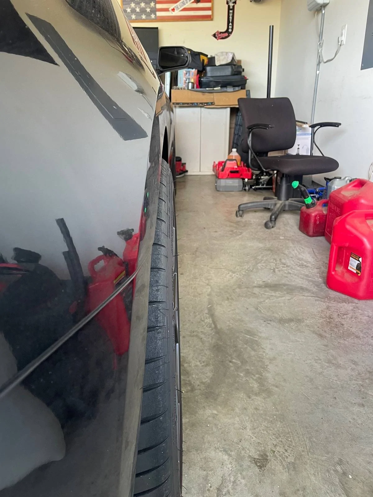

I just went through the same thing. After a custom alignment, the subframe shift on the passenger side, front and especially the rear was noticeable. Not only that the passenger side rear sits 1/4” higher, the front passenger is about 3/8” higher.

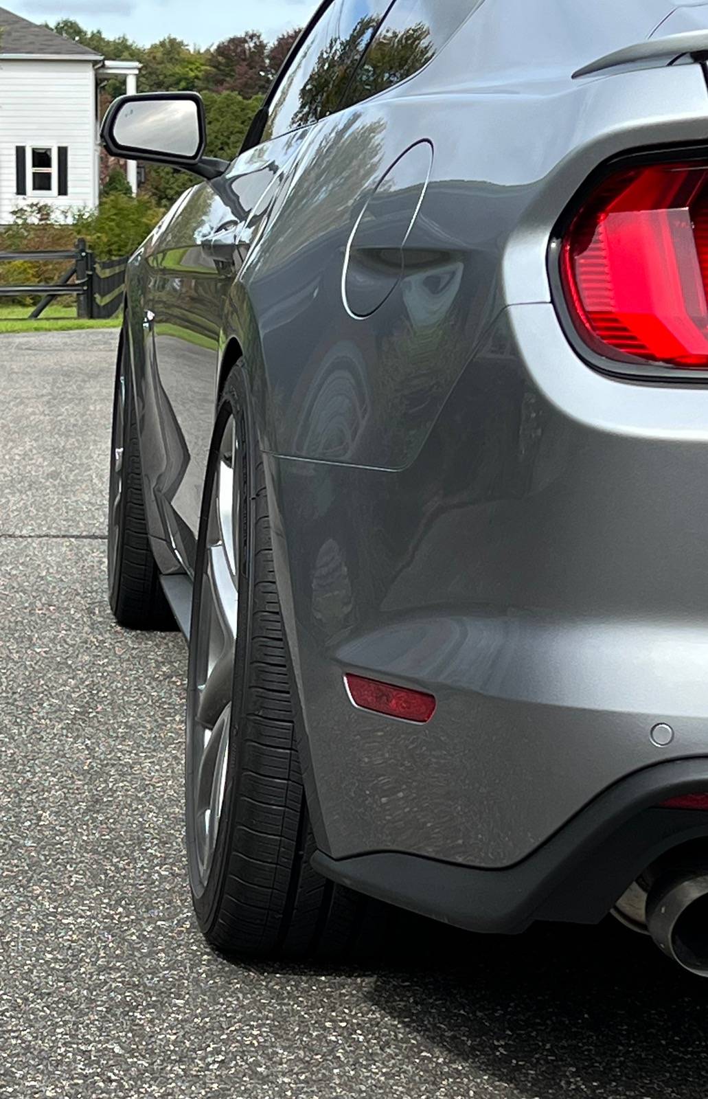

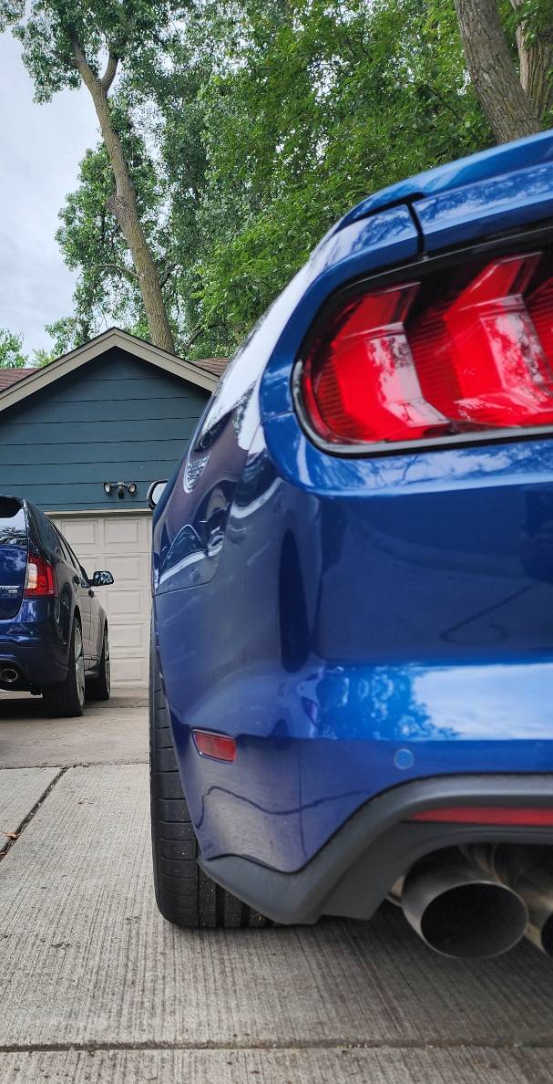

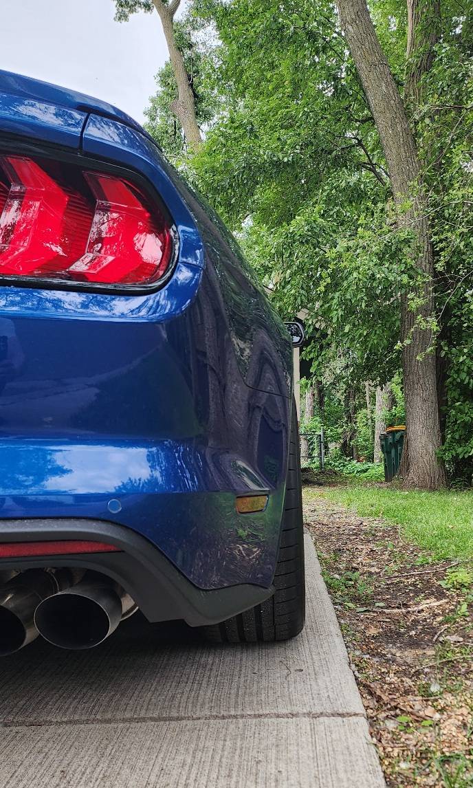

This is my after look. From behind you see the difference, but from the side since they reduced the neg camber it looks much better.
