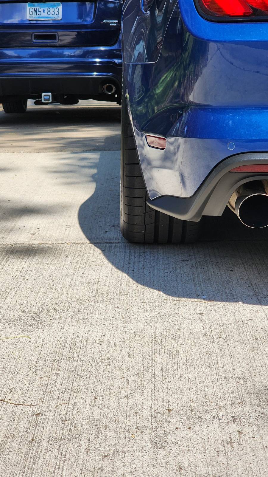

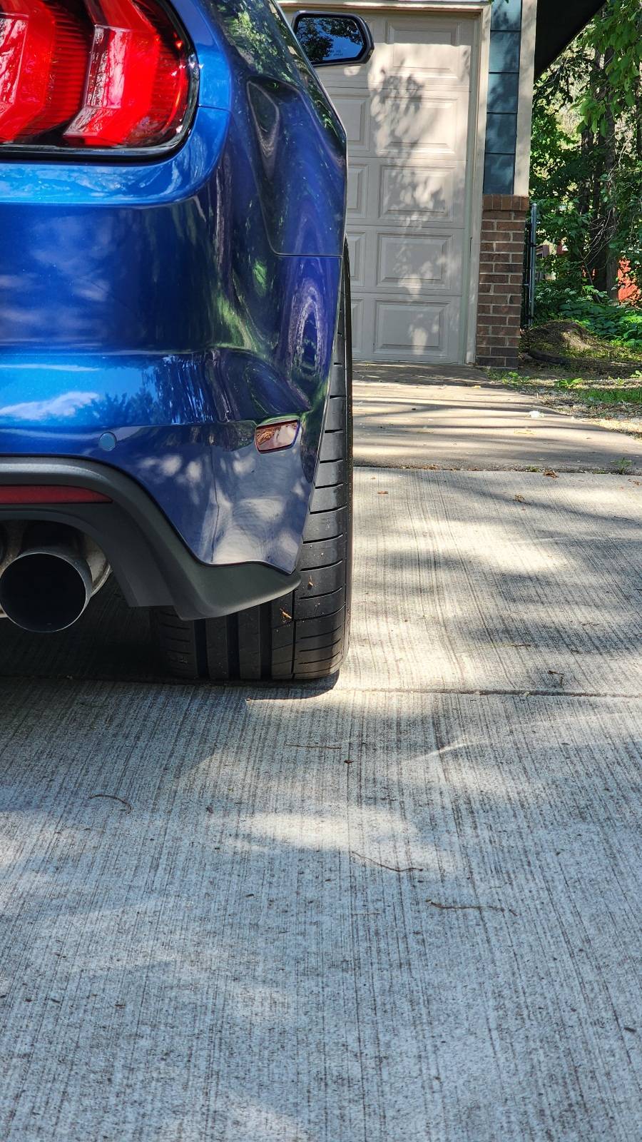

About a week ago I had my new wheel & tire combination installed. The goal was to move on from the tucked look, and move more towards the flush, but still remain inside the fender (19X9.5, 33 offset, 265/40 19).
Seeing how alot of others in here have gone with much wider setups and still remain flush, I thought this would be a non issue.
Apparently, my car has the same issue as many others have experienced, one side sticking further out then the other. Right side, slight poke while left side tucked in. The very thing I was trying to avoid by choosing this option.

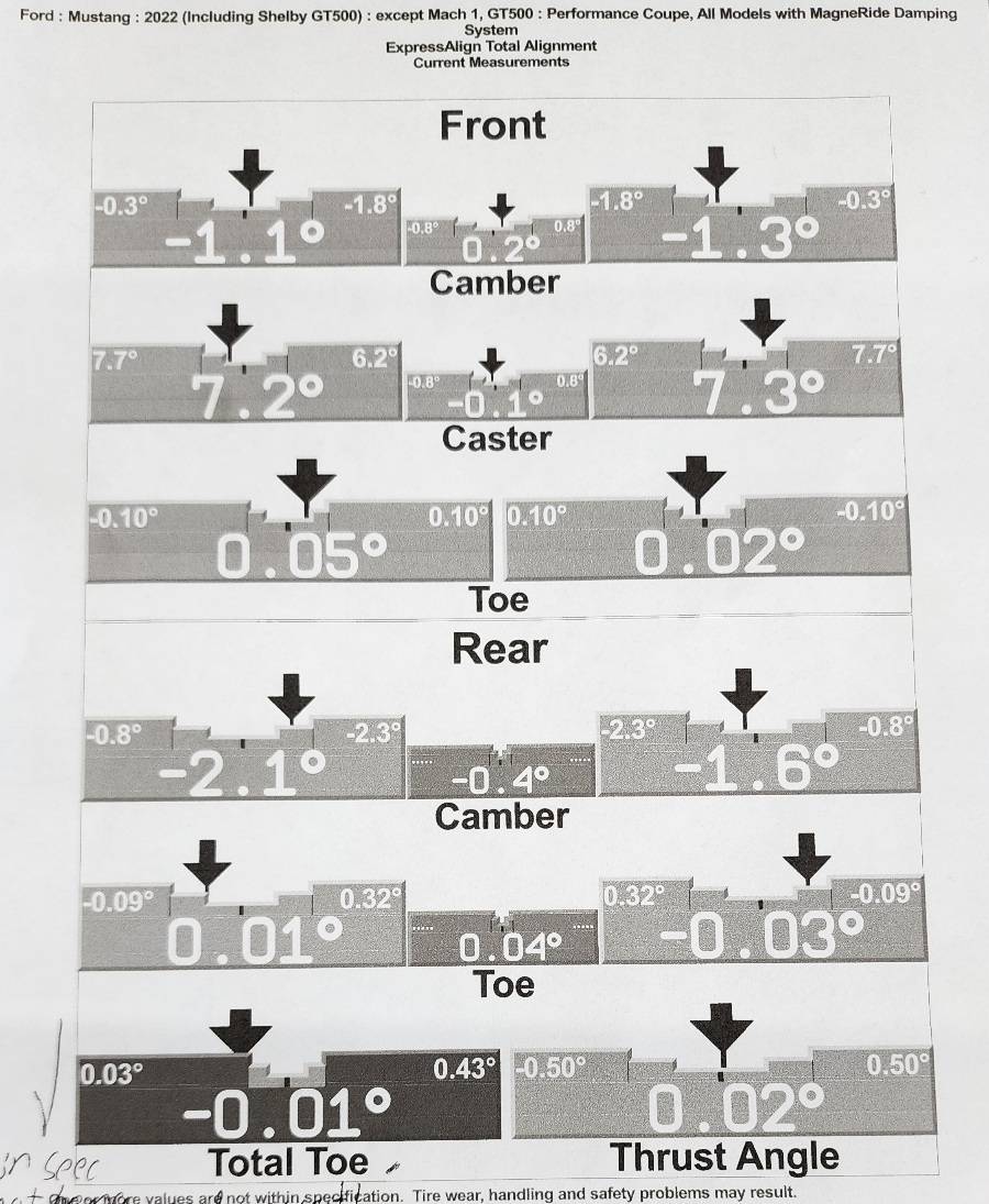

I have had the alignment checked and will share that along with pics of the left and right side.
I measured the distance from fender to top of center cap ridge on both sides using a plum bob, to see how much difference there was. The passenger rear, measured at 2 1/16 inch vs drivers side 2 1/4 inch. Obviously tucked in, this is not seen. Honestly the difference seems like it shouldn't matter. But what about when you add your alignment into the equation? The difference on each side could make it appear worse.

It could be as simple as your camber is different from side to side. Since camber pivots around the RLCA, less camber is going to push the top of the wheel out.
This is what I was originally hoping for but of course its the drivers side (the most challenging) to adjust. The shop today didn't want to mess with it.

My math says if your camber was even, your pump bob difference left/right would be within 0.004"
I.e. you don't need to mess with recentering the subframe, the subframe is fine, you just need to get an alignment to even the camber, and for a street car, yes, just fix the right side.

It's the camber, look at your rear specs.

I mean the rear is a little annoying to adjust because of the cross talk between toe and camber, but its not THAT bad. After the car is on the rack and the alignment equipment is attached, its probably <10 minutes of fiddling. I've watched my mechanic do it a few times and I've had a ton of alignments. They've always been able to get the rear within <0.1-0.2° side to side. I wouldn't expect them to get it to read perfect.
Your toe needs adjusting in the rear anyways. You want like 0.13 toe in on each side, or like 0.25 total with very minor variance side to side. Helps the car be predictable when spinning wheels in a straight line and keeps the rear nicely planted in corners.
