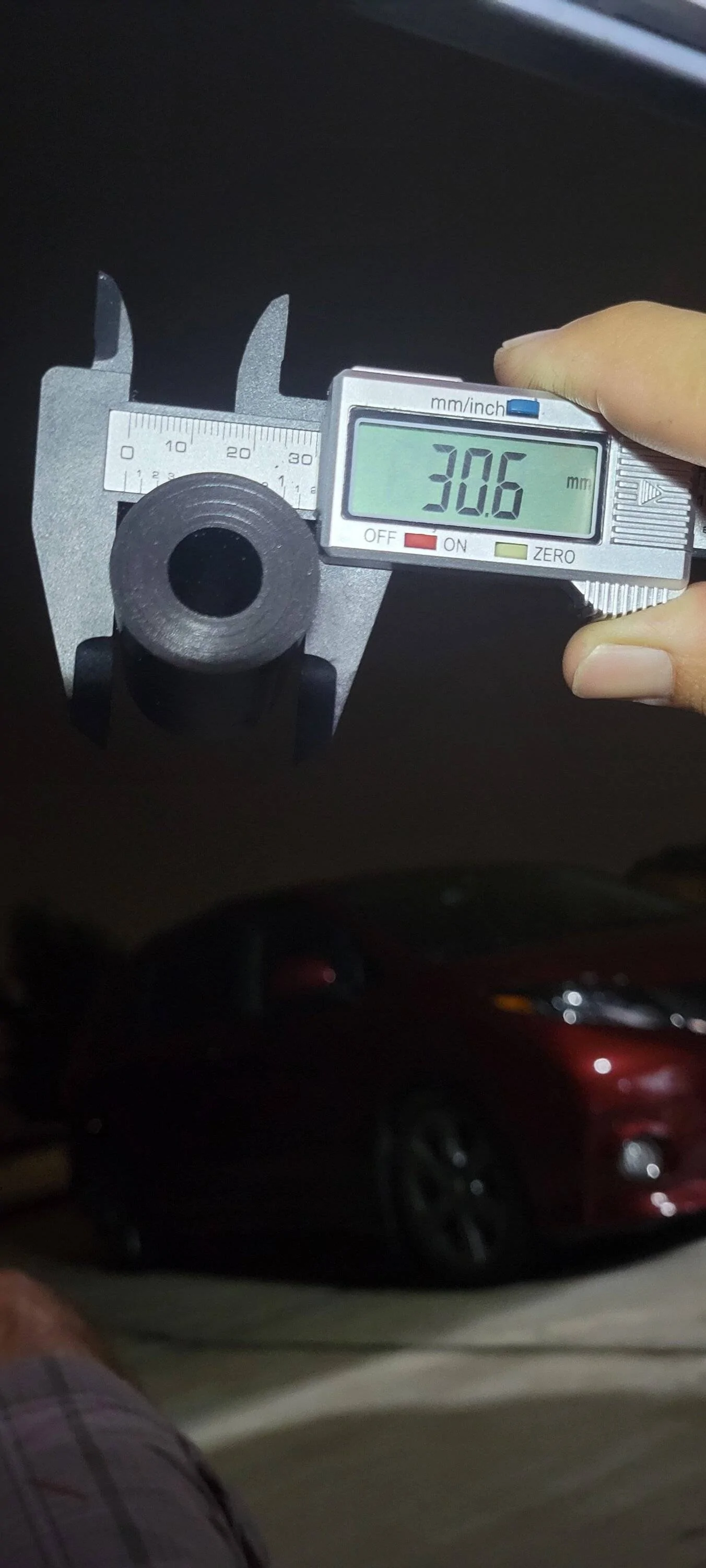

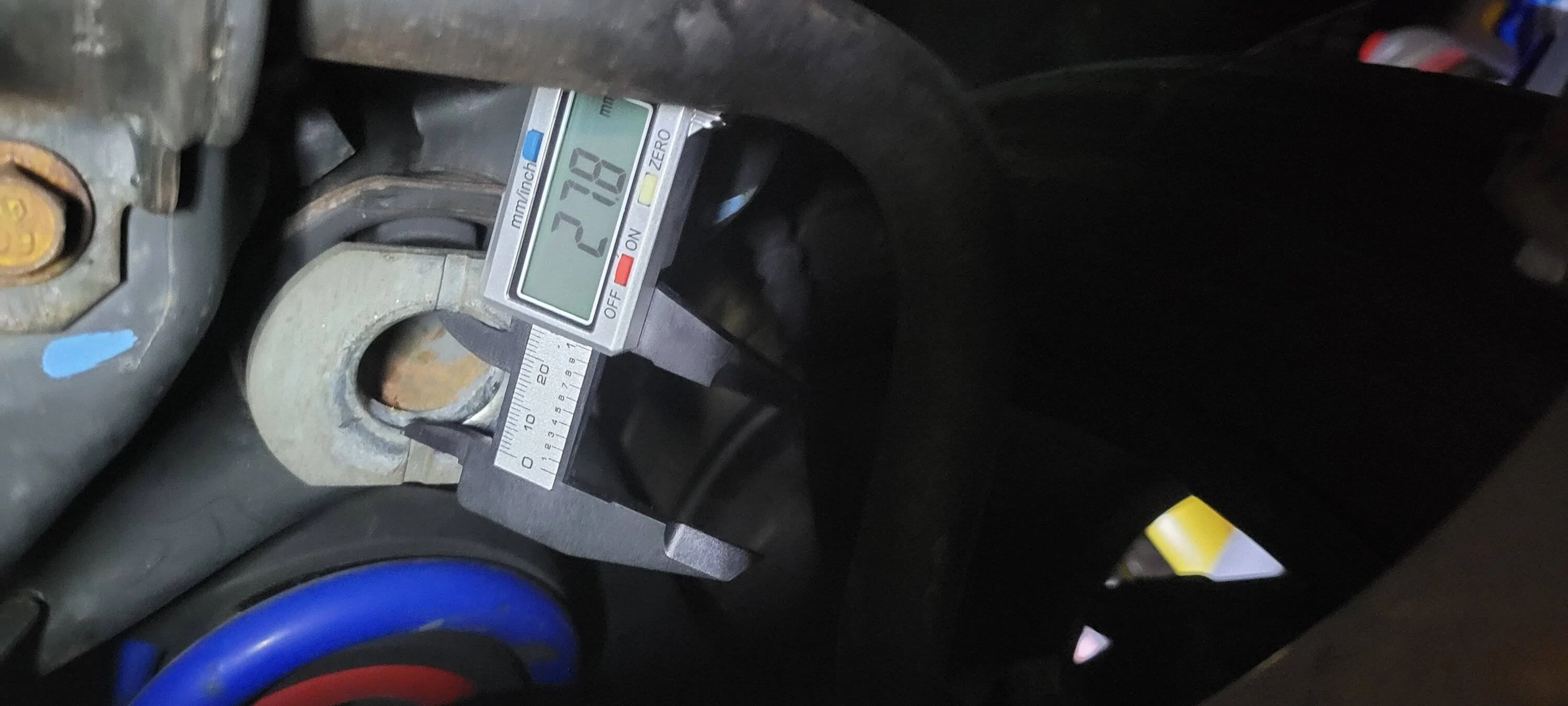

Looks like the OD of all 4 is the same. I tried completely dropping the subframe with the driveshaft still connected, but still couldn't get enough clearance for the rear 2 sleeves (to drop in from top).
Clearly to push in from the bottom the sleeves need to be 2 to 3 mm smaller.
I also tried using the supplied bolt and washer and an impact gun to try to force in the Dowell / bushing from the bottom.... but no luck.
Any suggestions? (Besides buy the steeda kit)

I ended up getting the diameter cut down by 3mm and they slid right in. Luckily there is a machine shop at my job so there was no cost to me.

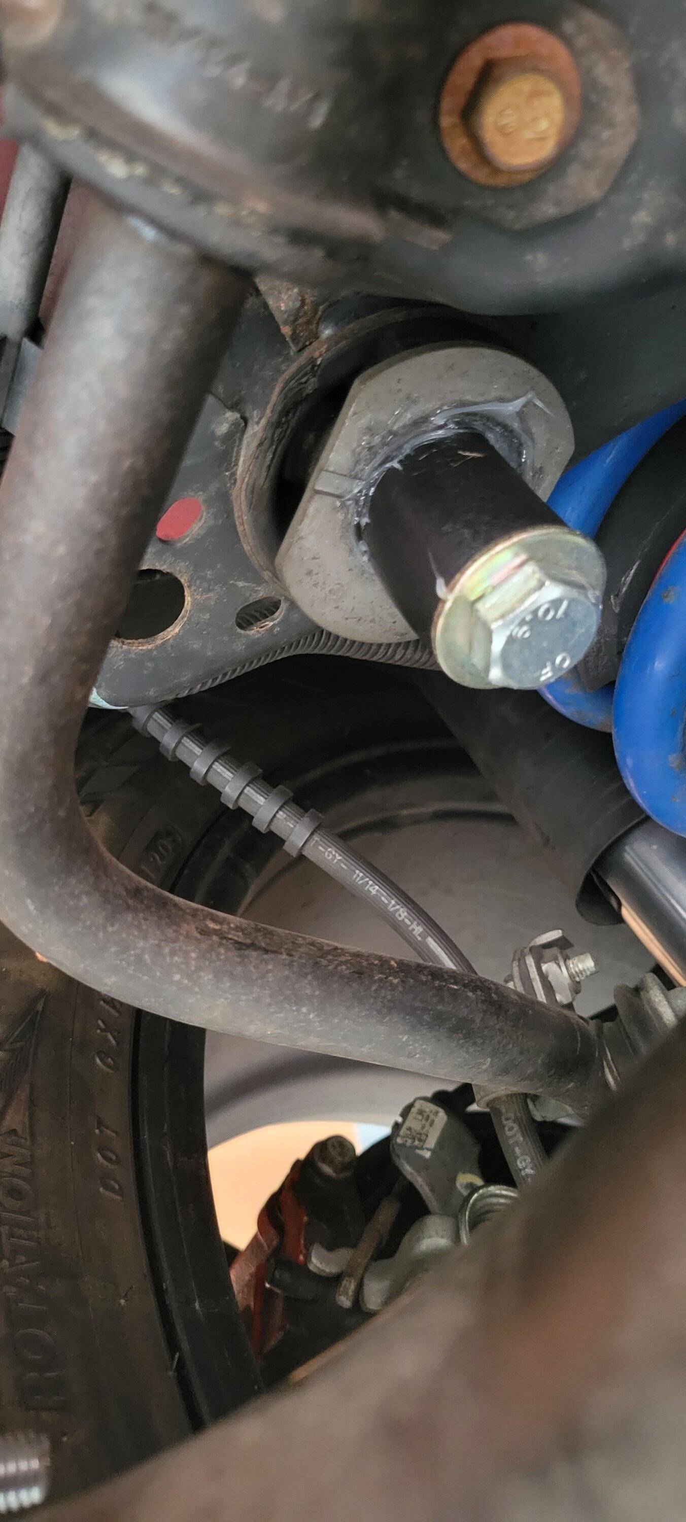

Lube it up, Get it started, then I used a floor jack with a piece of 2x4 to press it in

Very easy to install, I had the same problem but didn’t read the directions lol, take a large screw driver or pry bar and remove that metal washer/flange then the bushing slides in and then reinstall the washer/flange back on and as you tighten the bolt it will pop back into place, I believe it was only on the rear of the sub frame and the front 2 slide right in , hope this helps
