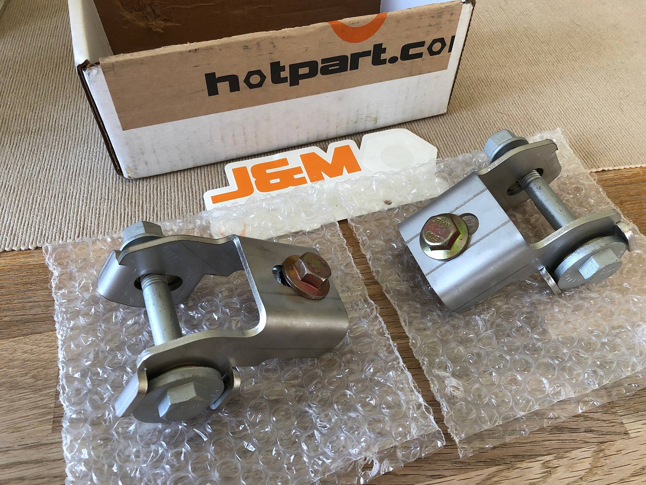

I've been tempted to get the Steeda rear camber adjusters.

Got a link?
J&M / hot part also do a stainless version, which I think sits in the middle of the two (pricing wise) :like:
WD :like:
WD :like:
Thanks, WD! I just ordered it. It's about time to do another string alignment anyway.
(I sure hope that bolt is strong enough for the load.)

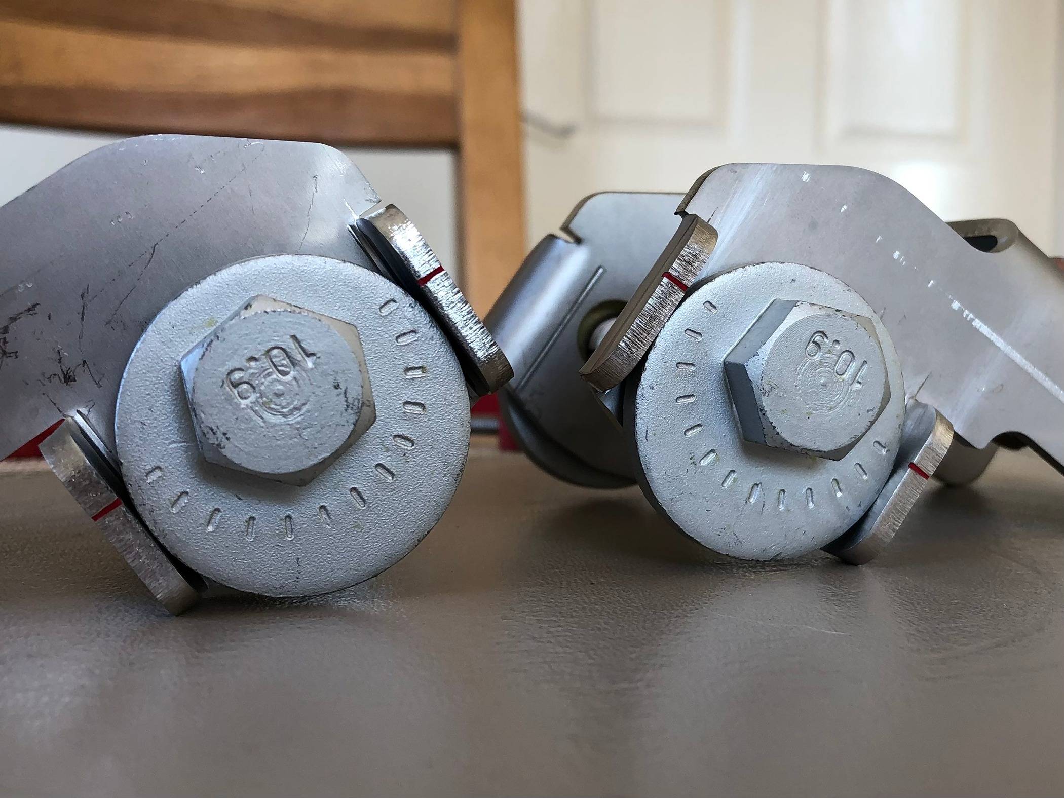

They are the same diameter as OE and they are 10.9's. They appear to be of quality manufacture, and with a quality coating :
you still need to take the weight off like traditional. The eccentric just makes the amount of movement predictable.
