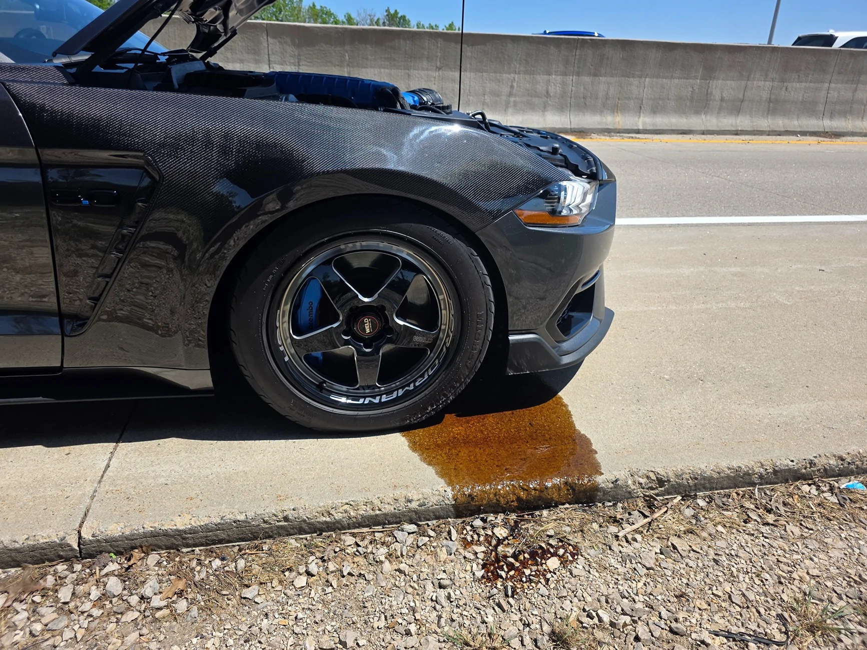

So unfortunately yesterday I had a catastrophic engine failure. So now I need to decide if I want to go with a predator or a coyote. I want to be safe around 1300 rwhp and honestly never really see myself going past that but I also dont want to pushing the limit of the motor. What are the pros and cons of each setup. If I do go predator what do I have to change on the car?
Attached is the carnage video.

Haven't had a chance to pull it apart yet, it happened about 1 in the afternoon yesterday but there's definitely a hole in block in the driver's side and in the oilpan.
