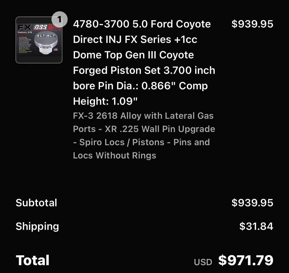

I have a predator crank coyote boostline rods and 3.7 coyote pistons 12:1 and predator block. Do I need to lock into some lower compression piston?
I can't answer what compression you need. Ask your tuner. Post up part numbers for rods and pistons.

I looked up your pistons with a 1.09" comp height as I remember the comp height of coyote pistons to be ~1.168". I'm not sure what Predator pistons stock are but the Voodoo is 1.161" for the increased stroke.
From DSS:
"323 Ford Coyote Direct INJ , FX, Comp Height: 1.09, +1cc Dome Top, PIN: .866", Full-Floating or Press Fit, Ring Groove: 1.5/1.5/3MM, Stroke: 3.750", ROD: 5.95, Approx Comp Ratio: 52cc-12.41, 57cc-11.49, 62cc-10.73"
It seems these are stroker pistons.
You need to do the math knowing the deck height, comp height, stroke and rod length.
