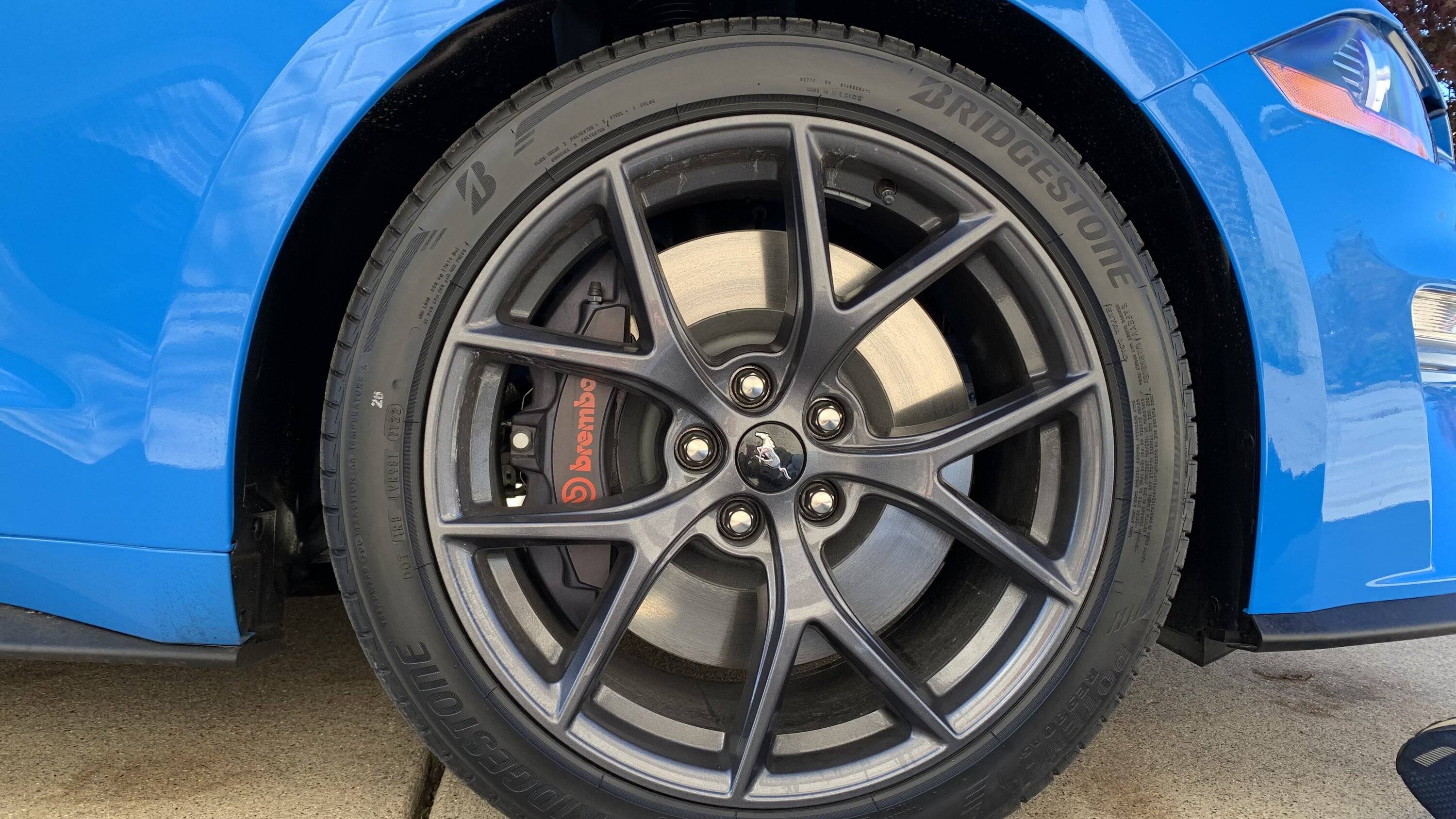

Big recommendation from me for Bridgestone RE980 AS+ UHP all seasons. I’m usually “Team Michelin” but these have been outstanding.
