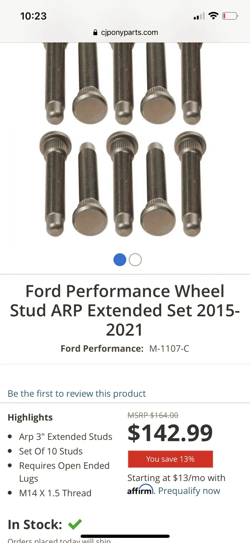

I did the wheel stud change on the front for function. I changed them on the rear so they'd all be the same. If you're using ARP's, there are two lengths. The longer is for use with spacers on the front & shorter is without spacers for the rear. It bugged me having the two ends of the car different and it's not that big of a job.
How much did you paid for the studs ?
I went with the ford racing hubs because the price was not too bad and included all new hardware including lug nuts and hubs are also kind of a maintenance parts, especially on a track car

I just did the stud swap last week. It's a matter of getting the brakes out of the way, getting them pressed out and new ones in. I used a ball joint removal tool ( https://www.harborfreight.com/3-4-q...r-99849.html?_br_psugg_q=ball+joint+separator ) to remove them. I just had to remove a bit of material for head clearance. For pulling the new ones in, just get a 14mm nut from the hardware store along with some spacers and crank down until they're seated (I used an impact). It really wasn't very difficult. I still have my 20" Roush wheels that will go back on when I'm going long distances. The only difference in fit is that the narrower wheels (mine are 9.5" wide) don't need the 25mm spacer, and the extended studs require open ended lug nuts on the front. No reason to change anything on the rear. Several of the 200tw tires are actually cheaper than the PS4s.
Thanks! I have a ball joint removal tool, haven’t used it in years but I think it’s similar. I can pickup that HF one in your link if that’s the “one” to use. :-) I also have some other puller tools, slide-hammers, etc. Really didn’t want to, if I didn’t *have* to, but sounds like it’s the right path to go down. I’ve swapped axles/hubs on 4x4’s but not actual studs. I read somewhere about a guy breaking the Mustang studs off in the hub. I don’t want to do that lol. Thankfully it’s not a DD so it can sit for a long time.
How were they different, the color?
I'd just get the cheap HF one so you don't mess up a good one by grinding on it. Only thing would be if the other one can get used without modification. I wouldn't worry about breaking them off. Mine came out quite easily. I did use an impact to run the tool. My main concern was just to make sure I wasn't putting impact load on the bearings. I've seen people just hit them out with a BFH, but that can be hard on the wheel bearings.
