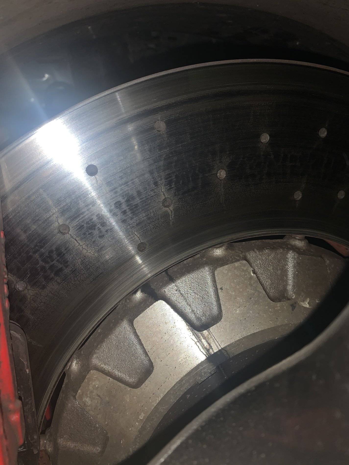

I would help if you had pictures of the rotors. For the most part, there is no need to replace rotors unless they are cracked or warped. I run RA and I use brakes. Rotors last longer then that. I assume the 7100 miles in not track time.

Those look like new to me, no cracks. Just pad slap and do aggressive bed in and you’ll be fine, especially if switching to a more aggressive pad. Stock pads are great though, quiet, bite fast and quite good on track, they just don’t last more than 5 track days if you are aggressive. They do leg rotors last a very long time though. My rotors above have probably 25-30 track days on them with oem pads and still ok for a bit. I’m switching to st43 pads tough on new rotors bc tired of doing so many pad changes all summer

Those look perfectly fine. You should see my rotors, even after cooled, they're still discolored with that beautiful naughty purple hue. I'm extremely hard on the middle pedal though. Btw, NEVER turn your rotors on a high performance vehicle. If you're to the point of where they need to be turned, replace them. Any reason why yo're going with the Powerstop pads and not the stockers? Just curious because if you get stock pads again, your bed in process will be very simply replace pads, some HARD stops to transfer material, and go. Since the pads are the same.
