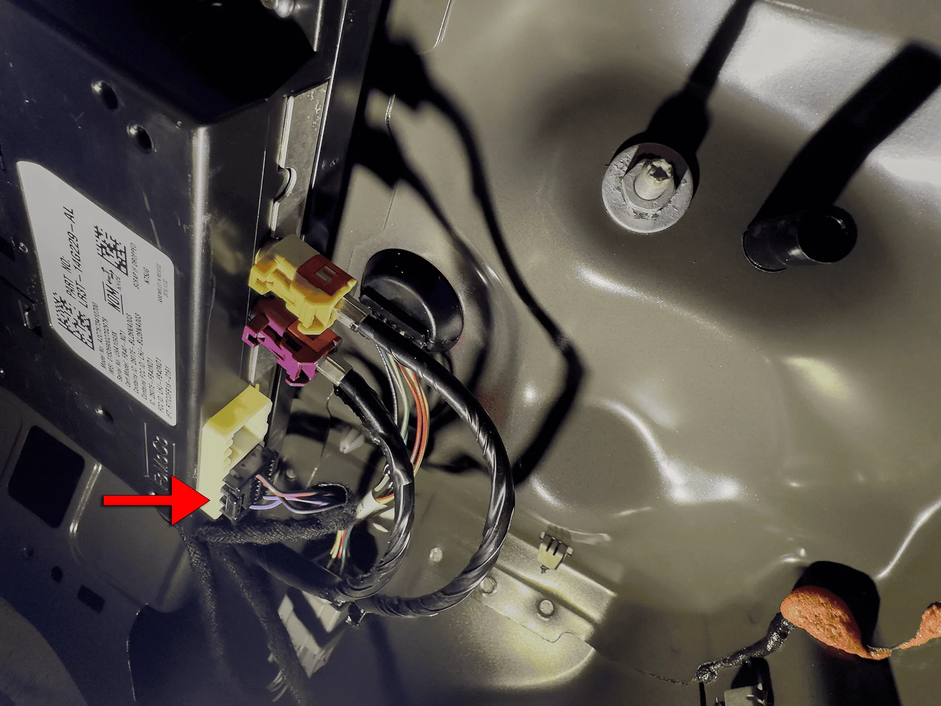

I will pull the power harness today or tomorrow and letcha know.
Boy, do I EVER feel like the biggest dumbass in the world! <laughing at my stupidity>
So, I pulled the power harness on the TCU which I presume is this connector..
Thinking for SURE this would solve the problem, I pulled up the wifi page on the phone and sh_t, f_ck, DAMN, the "SYNC9a" SSID was STILL THERE!
Grabbed a Dos Equis to ponder the situation and perhaps it was the beer that gave me the idea..MAYBE it's the F250's TCU which was parked next to Sarah in the garage? Grabbed the key and moved the truck a couple hundred feet from the garage then, checked the phone again.
Good thought about the SD's TCU perhaps but, that wasn't it.
Grabbed another brew and put on my thinking cap and asked myself, what could be generating that wireless network signal?!
After a few minutes of cogitation, my feeble brain FINALLY came up with the correct answer and OMG did I feel dumber than dirt.
The culprit was the Carlin Bluetooth adapter that is plugged into the USB port in the console!!! When I pulled that, the SYNC9A SSID disappeared immediately. <20-ton DUH!>
Finally, after learning the details regarding what the auto companies are doing with our driving data, I am definitely going to attempt to kill comms in the SD and the wife's CT6 and I'm SURE that our increased rates are due to the spirited driving I did before pulling the fuse back during The Germ.
BUT, I thought these gizmos ONLY used Bluetooth so I didn't consider the adapter as the cause for the SYNC9A SSID from the getgo. But, as it turns out, I found this:
"just a clarification... wireless carplay uses bluetooth INITIALLY to connect the phone to the car (or adapter) and then WIFI once the connection is made. the car/adapter provides its own wifi network for that communication."
BINGO and THAT explains why the audio quality is a LOT better with the adapter than with just the phone connected via BT.
PLUS (and what caused me to go the wrong direction with troubleshooting) is, the "SYNC" part of SYNC9A. I mean what are the odds that an adapter company would use the word "sync" in their SSID AND, I was in a Ford vehicle where "SYNC" is associated with FordPass?! Talk about a coincidence, geeze.
Therefive, my apologies for starting this wild, wifi SSID goose chase. Bottom line is and, as far as I can tell, if all you do is pull the #8 breaker, there's no way the car can talk to Ford or anyone else.
