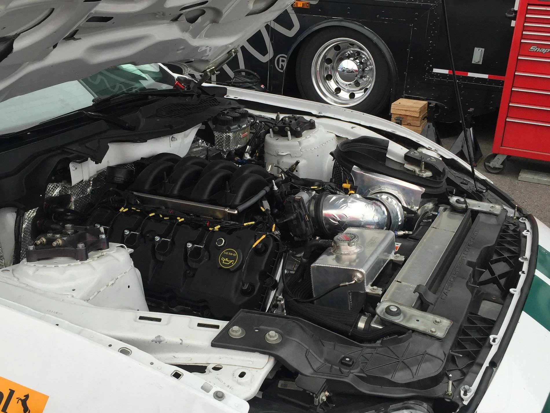

Any idea what the IMSA GT4 cars are using...? Running in all climates for 2+ hours must see their fair share of Heat..

Any idea what the IMSA GT4 cars are using...? Running in all climates for 2+ hours must see their fair share of Heat...
100%, this is the type of rad we need to be running. That looks to be a 4-core to me, but I don't know who manufacturers it. Since it's manufactured specifically for racing, you can bet someone wants at least 5x what it's worth.
It's worth noting that a GT4 car probably has less power than a lot of people here. The exact number will move around with the BoP regulations, but it will be somewhere around 450HP.

I can ask my friend with his gt4 NOT DETUNE with 585whp.
Pretty sure there is not a lot in front of that radiator.
If you pile intercooler oil cooler (280f) trans cooler etc. The radiator will get lots of heat from the cooler in front.
