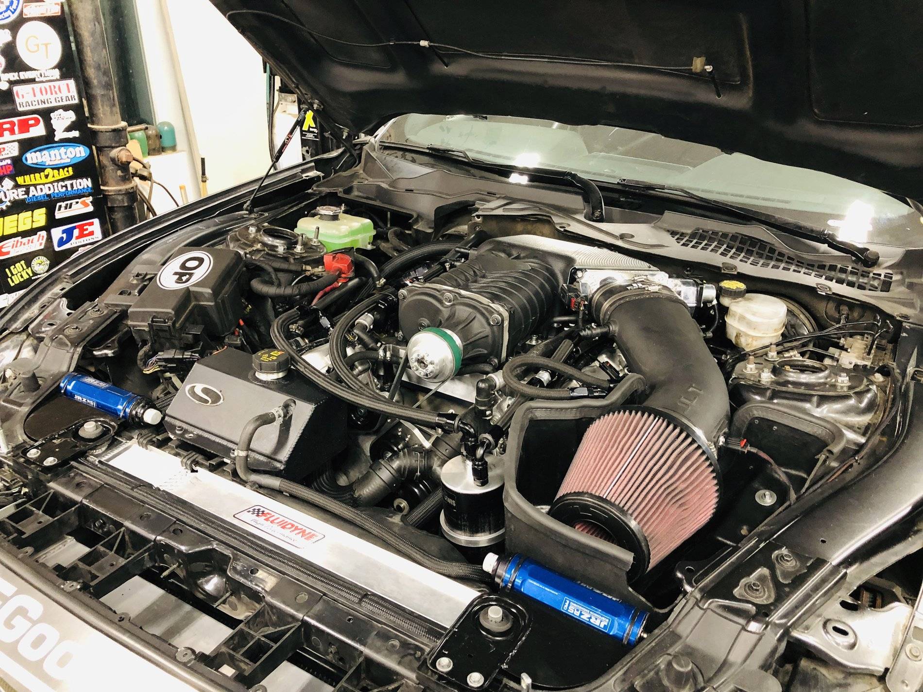

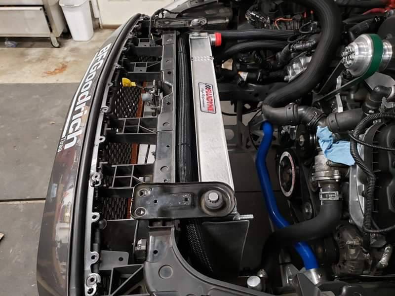

100% this. Case in point: Fluidyne. Their proprietary tech is all in air fin and tube design (in tandem with an oversized 3" 3-pass core). FWIW, I never have coolant/CHT issues with their radiator (combined with full fencing), even in less-than-ideal conditions running 15 minute sessions @ 5000ft+ w/ 750rwhp in 90+ degree temps - despite having a 1000cu inch s/c heat exchanger and setrab 650/610 oil/tranny coolers stacked in front. Highest CHTs observed always in the 210-220 range.
any mods needed to support that radiator? You removed the fan or it doesn't support one?
sorry, that was a mock up pic from the offseason - OEM fan is mounted, no extra fab needed to make that happen.

@boardkat who made that 1000cu inch s/c heat exchanger?
this is an early production triple titanic heat exchanger made by the department of boost. in tandem with the 26A water pump and -20AN lines used throughout (including manifold inlet/outlet), the cooling system flows ~28gpm and keeps IATs much lower than anything else available in the market.
I can't find the eye bulge emoji - but very good
I tried installing the Whipple oversized H/E but I could never get all the pieces.

'15 GT
until you upgrade all inlets/outlets (on the radiator, h/e, pump), your flow will be restricted by the smallest bottleneck (most likely the 5/8" inlet/outlet on the manifold, although these can be upgraded to 7/8" on the Roush iirc)
DOB has done analysis on flow with various components, both restrictive or not; find your combination under the "Intercooler Water Pump Flow Charts" section here: https://www.departmentofboost.com/tech/
my guess is you're seeing ~5gpm with your setup (assumed Roush from your sig), which will sideline you on the track pretty quick driving the car hard at any level of boost :frown:
good news is you can easily double that by using the same h/e and pump as me, or triple/quadruple flow if you upgrade the manifold inlet/outlet to 7/8" and lines/fittings to -16AN (3x) or -20AN (4x). there's also a smaller, single pass version of the h/e that was just released with a lower footprint/price; for most people, this is "good enough", and leap years better than OOTB Roush/VMP/Whipple cooling setups.
if you have more questions, PM me and i'll put you in touch with them.

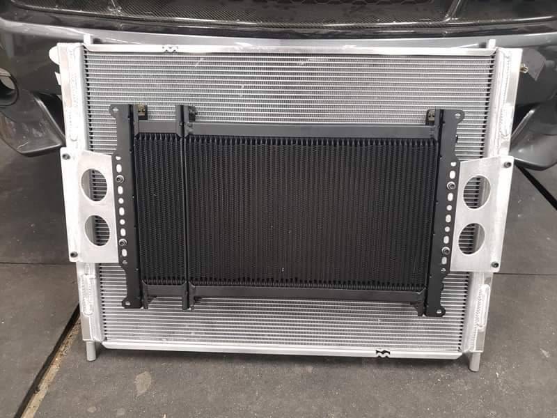

Having a turbo v8 car I’ve looked into getting a shorter radiator to free up some space.
currently running the mishimoto. But I’ve considered running the chase bays 240sx tucked radiator due to it having the same inlet and outlet locations.
it’s measurements are very similar to an ecoboost height and it also is a 3” thick radiator. Yes it would take some custom work but it’s cooling capacity is much higher overall than the ecoboost options.
