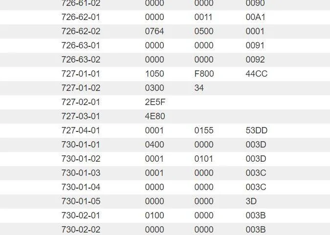

I just did my 2015 4 to 8" upgrade.Many thanks to those who contributed to this thread.The only issue I see so far is a jumpy compass in the center display.I did do the Forscan changes...Going to go for a ride to see how it goes.
p6cl
Dec 4, 2017
307
135
Near Cleveland OH
Ray
2016 Ford Mustang GT Convertible
Look in the 7D0-07-01 lines deal with the gps and tire size stuff. This is from a 2016 Mustang
7D0-07-01 1000 3300 0022
7D0-07-02 0000 0B65 0050
7D0-07-03 0056 566E 00FB
7D0-07-04 4C2E
