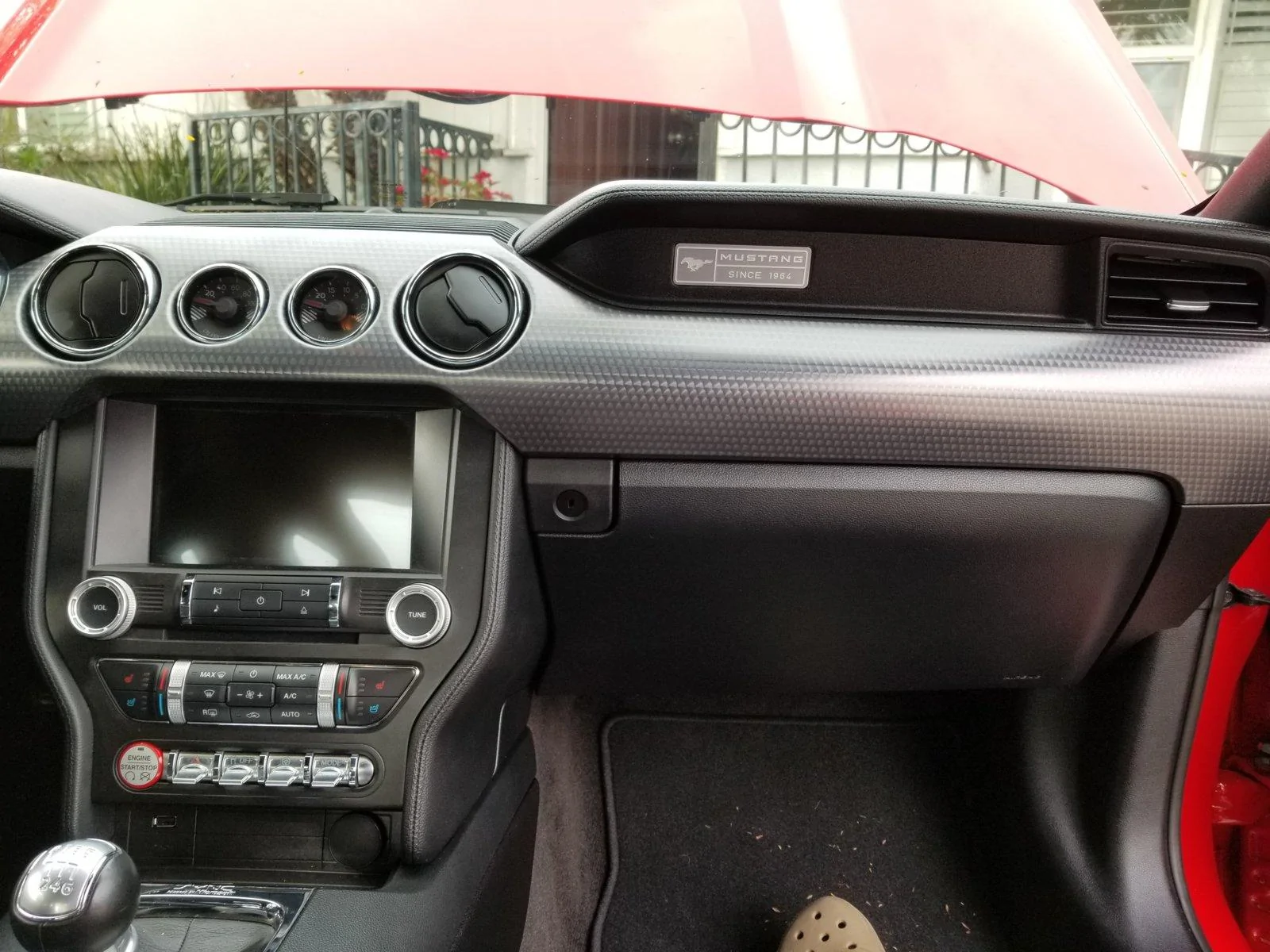

Big thank you to Thomas and Chris from HarnessbyHextall!
They provided:
1. The conversion harness from base to Sync 3
2. Took in my trade in GT350 premium bezel for the appropriate GT premium bezel
3. Tech support with Forscan even after I royally messed up programming on my end.
Now I have Sync 3 with Android Auto/Apple CarPlay and I have the drive modes function on my base 2015 GT PP!
I can not recommend them enough!
