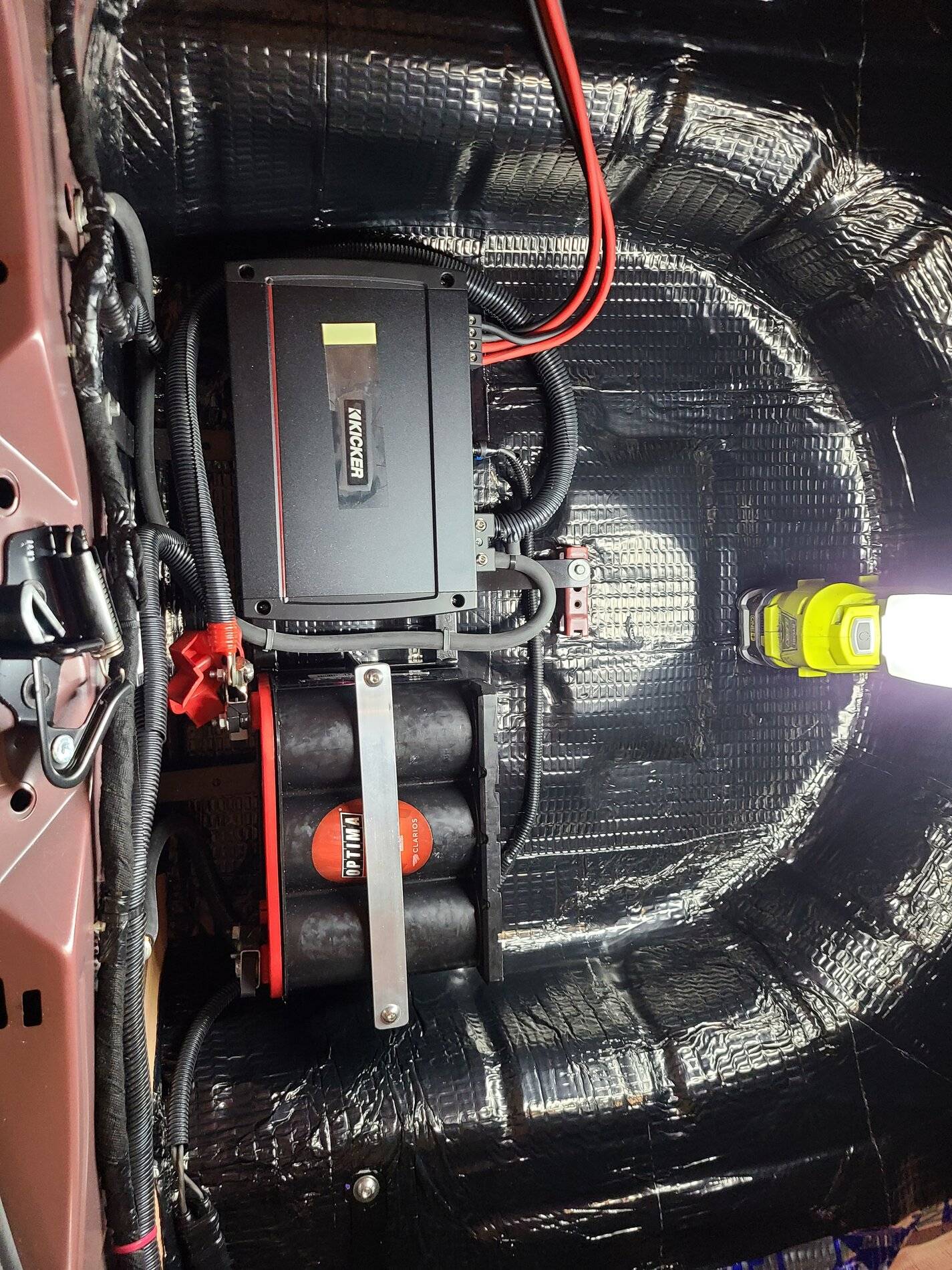

My amp sits right next to battery in the trunk(relocated) and is fed by 2/0 like 1/2 thick 2000+ strand ofc that is only 2ft long. Same with ground. Same wire feeds to front for alternator/starter.
Power Wiring is NOT an issue. And my speaker wire is stupid big too.
I was just trying to think of other variables that may of caused an issue if everything else was right is all. Looks like a killer set up.
do you think a car with that much power draw would require a capacitor for harder hits? I’ve never needed one but my systems have never been over 600-700 watts

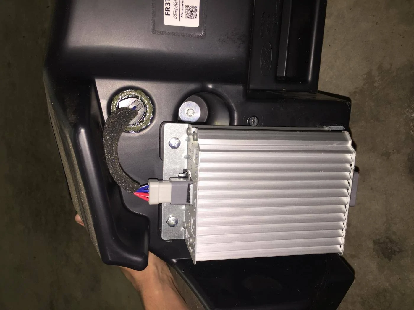

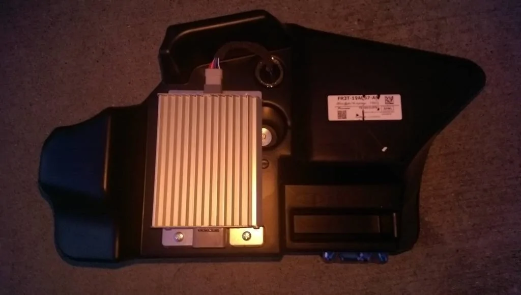

There is no amp in the sub box. The wires going to the sub at the box are from the factory amp. Therefore it’s a high level signal. Some amps can automatically switch between high and low level. Don’t know what to say but it’s definitely a high level signal.

The shaker pro- its high level, and there’s an amp on the back. The shaker pro box. It’s ambicile corded
I don’t know if b&o has an amp back there like this.
Kick panel- wiring harness, into that amp on back of the shaker box. Is the mini amp not on b o box?

I think the confusing part is that typically when we think of high level vs low level, we are thinking "factory radios" that have speaker outputs (high level) and rca outputs (low level). We would normally run the rca outputs to the rca inputs on the aftermarket amplifier and then connect the speaker wires to the the amps output. In this case, the car already has an external amplifier....does that signal running from the amp/dsp subwoofer channel now output a signal with the correct volts to be called a low level input....as that is where the subwoofer wires are coming from.....I guess I will have to take out the old volt meter and measure. If you have done this please save me the time and say yep it's definitely high level.....ie 11 or so volts vs 2 or so volts.
