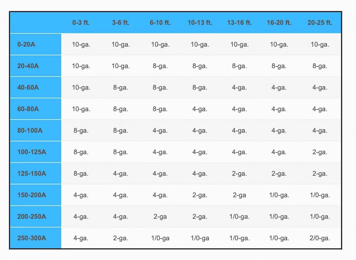

What amp is it, the make/model? if its an mono D amp, then it doesn't need much power. 500 watts isn't anything drastic, 4guage wires can provide that current just fine. but if you are running 8 gauge wiring, then that could be an issue.
https://jlaudio.zendesk.com/hc/en-us/articles/209635477-Selecting-the-Proper-Size-Power-Wire

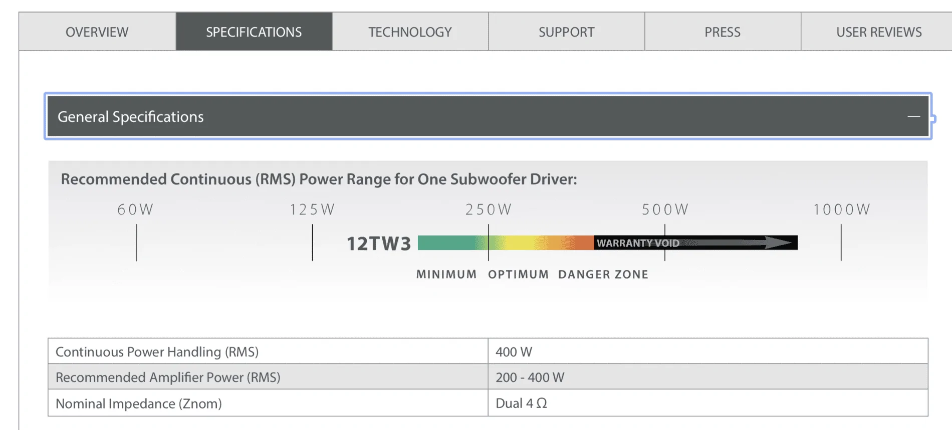

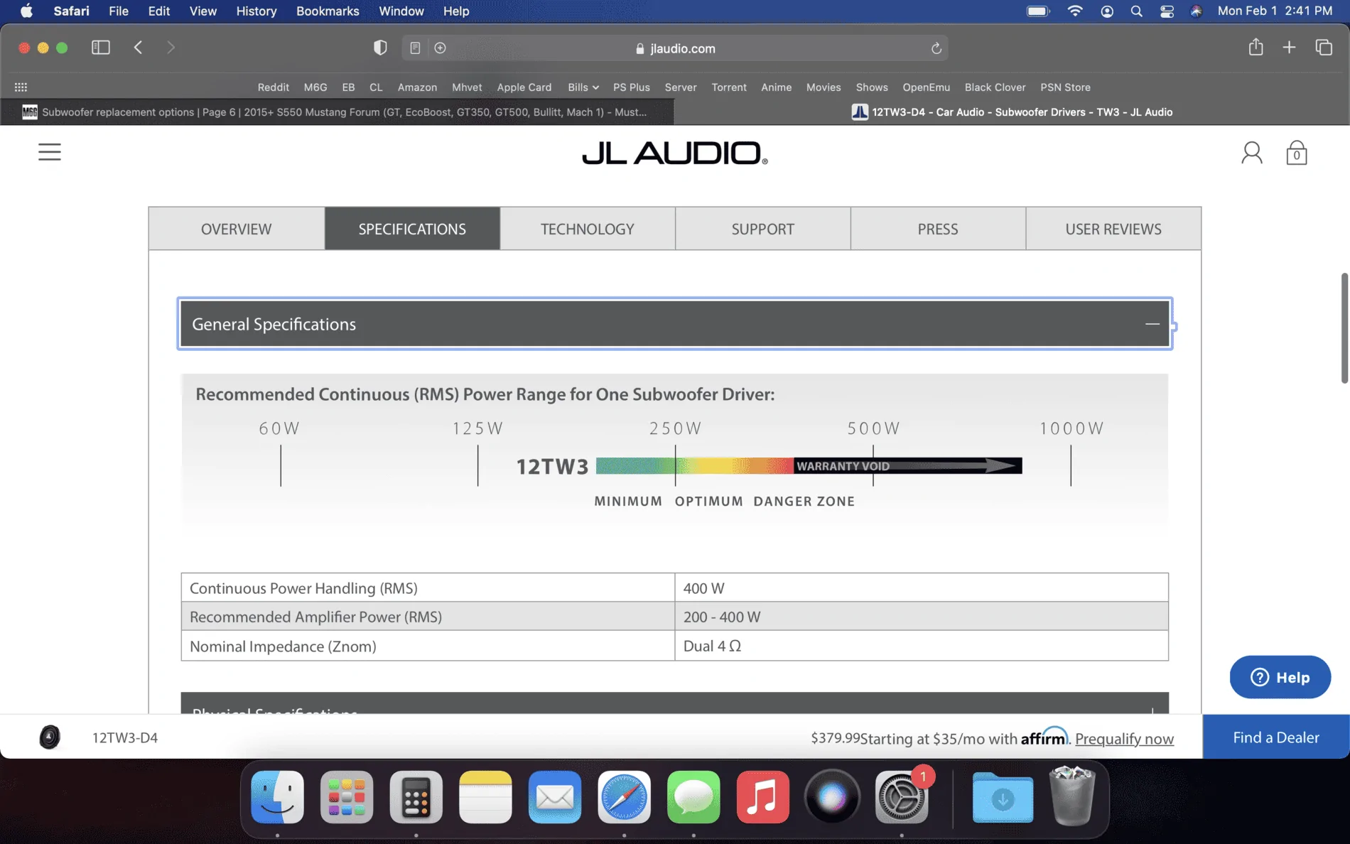

edit if you are using the jl stealth box, you will want to use a DMM to set the volts accordingly. if I really its 350-400 watts RMS for that box, setting the amp to run 500+ watts will toast that little guy.
I would set my target @ 2ohms, 27, 27x27 dividied by 2 ohms, is 364 watts. or25 for 25*25= 625 then divided by 2ohms, = 312 rms at full load. I would aim for 350sh watts rms myself. (in fact I did run 350rms) for the entire duration I had it, then I sold it to next buyer. it performed beautifully

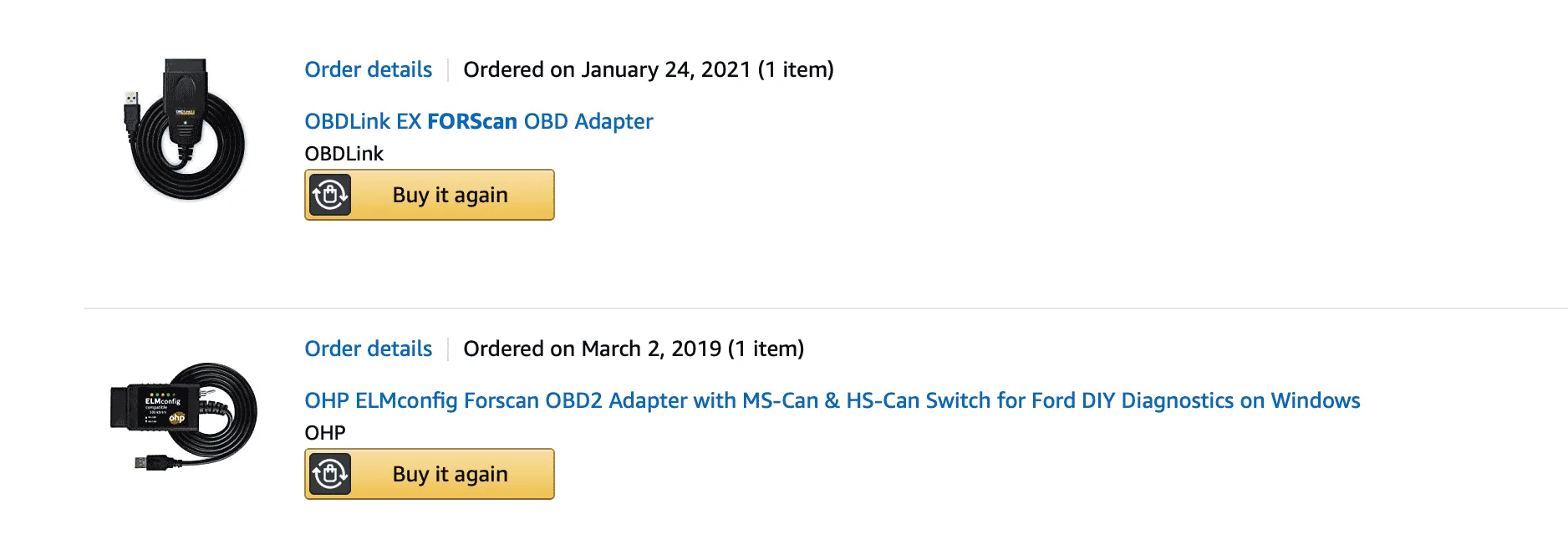

the cheapest fix guys (test), order a cord, download forscan, change 1 code (EQ) you literally change 1 code number, like xxXx from a 1 to a 0 or whatever. you can revert it back in 10 seconds.
and see how that effects your guys sounds. I am betting you guys would love it, but I also recommend retuning it, have the volume super low when testing the sound, on possibility it boosted the sound. it'll need a retune,
but it should give you guys more frequencies.
if you guys was local id do it for you guys for free, its so quick and easy.
there's 2 cords I used, old one was 29 bucks, and I upgraded to that new one 49bucks. because its faster, more reliable for other software stuff. but either would work.
