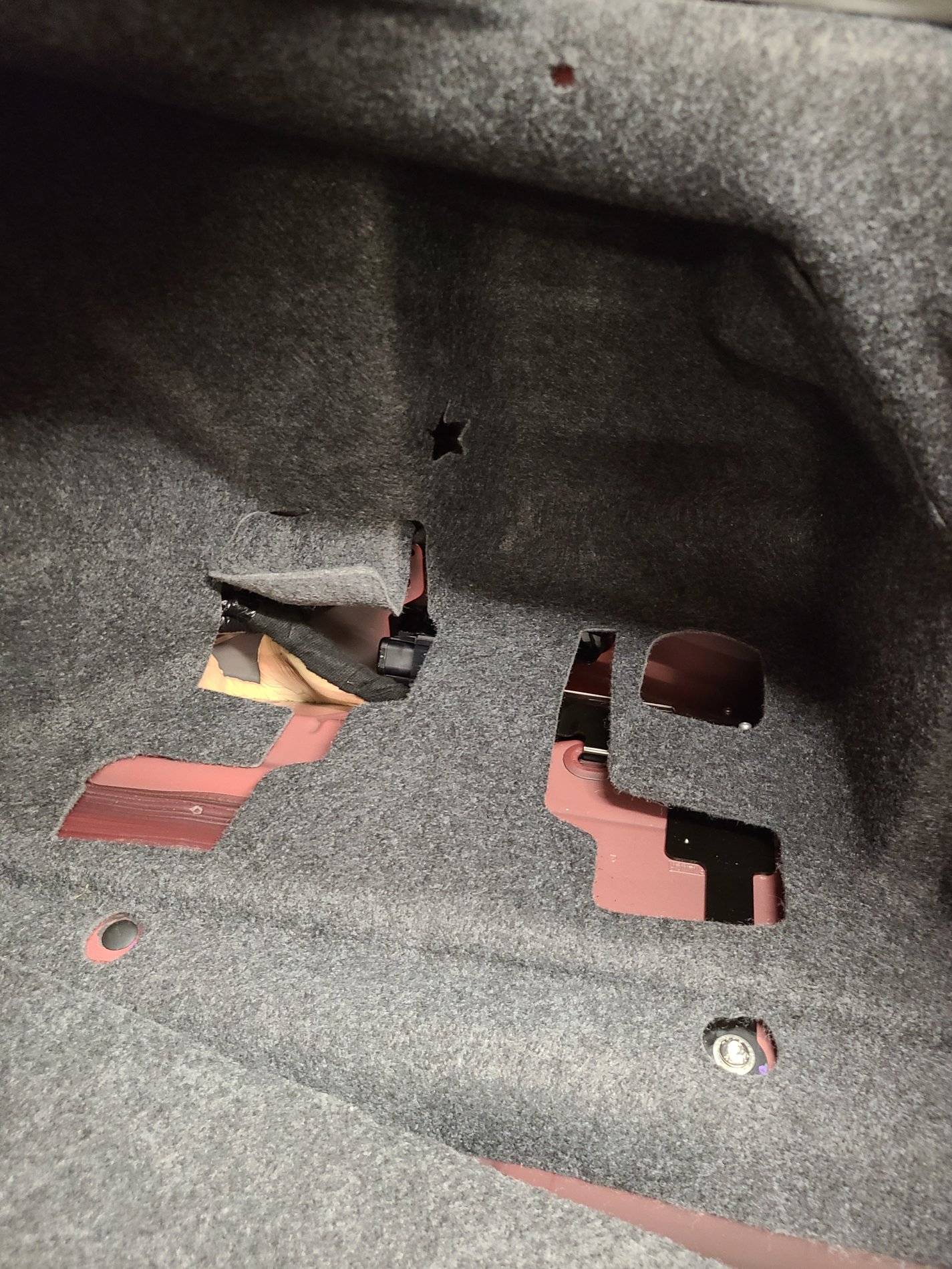

Does anyone happen to have or want to get rid of the passenger side trunk carpet? Without sub option? If i am looking at Ford parts correctly it appears this stupid peice is like $150...... Anyway mine is littered with holes because i have the B&O sub that i will no longer be using and my new subs will not go in that spot....And if anyone is interested I have B&O sub !!
