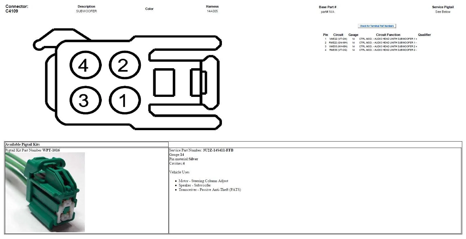

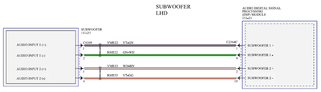

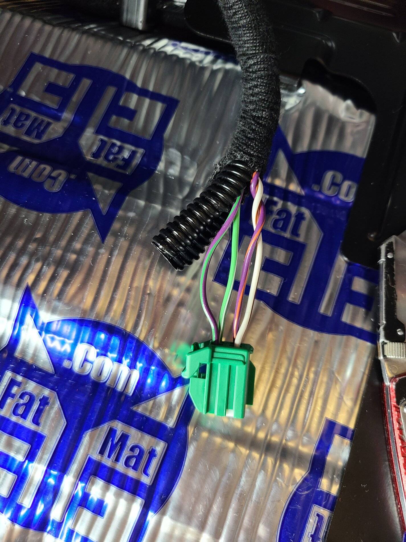

I picked up the signal from the existing wires going into the OEM sub. There are 4 wires as it is a dual voice coil speaker. There is a green and black wire to one side, yellow and purple to the other. I could have used just one side but I combined the green and yellow (both are +) and black and purple (both are -) and ran them to the input on the JL amp.
My wires don't match the colors you stated any thoughts? Is your plug the same?
Snoopy49
Jul 24, 2019
56
4,024
6,051
California
Earl
2013 GT500 - SOLD and 2020 GT500 - SOLD

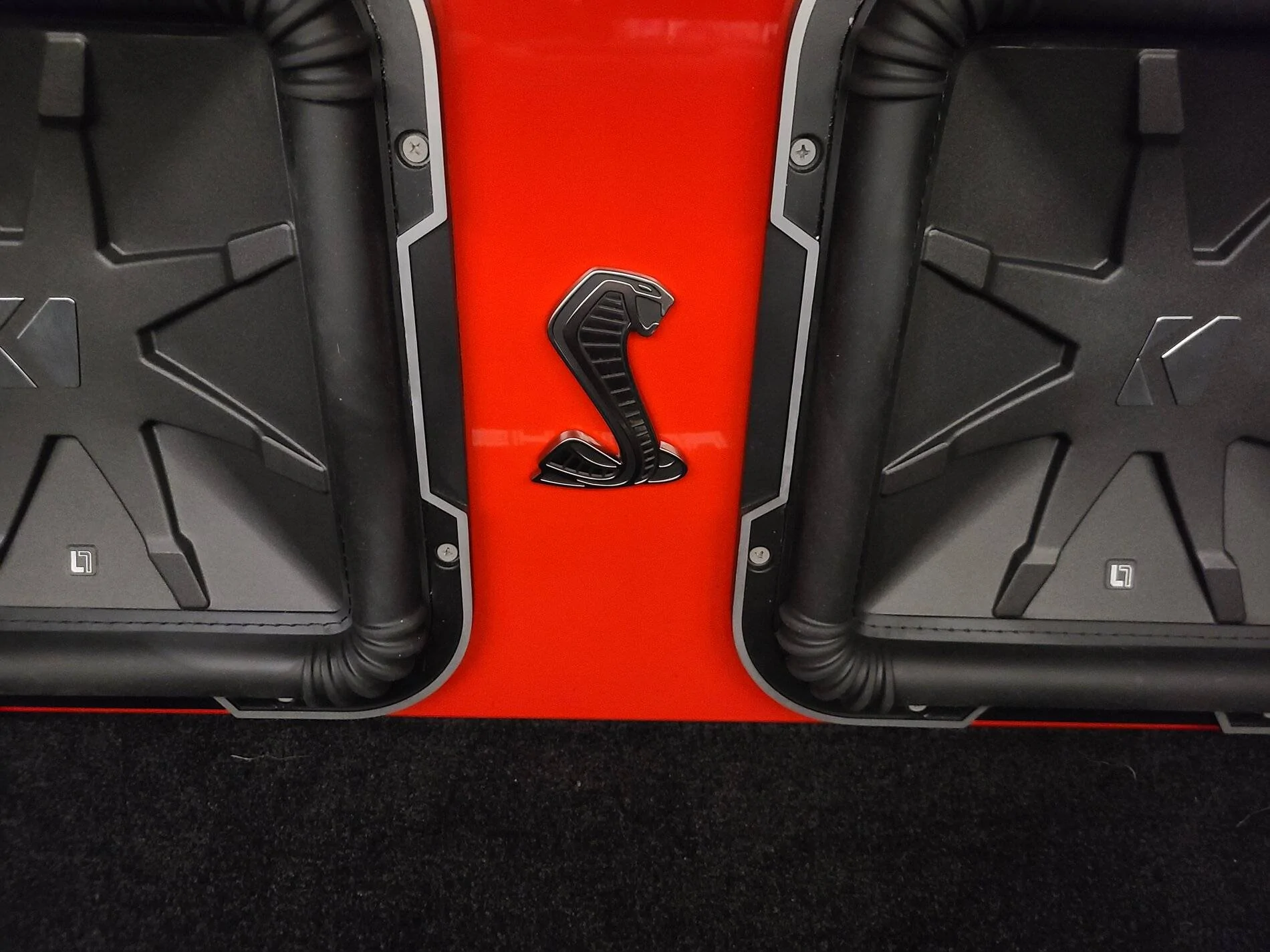

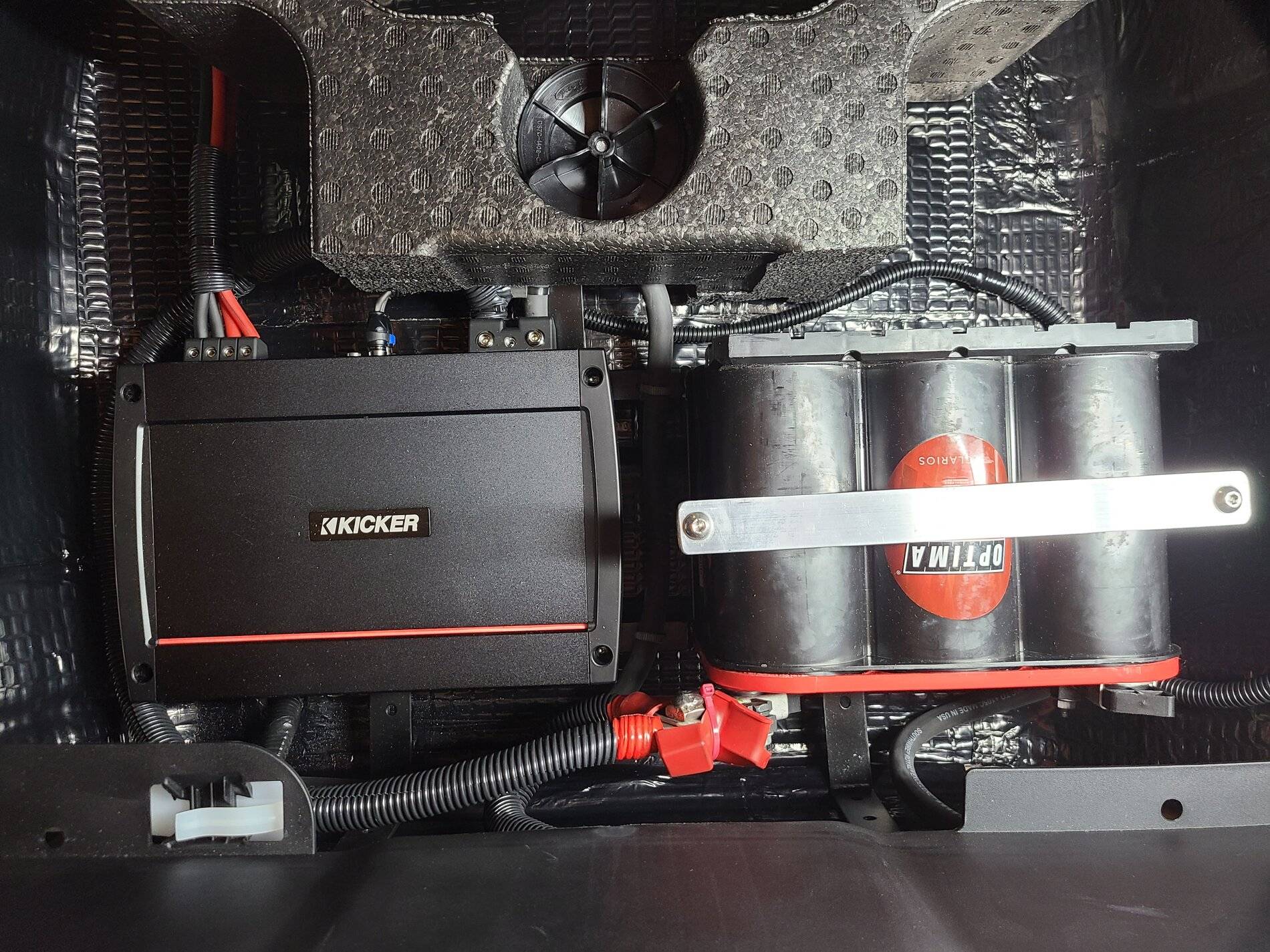

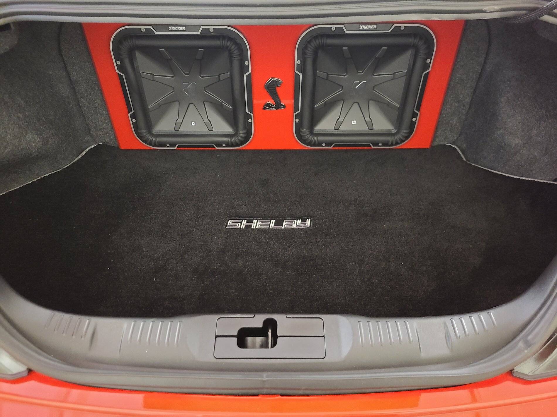

Well i finally got done with my amp and sub install and it turned out pretty nice. TOTALLY overkill and now that i have more bass than i could ever want it just emphasizes how bad the rest of the system is. B & O is definately lacking in volume so the rest of the system is for another day. I can turn down the gain and it appeases me for the moment. I used 2 Kicker Solobaric L7 Q class subs and Kicker 1600.1 amp to power them, along with moving battery to trunk.
