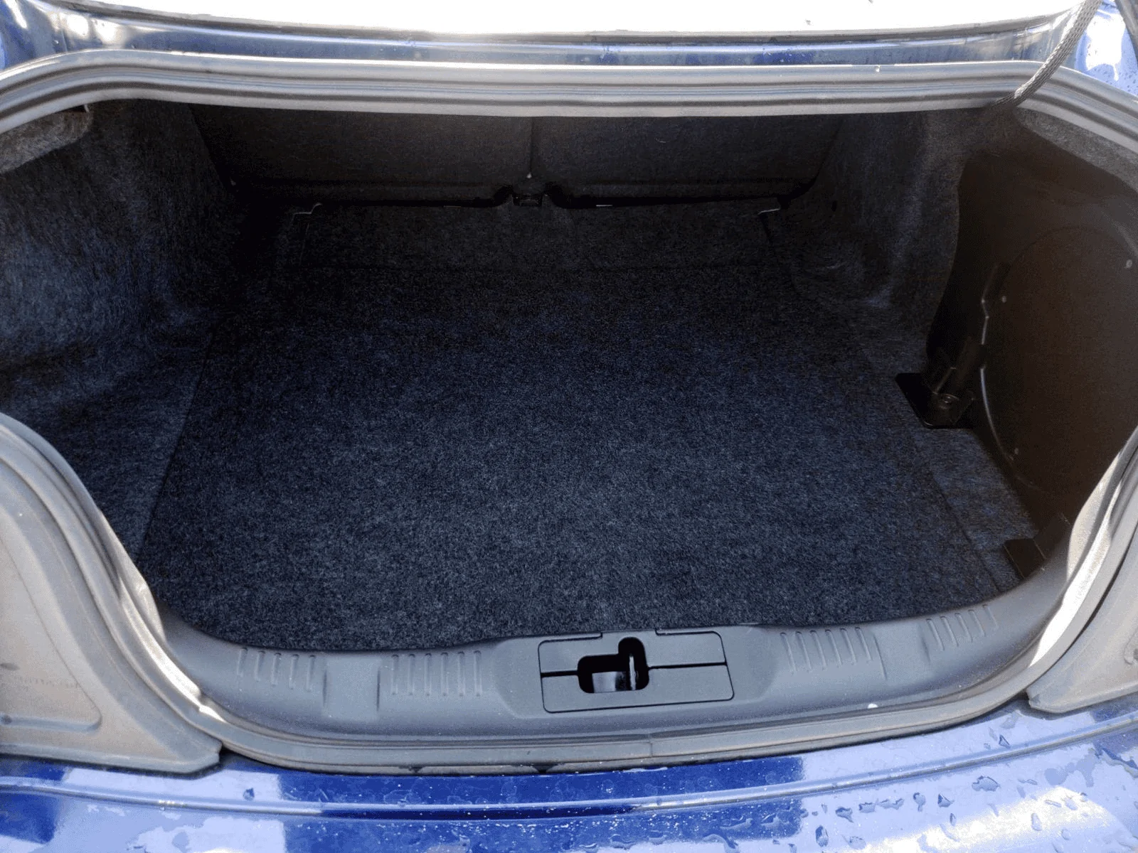

Got a question. Looking at a 2019 and one picture looks wrong.
Is that a after market sub or the factory cover is off?

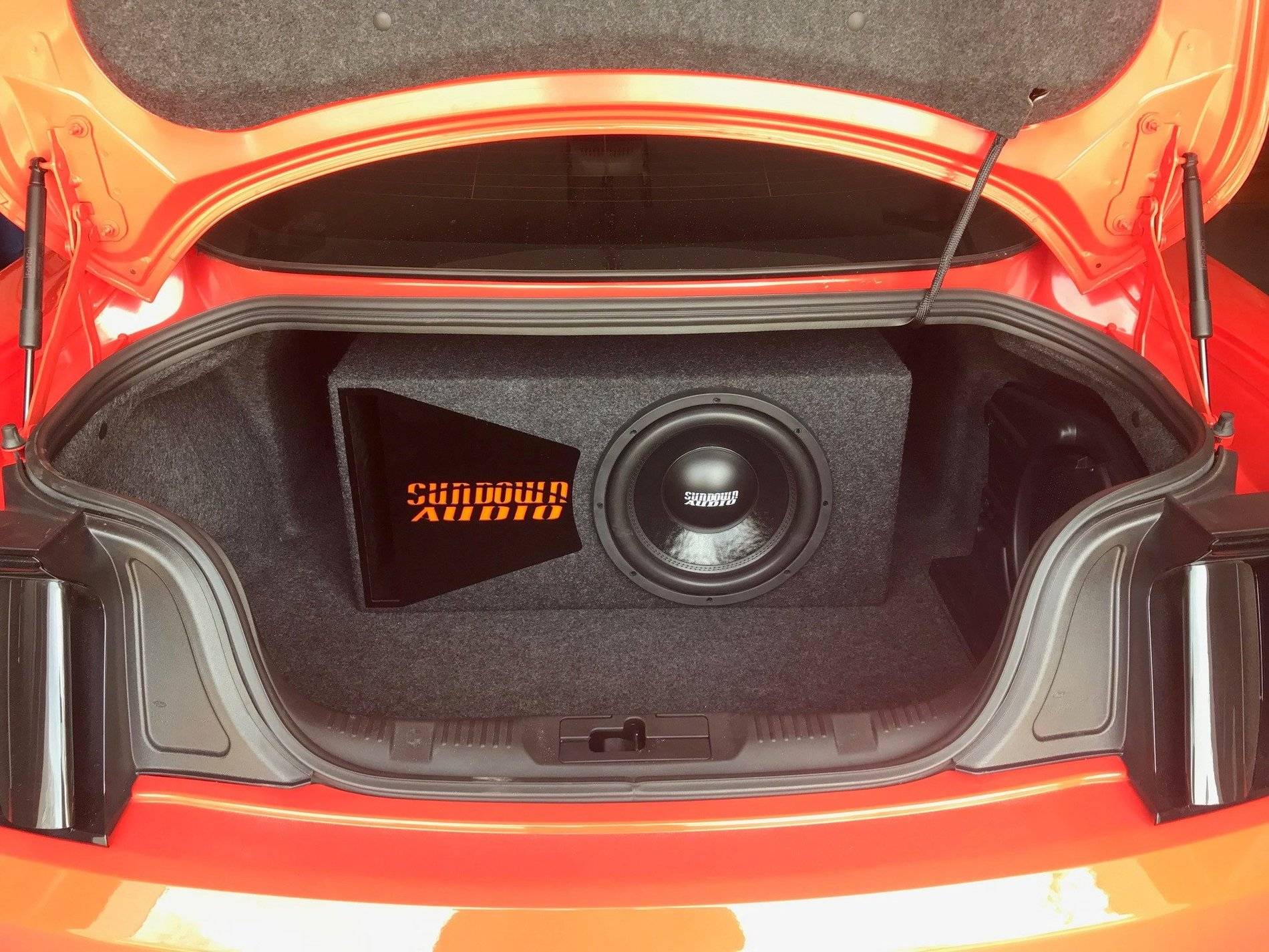

I replaced all the mids with JL Audio C2 Comps in the front and C2 Coaxials in the back. Running them off a 75 x 4 JL Audio amp. 12" Sundown in a box made for it and a JL Audio 1000 mono amp. Both amps tied into an Audio Control LC7i. I don't use the trunk for anything as it is not my daily driver so I don't mind the huge foot print. No Complaints other than I wish I had gone with the C3's like I did in my Truck.

Looks like factory sub OEM to me. No cover

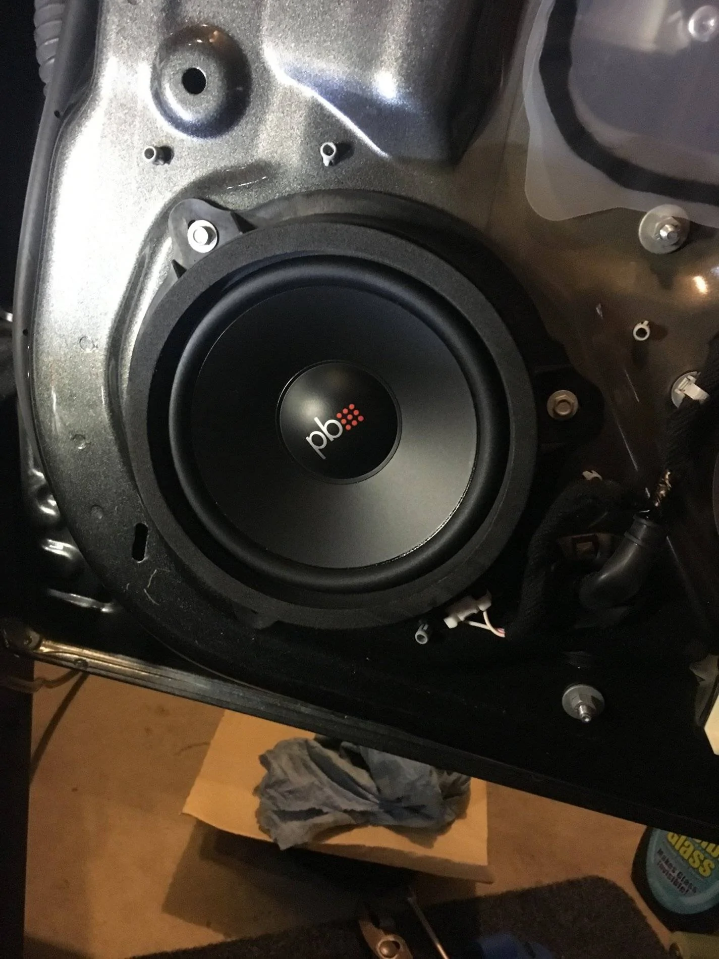

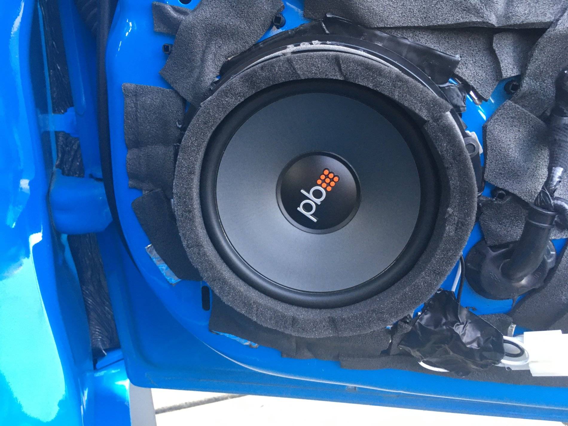

the tweeters are 8ohm, hard to find some with that impedance.
the doors mid are 2ohm, hard to find matching factory impedance.
but the 6.5's are all 2ohm or 4ohm depending on your car, ie. my 9 speaker car had all 4ohm, but the 12 speaker car had all 2ohm, which is twice the output in theory. but I tossed a 12 speaker amp from a 12 speaker amped car, so I decided to toss 2ohm 6.5 replacements in my car.
powerless has 2ohm replacements. if you decided you want to keep 4ohm they have a lot of 4 ohm replacements. but 2ohm much more difficult. mines the blue photo, and another photo off google
Going from 4ohm to 2ohm though in my case, was awesome. seriously, sounds way better. I dont know if you can toss 2ohm replacements on a car with 4ohms assuming the amp is the 9 speaker amp,
id like to say it wouldn't matter what amp it had? let someone else clarify.

Going from 4ohm to 2ohm will definately make a difference in volume but that would be aside from the fact of overall sound quality. I am not sure what ohm I have but i need to see if i can determine. Because i feel in general the overall B&O system is lacking volume.
I was overwhelmed with joy when I tossed the 2ohms in, and I actually used 3 ohm in rear, I wanted some fill, but not as strong as the others. I used GTO629's in rear (I had a single range speaker 4ohm) so I upgraded to 3ohm coaxial to get the 12 speaker experience, sounds good to me though.
oh boy covid has jacked prices ups I got mine for like 60 bucks on amazon, now they are 110.- if you go this route, I highly suggest keeping the little attenuator booster off on the tweeter; I turned them on thinking, more better. nope, way to bright , turned the button off, and sounded way better.

What speaker/model did you use in the door?
just looked to find them, and it appears power bass just dicosntinued them I cannot find them on Crutchfield or powerbass.com

I found this on their discontinued section
2ohm. 7 inch, slightly larger than our 6.5
https://powerbassusa.com/us/en/products/closeouts/L2-700-7-full-range/
think these would work?
https://www.amazon.com/Powerbass-L2-700-Midrange-Speakers-2Ω/dp/B00EYR4AJM
edit. found em- discontinued. I bought mine open box from Crutchfield for like 70 bucks, I didnt use the crossover or anything. just tossed them straight in. powerbass said there would be no issues and havnt had any, didnt use tweeters as they are 2ohm too, no way would I touch those in replacement of 8 ohm, 4x louder. but would be fine if I used crossover which I didnt, too much effort lol
