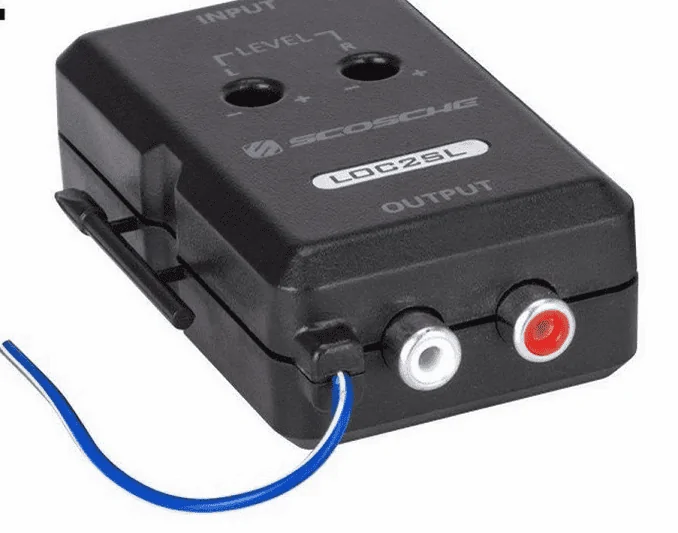

If i connect remote wire from line out converter to trunk's 12v turn on lead, will it be on all the time? or will my amp turn off when the car is off?
Your LOC should have a 12v remote in and a 12v out, if your LOC is off when the car is off the amplifier will be off as well. (The LOC comes on when you start the car and shuts off when you open the door after you turn it off?)
I just connect remote wire from the amp to the blue/white wire right? but the amp will always be on?
Yes, remote in on the amp to this wire. Looking at that LOC, its 12v input is the yellow wire on the opposite side.

Should I use this to tap in the cigarette lighter fuse on the engine bay? So the amp turns off when the car is off?
I just connect the remote wire to the blue crimp right?

I do not recommend tapping into the cigarette lighter. The trunk is the best spot as been said above and many times in this thread. I tapped in the trunk to DSP and Two amps.

There should be a blue remote wire in the harness going to the rear deck speakers. If you don't have rear deck speakers you can fuse tap but make sure you choose the right fuse, they are different depending on the year of the car. That is what I did for my remote amp turn on, ran a wire from the passenger kick panel fuse box to the rear and that turns 3 amplifiers on. You only need a small fuse for that lead too, its just a 12v signal on not a current draw line. This should help - https://fuse-box.info/ford/ford-mustang-2015-2019-fuses-and-relay
