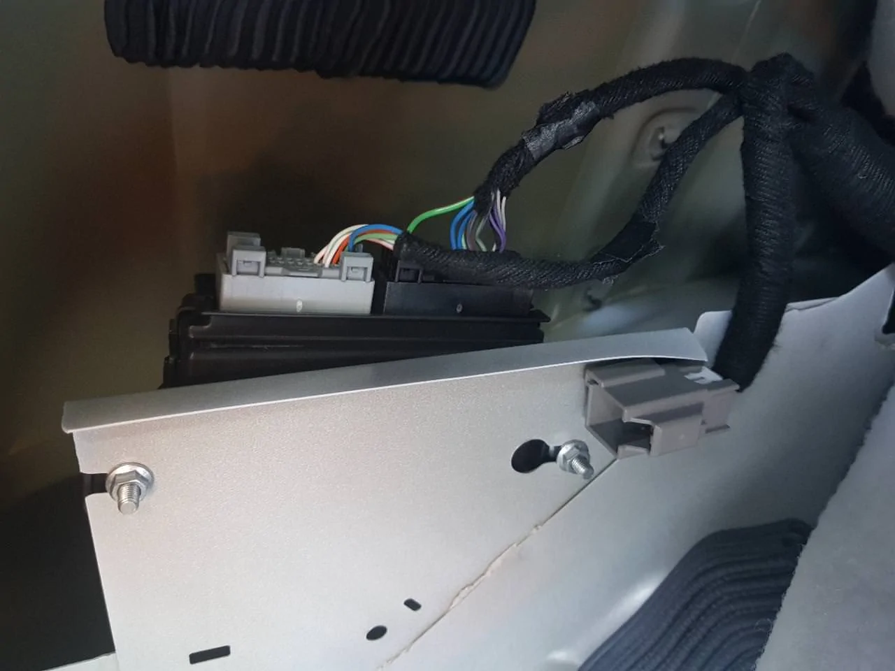

Does any one know what this empty plug is for? I have a European 9 speaker shaker system with no shaker sup in the boot.

What color are the wires? If they are violet, grey, green and white it’s one of the ELT diagnostic connectors. Used at Flat Rock before the car leaves to test the CAN Bus and then never used again.

Can some one with a shaker sub post pic of the connector please.
