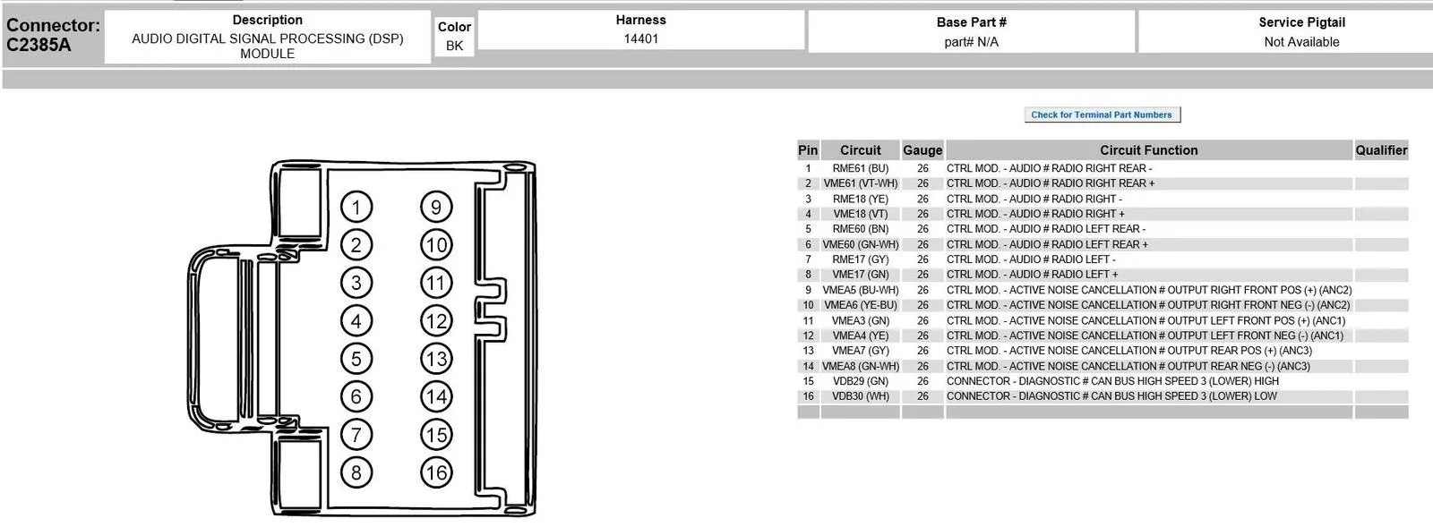

I believe there is a fairly easy way to add the additional pin-outs to the shaker amp wiring harness in the front kick panel to extract the signal for my aftermarket amp. it appears that while ford has different wiring harnesses for the different shaker options, the front amp is the same and therefore so is the Molex connector that plugs in.
from the image shown pulled from a comment of another member "Grumblin".
On harness 14A005, pins 1,2,3,9 are clearly the amp signal +-, power, and remote wire. Problem is non shaker systems don't have any wires connected to those pins. The pins however are available on Amazon for 6 bucks for 50.
this seams like the preferred method for getting an amp signal without degrading the line out voltage to the speakers

DSP 783-01-01 Xxxx-xx 1=401A 6V turn on enabled 0=400A 6V Turn on disabled (thanks to [MENTION=30920]djcwardog[/MENTION] for the confirmation)
That last line is what interests me. The DSP for a 401A car needs to be told to send 6V via pin 9 to the sub-woofer amplifier in the trunk. It is possible that this also enables the DSP and ACM to communicate over the HS3 CAN bus. This is most likely why the addition of the 401A ACM enabled the sub-woofer output.
To take this a step farther I asked a colleague to see what was in his 16 GT 401A car (NON-NAV). His DSP module is engineering number FR3T-18T806-BR. I then went to Car Part Pro and using the same info as his car found pictures of 12 speaker Shaker DSPs and both of them had that same engineering number. I then went and used his VIN at fordparts.com and based on that VIN found that the part number for the 401A DSP is FR3Z-18B849-M. So taking this a step further I think I may order one of the BR suffixed DSPs and see if it will work with my bench top setup that i use to program ACM and APIMs and see if the base ACM removed from my 2017 will allow subwoofer out.
If this is the case then you can use [MENTION=32841]Benwilj[/MENTION] 's idea above and make a harness that uses an RCA cable with one of the Phono connectors cut off. You would take the positive and negative wire and add 1393366-1 pins and then put the positive in cavity 1, the negative in cavity 2 and if the RCA has shielding the shield would go in pin 3. You would then also add the 6V turn on in cavity 9 or use the 12V turn on in the trunk.
