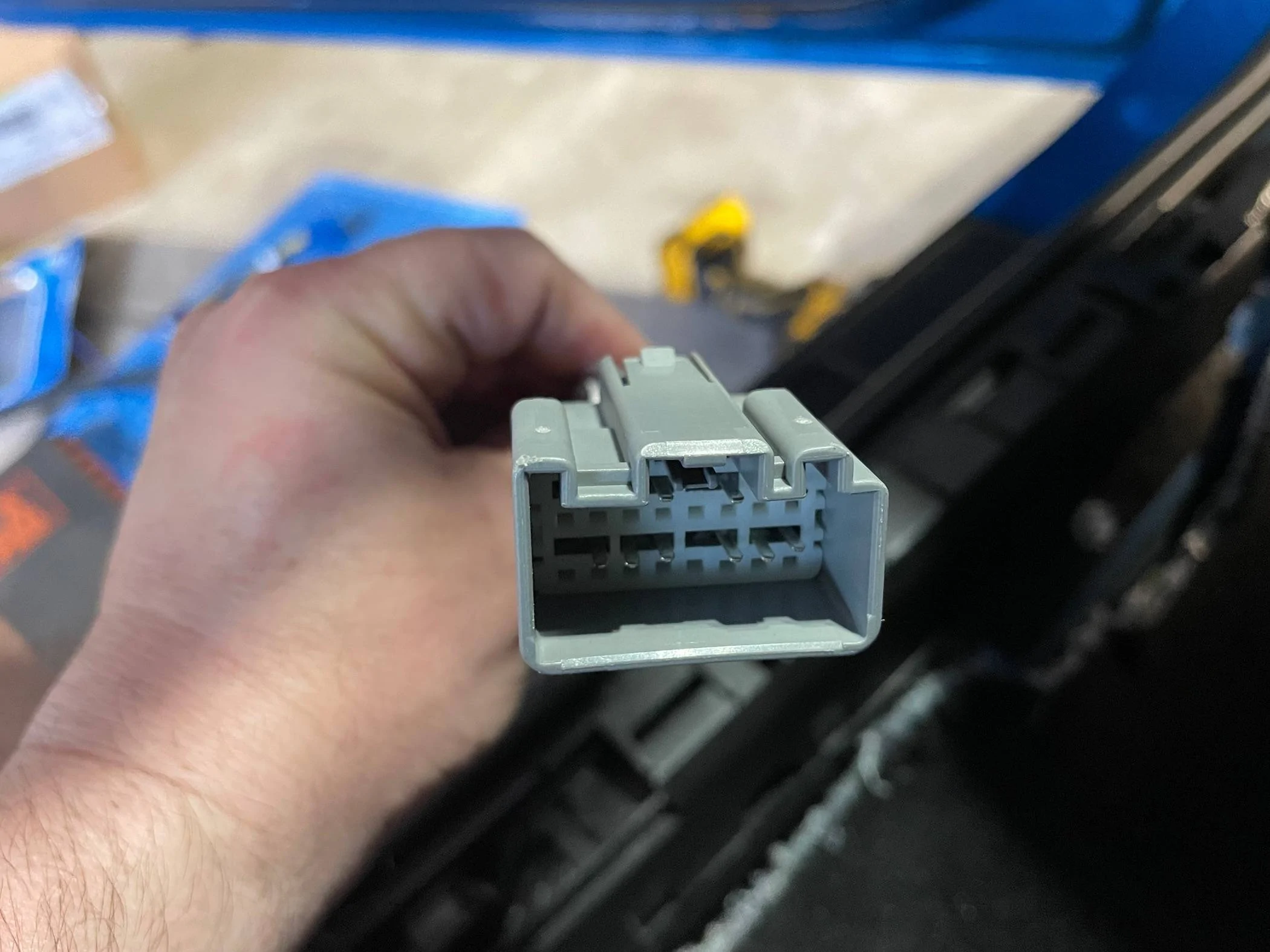

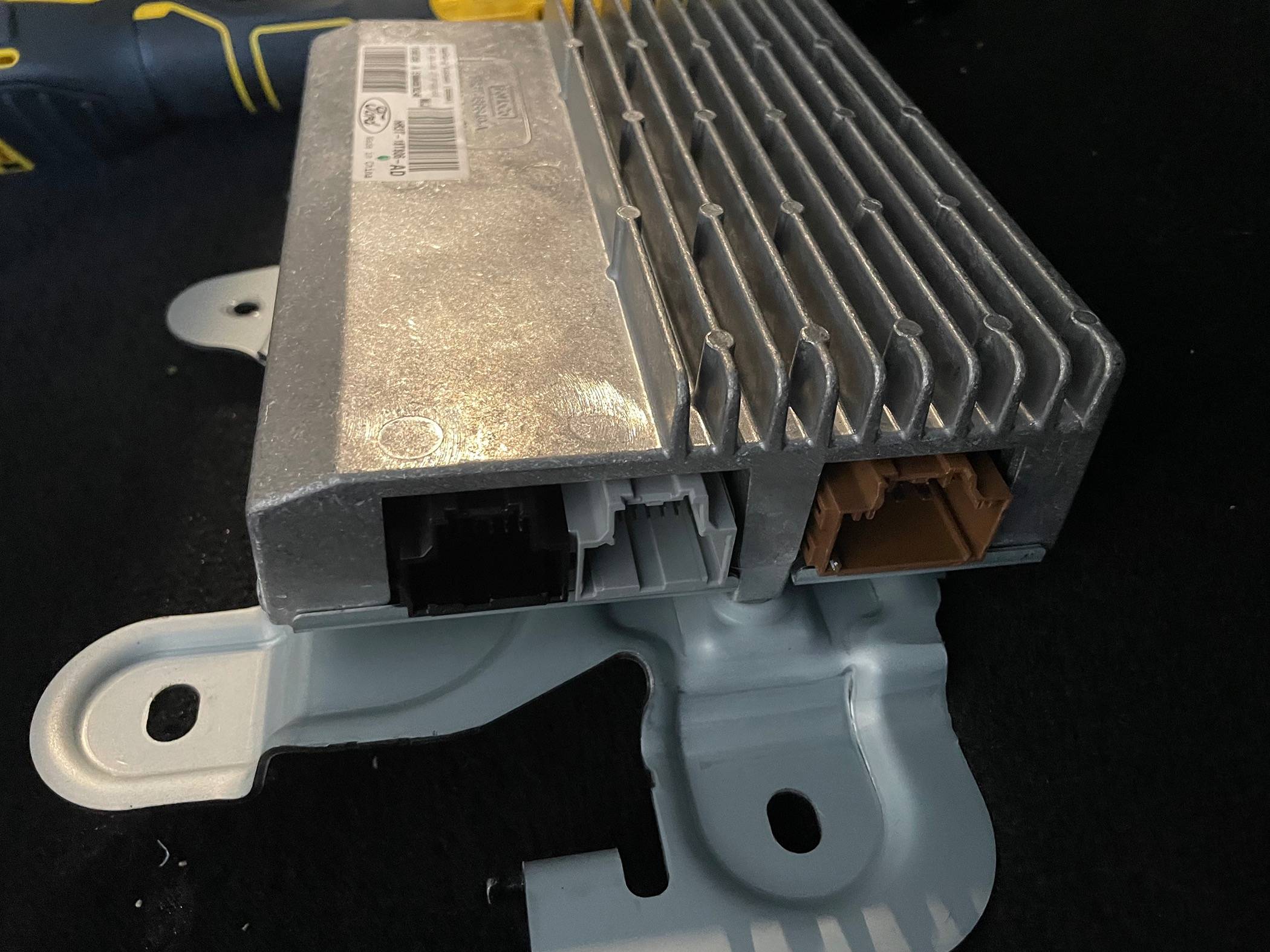

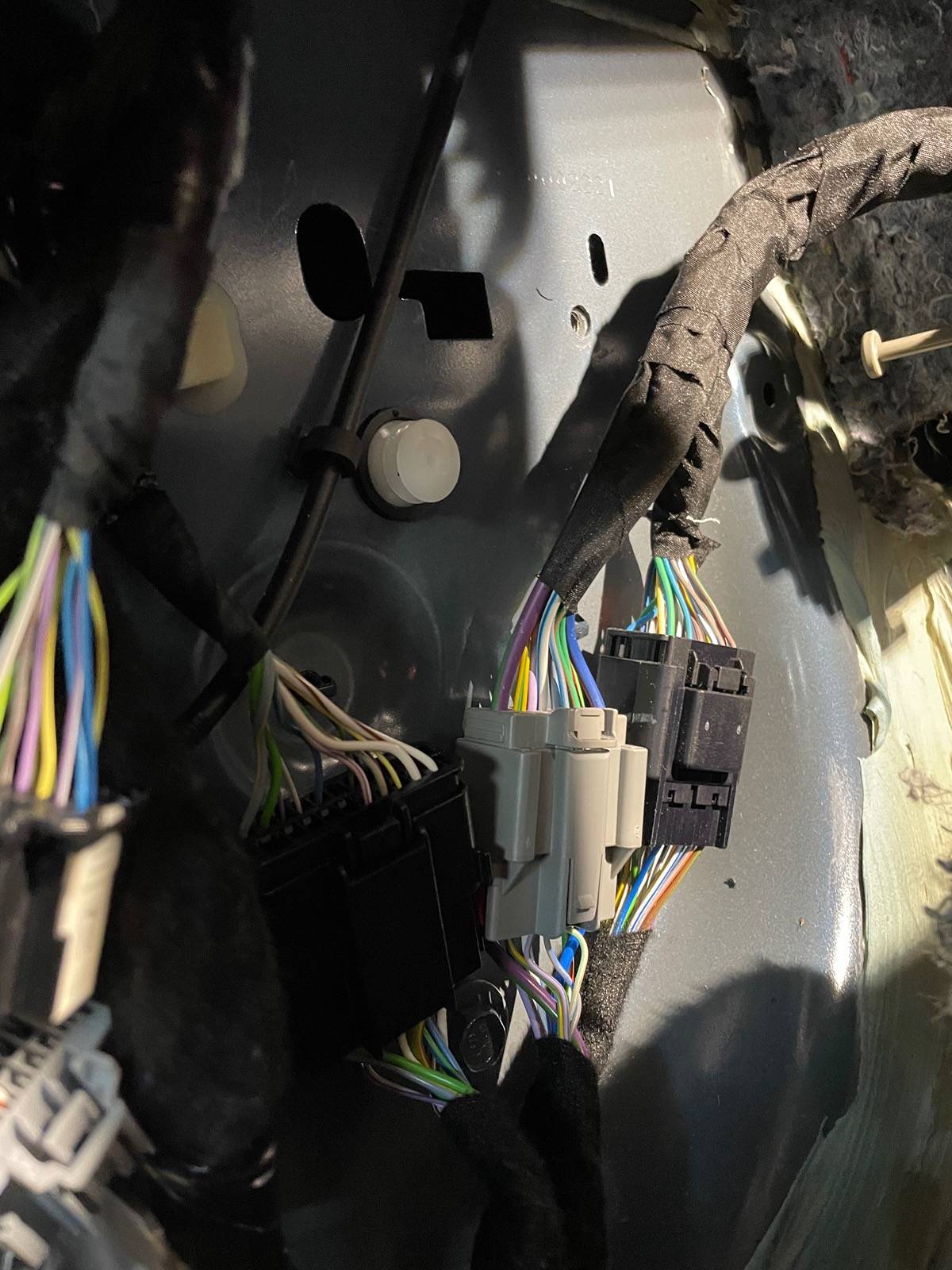

Ok I’m about to pull my F$*#ING hair out here 🤣🤣🤣
First off let me say there is a wealth of information here on this forum and it has taking me a long way. In the process of doing an overhaul of the stock system in my 2021 Mach 1 which is just the base 9 speaker system. Everything is going smooth up until today when I am wiring in the tweeters and about to hook up the ADH-FP01.
Where on god’s green earth does this connector get plugged into? It doesn’t fit anything from the amp or right below it. I’m starting to think I have the wrong connector. I’ve been at this part entirely way too long! I even removed the amp thinking I was missing something.
Any help is greatly appreciated!
