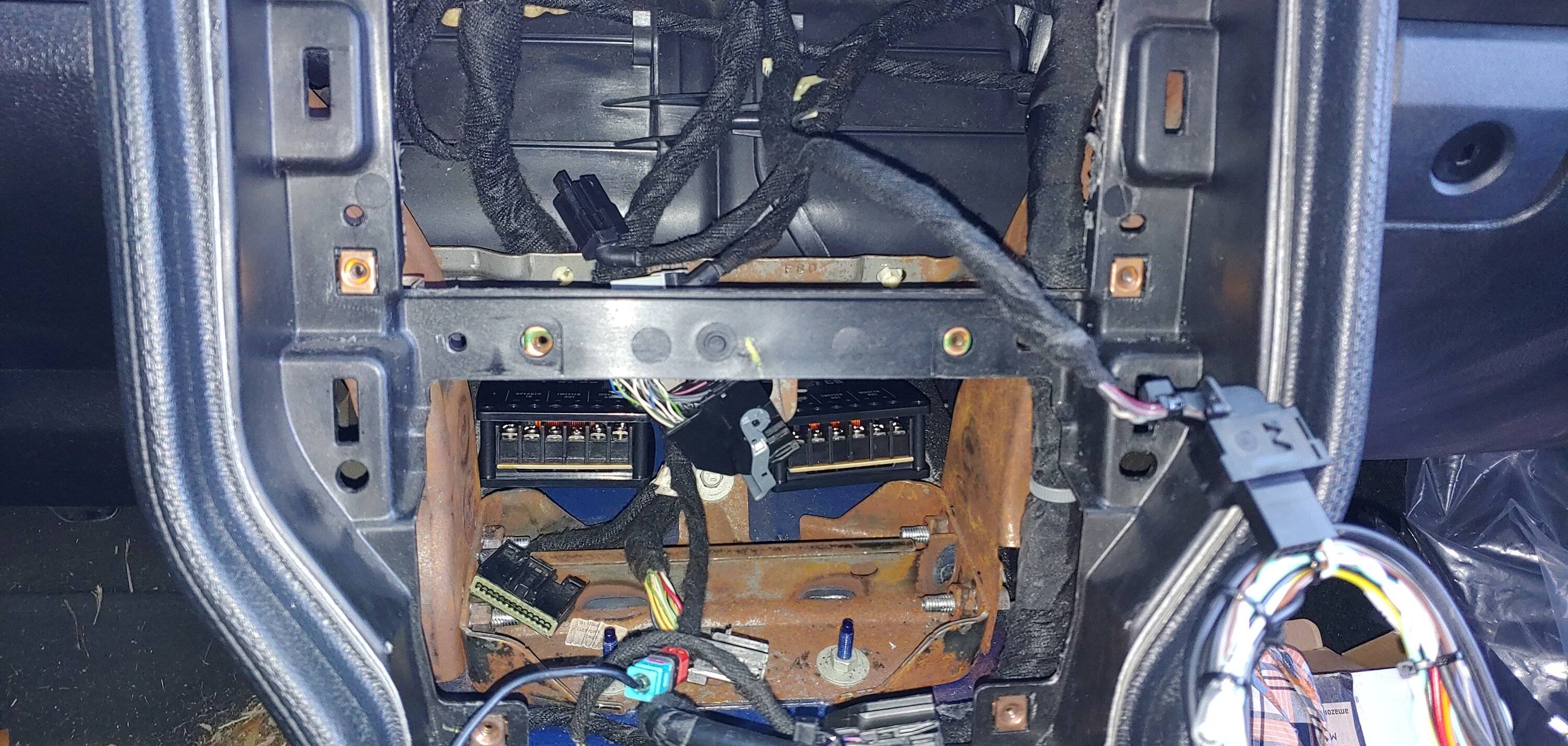

Any ideas on where to mount external crossovers? With the 6-speaker system (2-way front components), behind the kick panels are a no-go. Too many harnesses and a fuse box on the passenger side, and the hood release on the drivers side.
Unfortunately I don't have the 3-way wiring behind the door panels so I can't use that.
There seems to be a bit of room behind the dash/under the head unit if I can move the scosche module far enough out of the way, but I still have RCA's and remote wire to run for a sub amp.

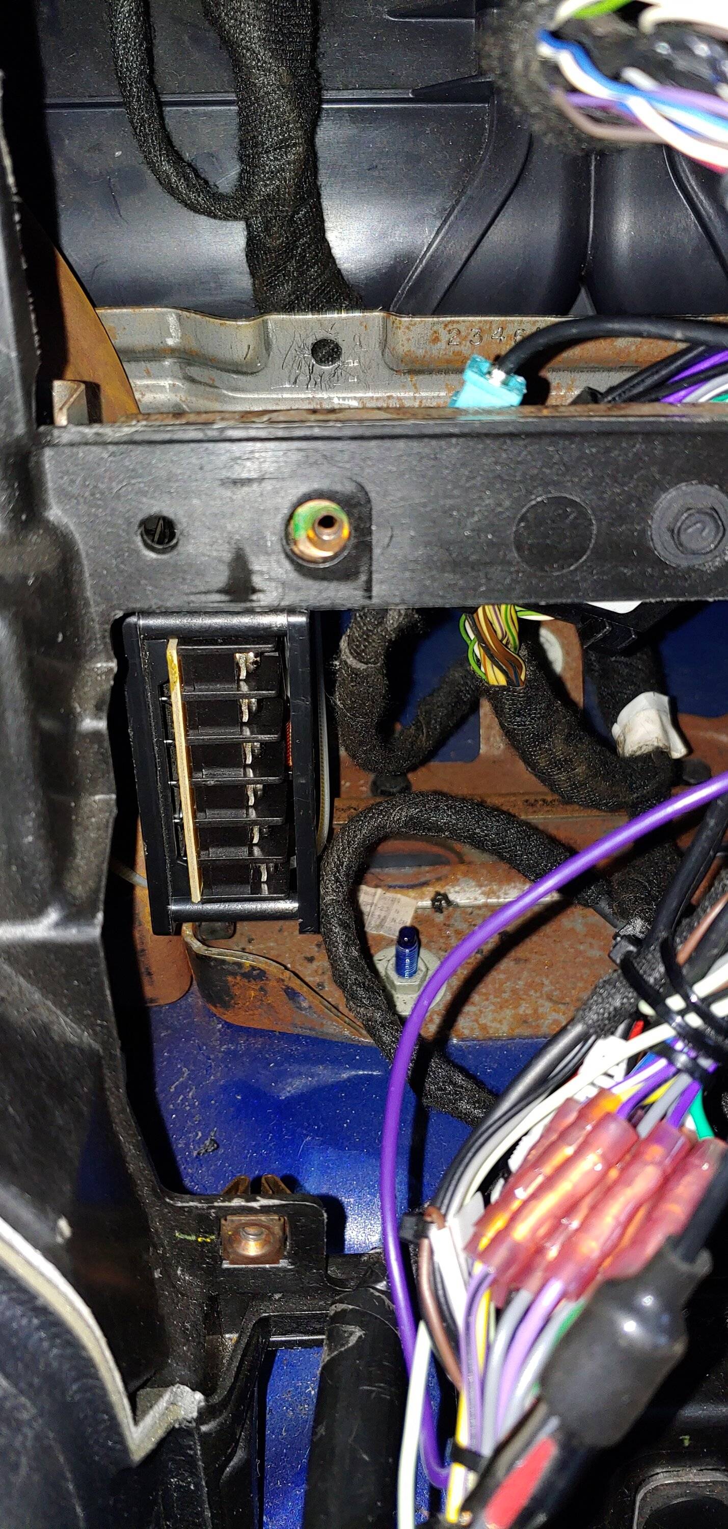

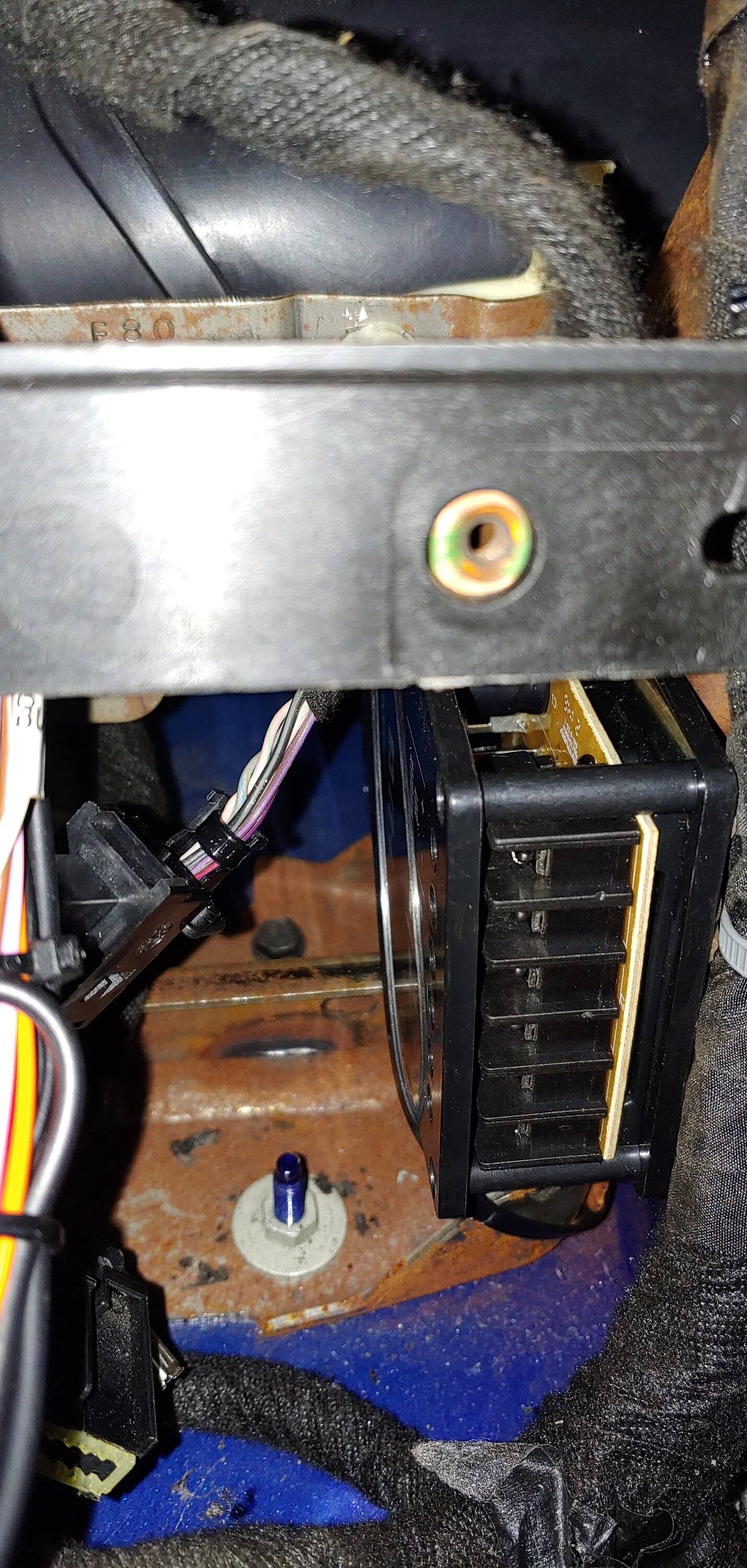

Yeah. I read that there's a cap you have to remove with push tabs inside it. Haven't tried to tackle it yet. I decided to attempt mounting my crossovers behind the dash. I used doubled-up long plastic ties to secure them. They are installed but it may have been a mistake. They are too thick for the scosche module to sit flat, so the head unit above it barely fits. I had to yank on the wires from the bottom as I pushed the head unit back in order to make room. I still have to wire the crossovers, and will eventually run additional wires (remote and rca's for a sub amp). I doubt I'll have enough room then.
Has anyone who has done the scosche kit found a good place to locate the module? I'm finding that even after popping out most of the push clips attached to the factory harnesses, there's still not much slack to move the module around (with wires attached).
I was going to attempt to install as shown here, but they are too long to sit flat behind that metal frame in front. Maybe I could bend the tabs forward? Also tried to install them on the angled frame on either side of the head unit. They physically fit back there, out of the way of the head unit but I couldn't find a good way to secure them.

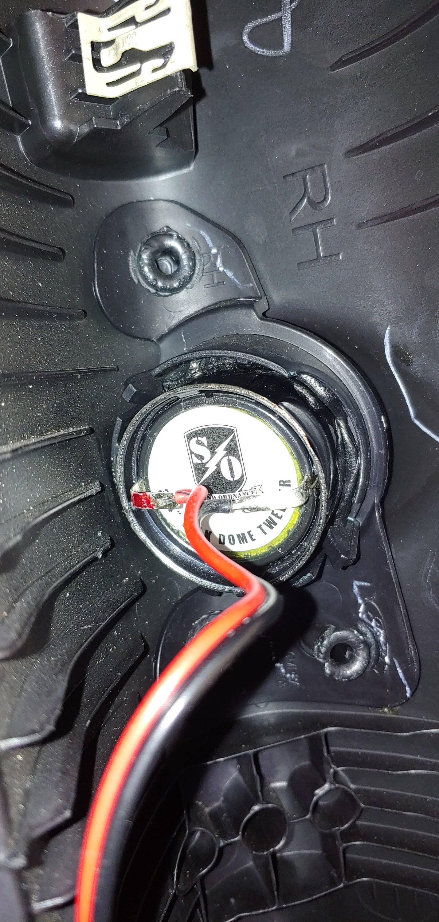

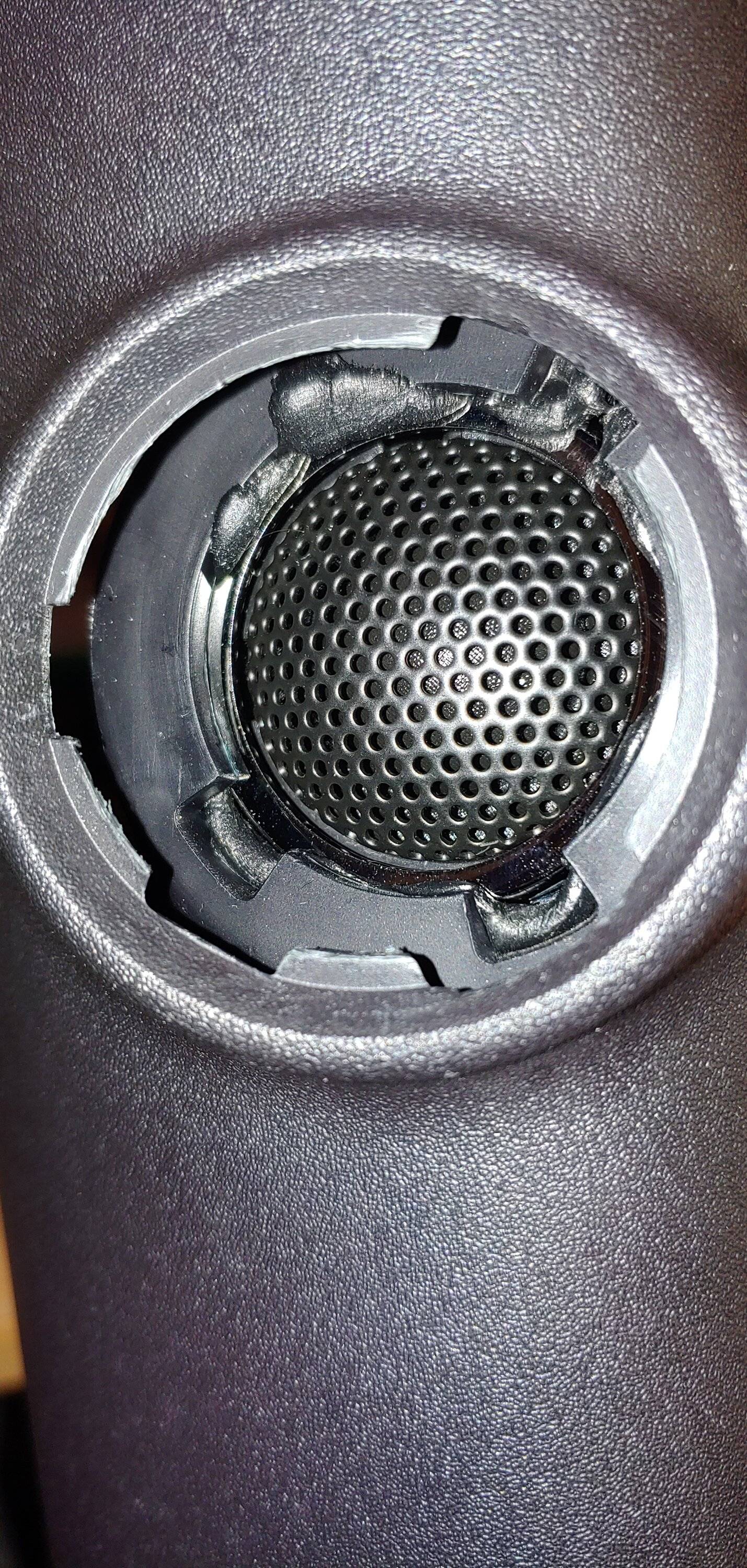

About ready to just give up on it, or possibly even sell the car. Spent most of the day wiring up one side. Connected the crossovers, running tweeter wires up the A-Pillars, basically using the crossover as an intermediate between the head unit amp. I ran the woofer connection out of the crossover to the factory door speaker wiring, and ran a new tweeter wire up from the crossovers to a-pillar for the new component tweeters. I mounted them using thin butyl rubber "rope" that the tweeters came with and the front sleeve from the surface mounts. I have not upgraded the mids from the component set yet. I'm still on the powerbass mids I had replaced before. Sound is about the same, and I'd argue the tweeters even sound a bit worse.
So I'm left to blame either the stock wiring, the door design (midrange harshness), and/or the position of the tweeter further back with an obstructive grille in front of it. Put your hand in front of a tweeter playing loudly in open air. It will sound extremely harsh because the sound is being deflected.
I have some fast rings I will add when I upgrade the door speakers (in front and behind). I'll be finding a spare set of A-Pillar covers at a junk yard so I can dremel things out and flush mount the tweeters without the factory grilles. If there's no improvement from any of that, i'm basically throwing in the towel.

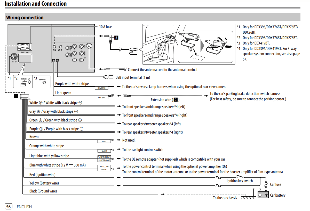

I just thought of something after looking at the Kenwood deck. You could run the 2-way active right off the head unit. No need for an external crossover and you may be able to balance the sound better. This is assuming you do not need rear speakers. This will also allow you to set independent levels and time delay for each speaker.
Run the White and Grey direct to your mid-bass. Green and Purple wires to your tweeters. Make sure you set a high pass cross-over on the tweeter channels first before connecting them and running power through them. Tweeters can be damaged by playing content below their resonant frequency. See page 41 and Page 66 for all available crossover settings.

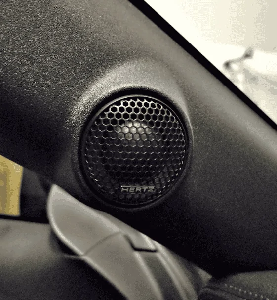

That's exactly what I was thinking. I noticed if I test the tweeters at home, if my hand, or even a piece of speaker wire gets in front of the tweeter, it sounds harsh. I would have flush mounted if the Sound Ordnance tweeters would have fit. They have a threaded ring on the flush mount cup. It is too big to fit inside the opening. I had to use the front part of the surface mounts to install them with butyl rope. I was thinking of getting a pair of decently affordable separate tweeters (infinity, polk db1001) which I know will fit (from forum posts), and just using them with my existing crossovers. I have ancient pairs of Lanzar Titanium, and Silk dome tweeters, and an old pair of elemental designs tweeters from the edi6000s components. All of those would have fit inside the A-pillar opening if I dremeled out the factory tweeter mount. They aren't threaded though, so I'd have to fabricate something to hold them in place. What model are your Hertz (Dieci), and how much work was it to get them flush mounted?

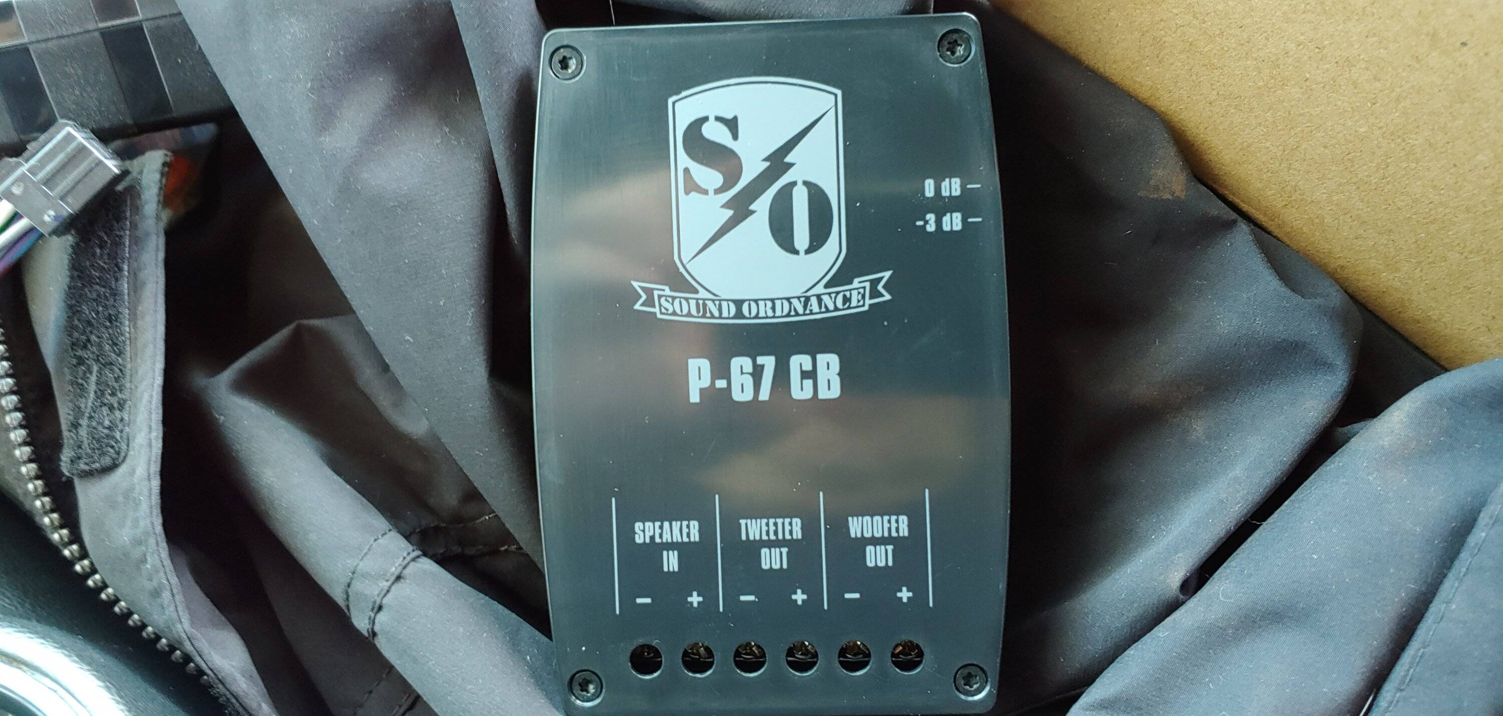

I have definitely checked the polarity. I may purposely test them in reverse, as I've read it can help with harshness and soundstage. I have not tried the -3dB setting, but they are adjusted at least that far in the radio. The kenwood has a +/- 8dB gain adjustment for the tweeters with a selectable center frequency. I have it on -8 @ 1khz, with the additional cut in the EQ. It somehow works, even with the component configuration. Basically cuts everything above 1khz by 8dB.
If the harshness persists after moving the tweeter out, it may just be the characteristics of the speakers you bought.
The factory, Powerbass, and now the Sound Ordnance, all share a similar harshness, so I'd bet it's the "recessed" position of the tweeter.

Also, I removed the factory grilles from the tweeters and the sound changed. They became a bit smoother. I'm thinking the "horn loading" idea may be true, especially considering the new tweeters are actually back a bit further than the stock tweeters, with the outer frame from the stock tweeters partly in the way. I would love to dremel away the openings until the threaded flush mount cups will fit but don't want to ruin the a-pillars if it doesn't work. Was trying to find a spare used set but that is difficult. I have also found that after installing the new 6 3/4" woofers, they sound much smoother now. I only had to drop 1.6k, 2.5k, and 4k, and a small amount in the mids. If I could just mellow out the tweeters, the system may be palatable.
