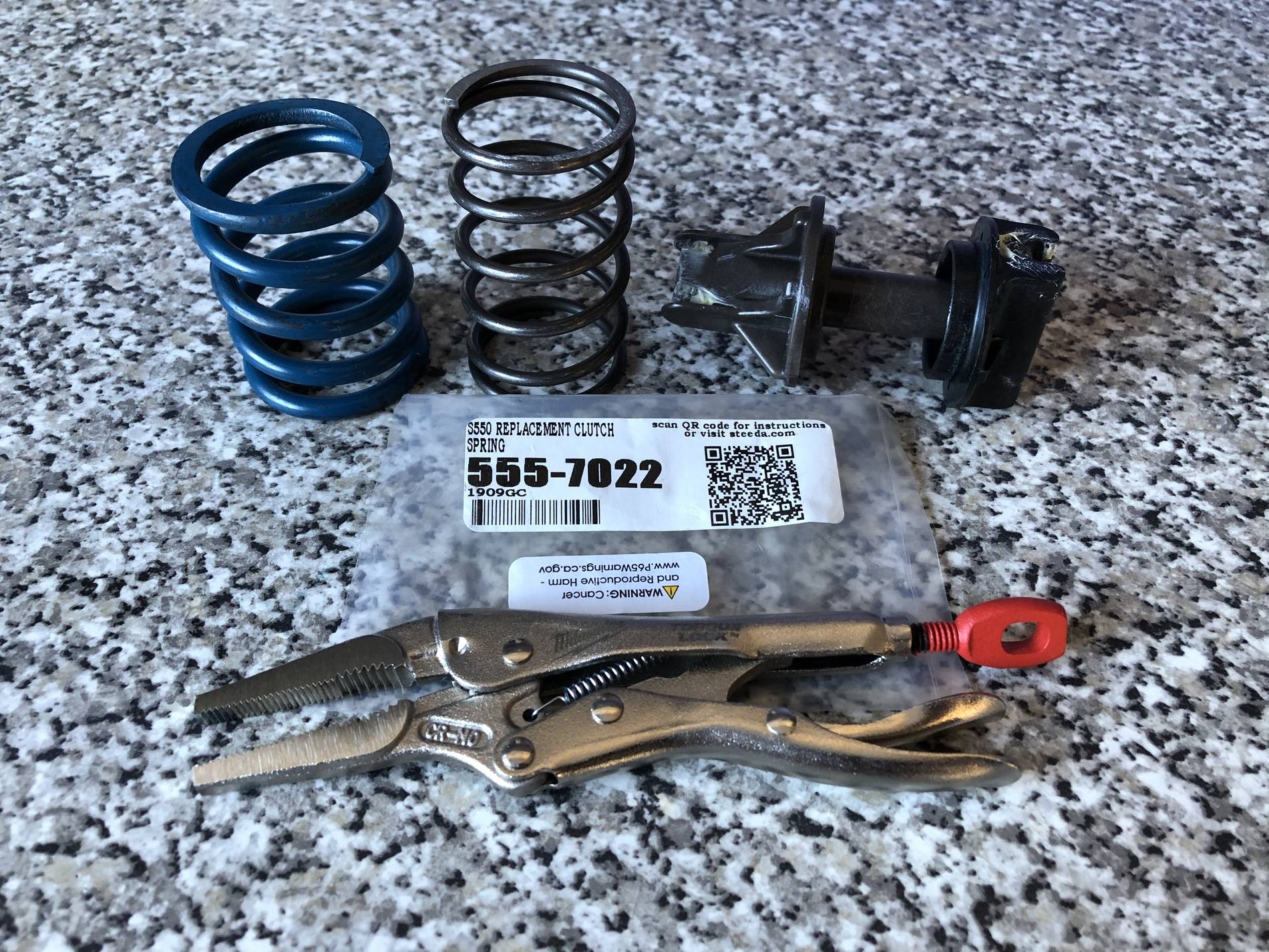

I think I depressed the peddle, got the tips of the vicegrips between the coils, left the peddle up while putting pressure on vicegrips(or they push out) and when coils closed I was able to lock the vgrips
Had to pre set vgrips for gap before starting process. Then I was able to wiggle spring out.
Easiest way to get the new one in is to press the spring on a bench, with grips or in a vice, then use small zip ties to hold it compressed. Put it in place, then cut the zip ties. That way you don't have to line it up, hold the clutch and squeeze the spring all at once while semi-upside down.

WD Pro
Jan 18, 2018
132
6,824
13,679
United Kingdom
Lime GT
Mine fitted easily with the tool shown and following (official) instructions i.e. no broken perch etc :
I watched some unofficial videos on YouTube and I'm not surprised with how rough some people were of why the perch can get broken.
I am a RHD car so perhaps that effects how easy access is / chance of breakage etc.
Difference in appearance between OE and Steeda springs are significant.
Oh yeah, don't drop the perch on the carpet as you might get grease on you carpet - don't ask me how I know ... lol
