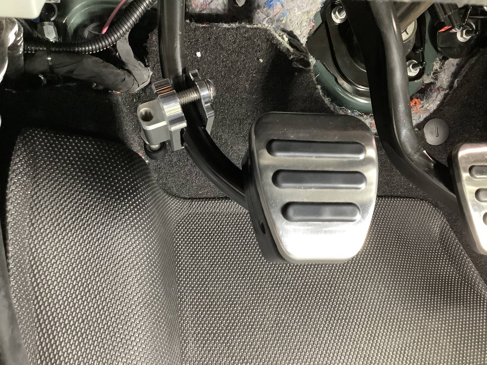

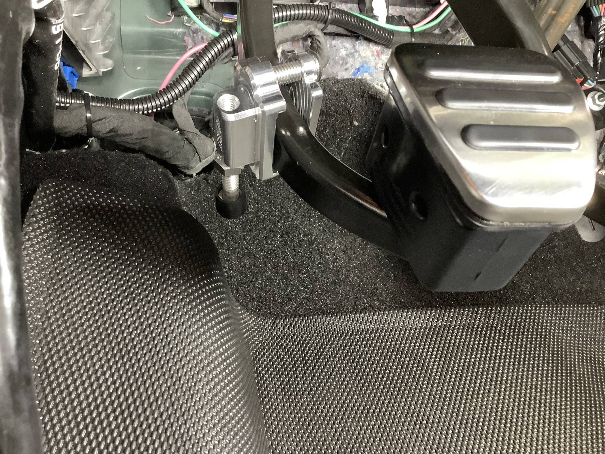

The only thing you can do with a hydraulic clutch to take up some of the excess pedal slop is to install a clutch pedal stop (easiest) or install a Ram clutch height adjuster (more difficult install, in that you will have to open the clutch system which will require bleeding the system afterward). If your brake/clutch fluid is dirty, then this would be a good time to flush it and refill with fresh fluid.
https://werksjdmstore.com/products/...nHC_VIcAlPOKa47rWVrlUnQ6pEWnbZnUaAmijEALw_wcB
https://www.googleadservices.com/pa...uBAxW9QzABHTD0CzEQwg8oAHoECAUQDA&nis=2&adurl=
Here is mine installed on my Bullitt.

the clutch stop you have is a great idea. I only need to move the pedal about 2 inches to engage and disengage so this would be perfect.
I’m trying to find somewhere that sells them in Europe.
All the US places won’t send overseas

Quick question?.
Does the clutch stop affect the start button?.
because it would need to engage to start the engine ?.

It can, depending on how much you need to adjust it, but it’s an easy fix. I didn’t have to do this on mine, but I was prepared to remove the plastic button tab on my clutch pedal which presses the clutch switch to allow starting and install a button head screw with a jam nut on it to allow for proper adjustment like the factory.

There are several variations of the one I have that look exactly the same. I actually think they’re being manufactured private label for different companies.
