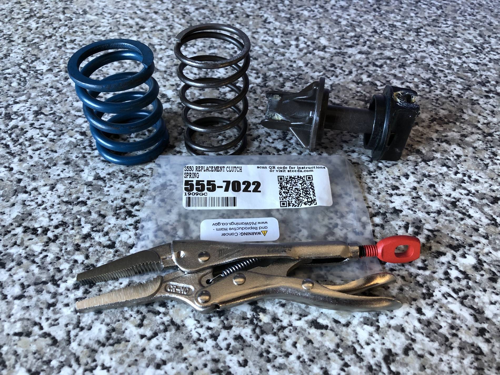

Softer = yes, but not shorter (not on what I got supplied with ?) :
WD :like:
