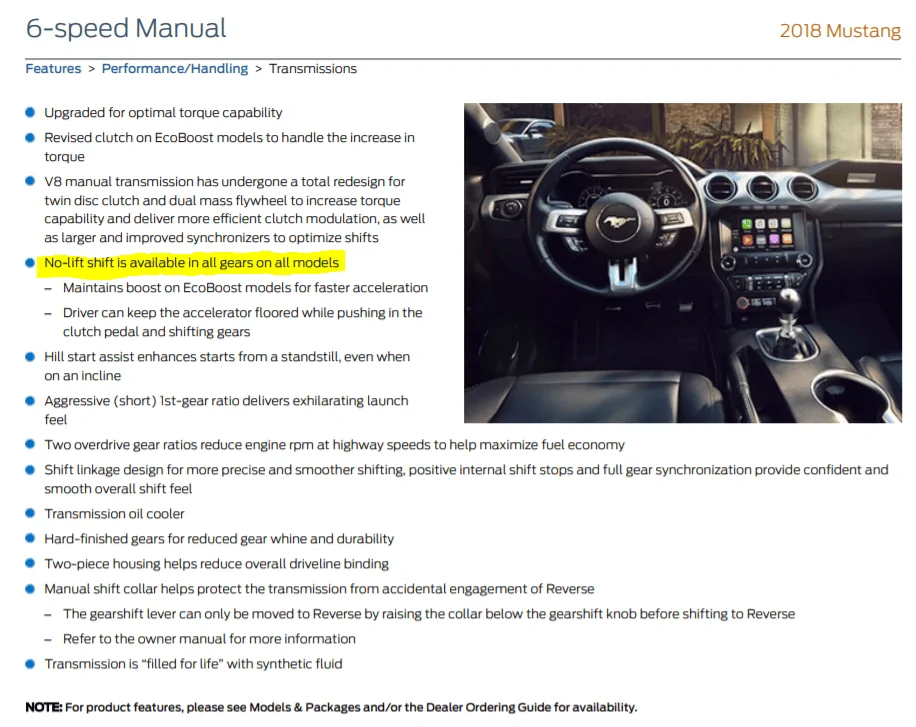

Found this:
Says "all models" but the wording reads like it is only meant for Ecoboost models.

Found this:
Hmmm...
