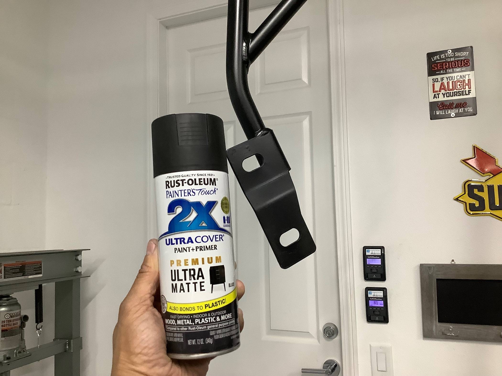

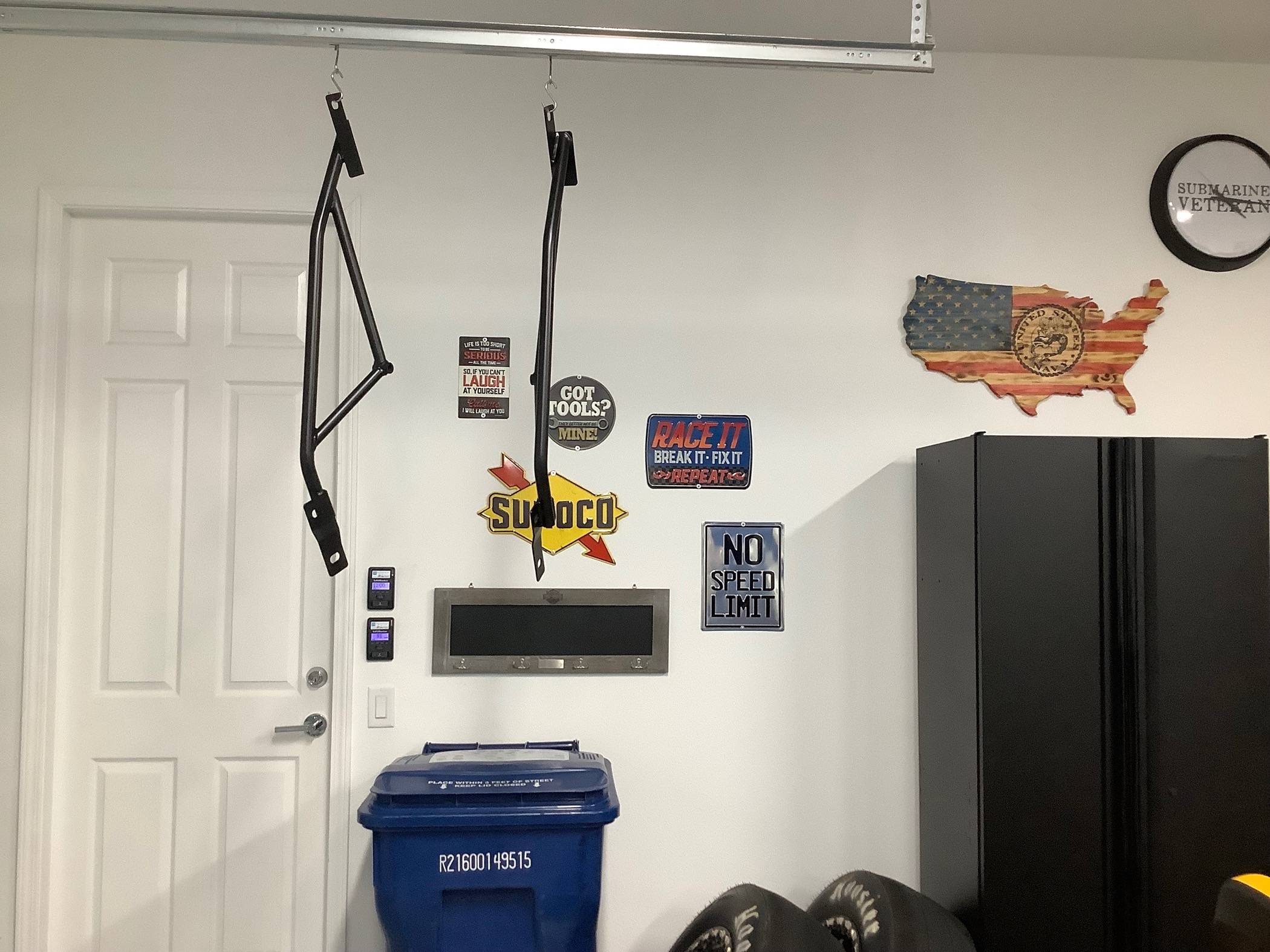

I got started on mine today. I started out using a wire wheel, but that was making deep scratches in the existing powder coat, so I transitioned over to using a Scotch-Brite Extreme Scrub Pad and a putty knife to scrape off the loose powder coat. Once that was done, I wiped both pieces down with brake and parts cleaner.

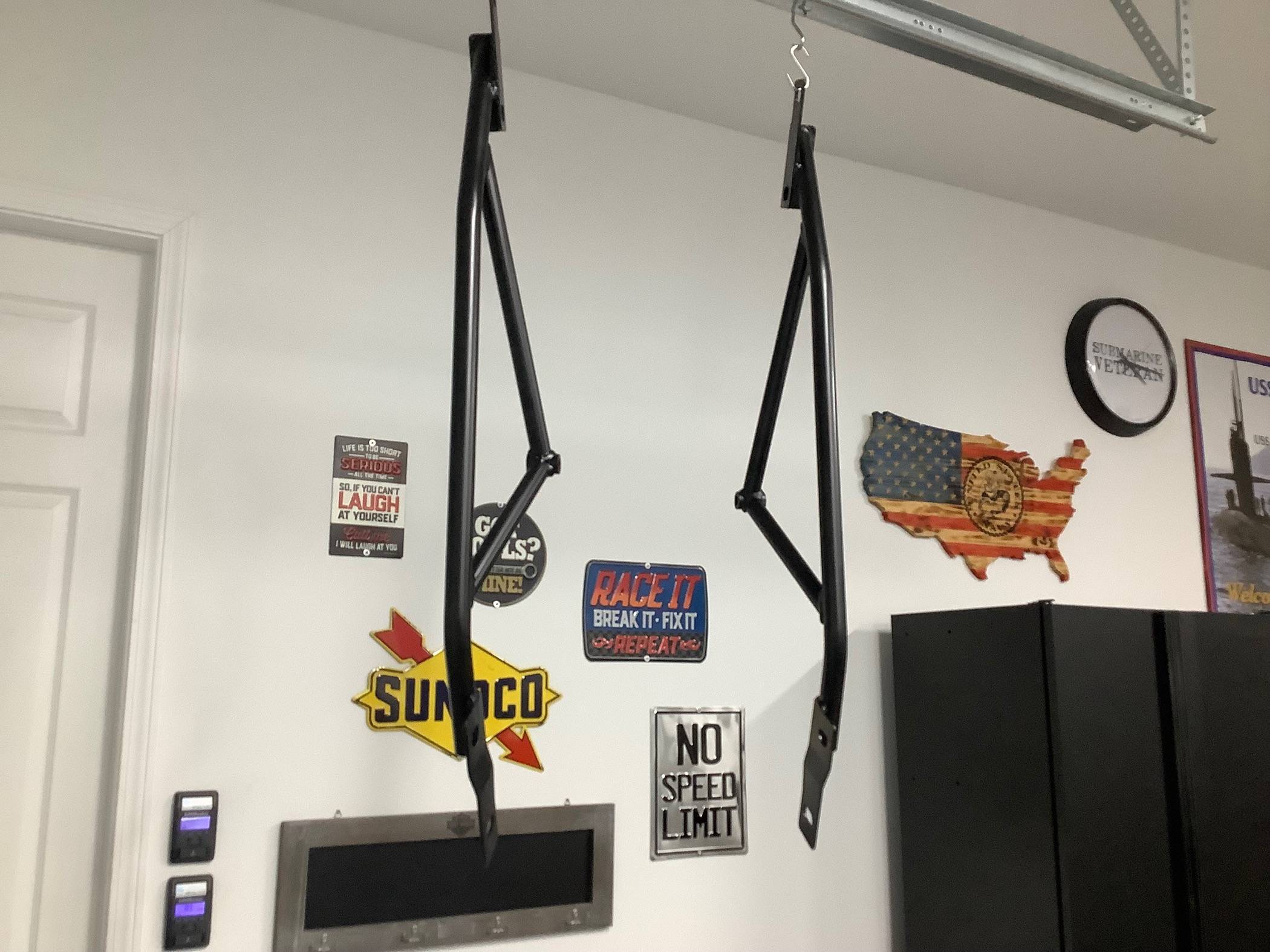

I decide to spray them with black first, so that when I begin applying the gray, I can ensure that I get full coverage. The can says a second coat can be applied within 1 hour or after 48 hours, so I think I’ll let them hang dry for 2 days and then follow up with the gray.

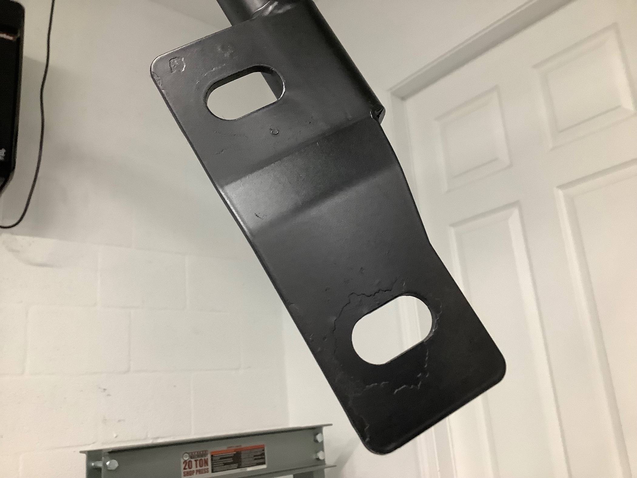

They’re not going to be perfect, as you can see the areas where the powder coat was scraped off, as well as the scratches from the wire wheel. The main thing was to get a couple of protective coats on them while they’re off of the car and I think I’ll be able to accomplish that. Stay tuned for an update in the next couple of days.

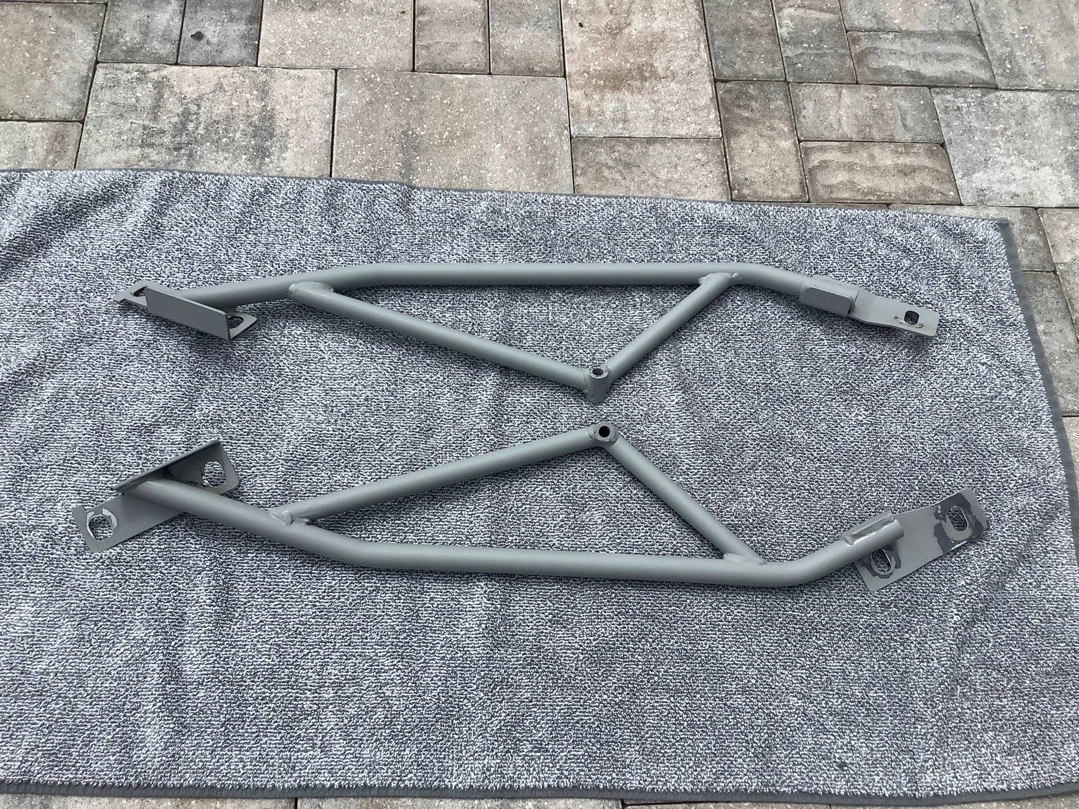

Yes, please! That would be great! I have one good coat of black on them and will probably end up putting one or two coats of gray on them. The gray is going to be lighter in color than the powder coat, but I’m hoping the black undercoat may help the darken up the gray a bit. I’m no painter, so Iā€˜m not sure if that will or won’t work. I’ll know soon enough though.

Does anyone know if it would help with paint curing to leave my garage at room temperature, which is 86* or would turning on the AC and keeping it cool (around 73*) for the next couple of days would be ideal?

@NGOT8R - Humidity greatly extends most paint drying time. If the painted parts are going to be inside and not in the wind/sun, I’d go the 73 degrees route.

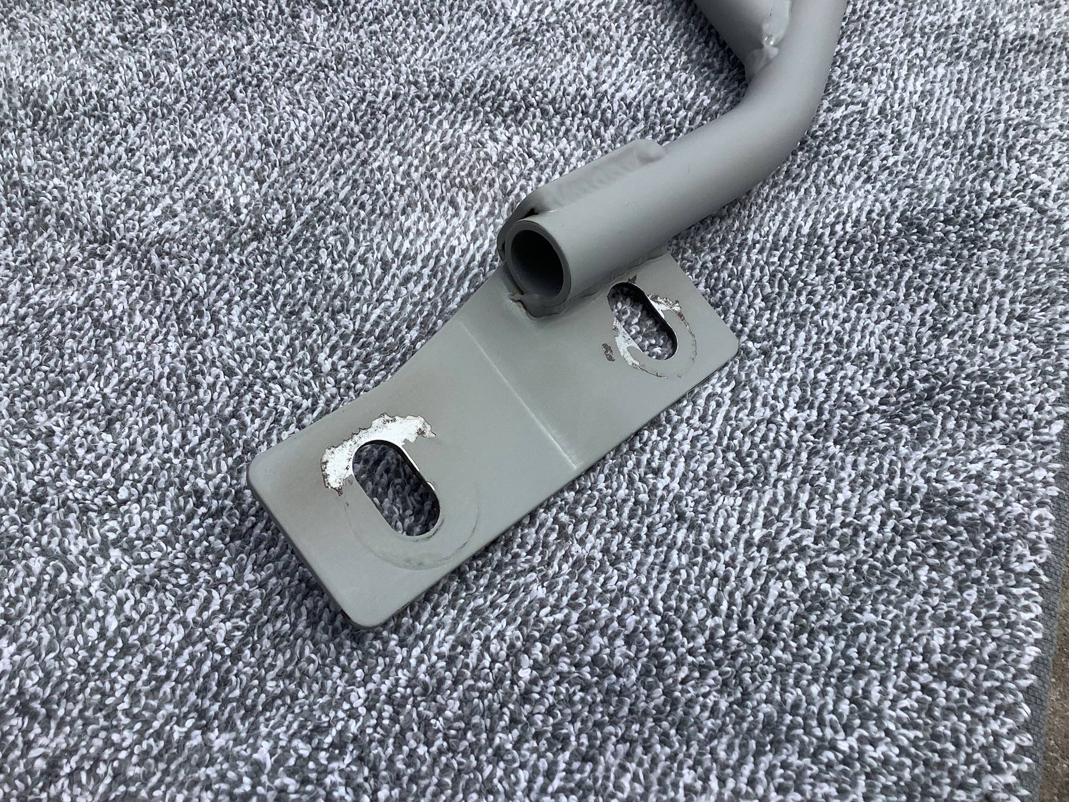

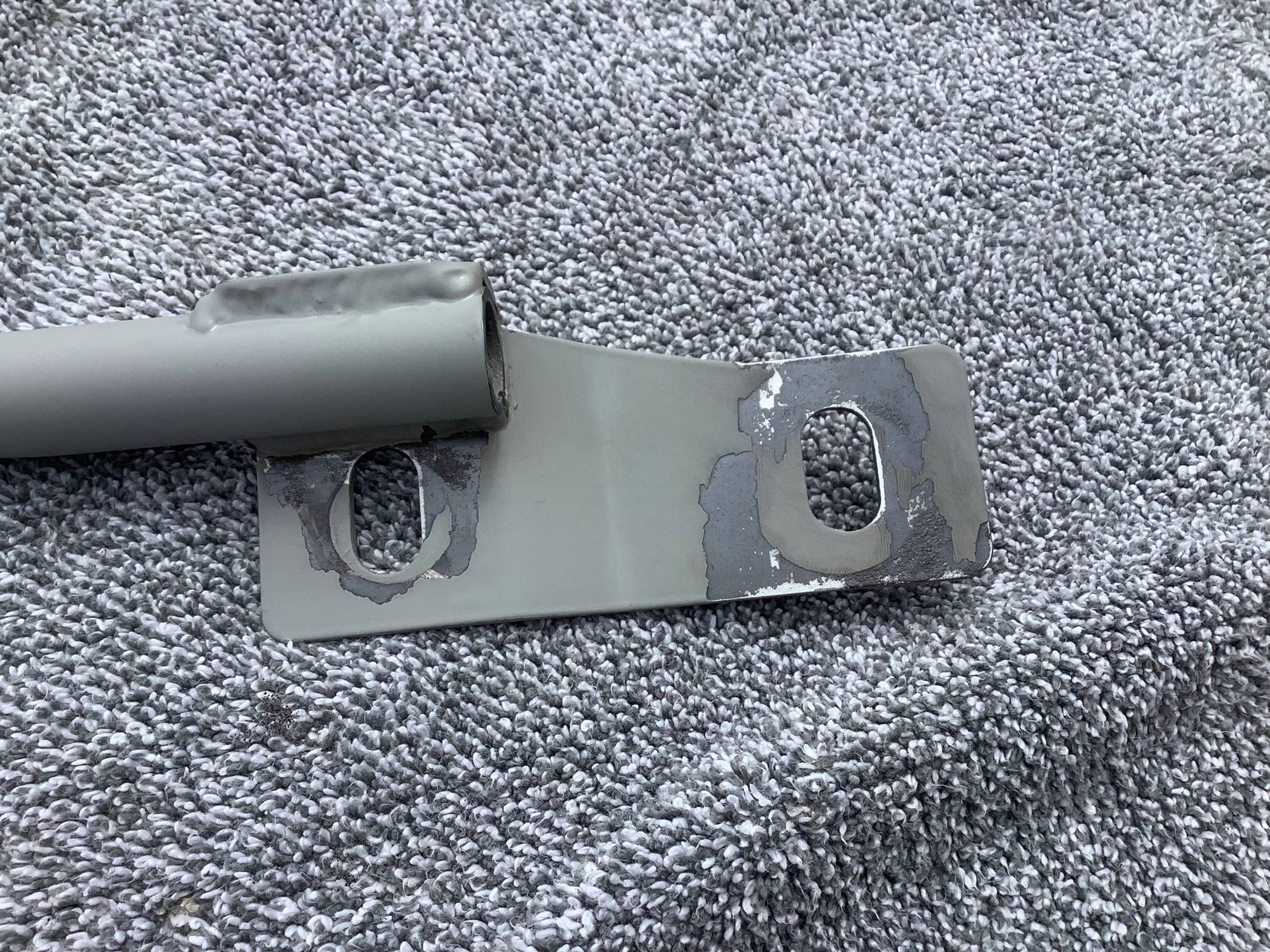

My OCD is trying to kick in again. I’m debating whether to try this method on the mounting plate areas of the subframe braces to get rid of the obvious edges from where the powder coating was removed with the putty knife and/or wire wheel on one brace before I realized the wire wheel wasn’t such a good idea.
Anyways, I thought I’d share this in case someone wants to strip theirs the easy way prior to painting it. Let me know your thoughts before I make a decision. The last thing I want to do is make matters worse by doing this if it might negatively affect the surrounding powder coated areas.
I should also add that I am ready to finish up the car and begin driving it again after being down for a month, so more lengthy delays aren’t very appealing to me at this point.
