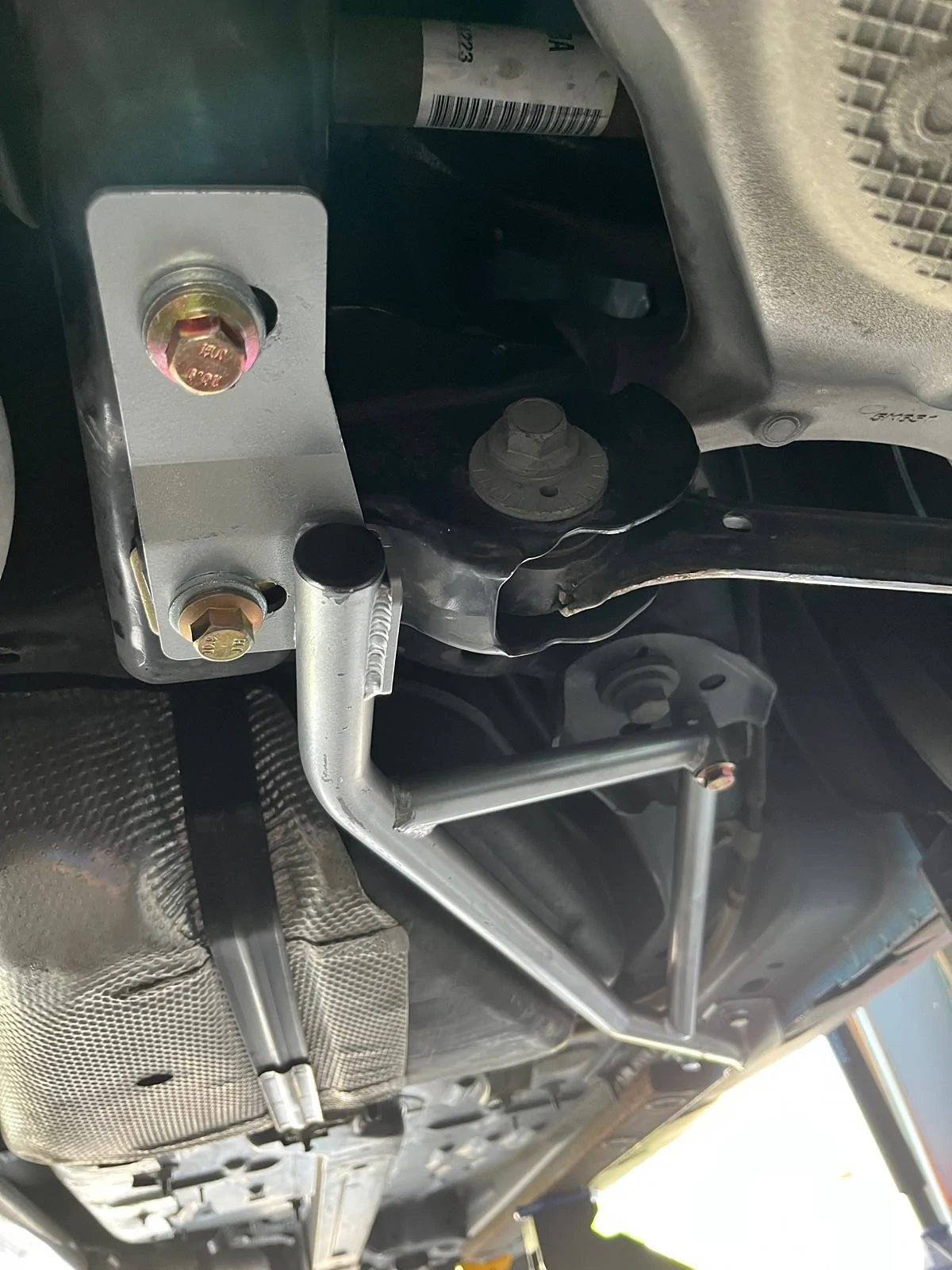

I’m stock suspension but have the Steeda IRS braces. I noticed a difference immediately. Rear end feels more planted. I hit them with a few coats of high heat Rustoleum as I drive my car year round

@MAGS1 when was the photo taken? Maybe I should have mine powdercoated?

Right after I put them on last summer. If you zoom in on the pic, you can see my Steeda jacking rails starting to rust. Took 4 winters but it finally started happening. Those are just the standard Steeda powder coat.

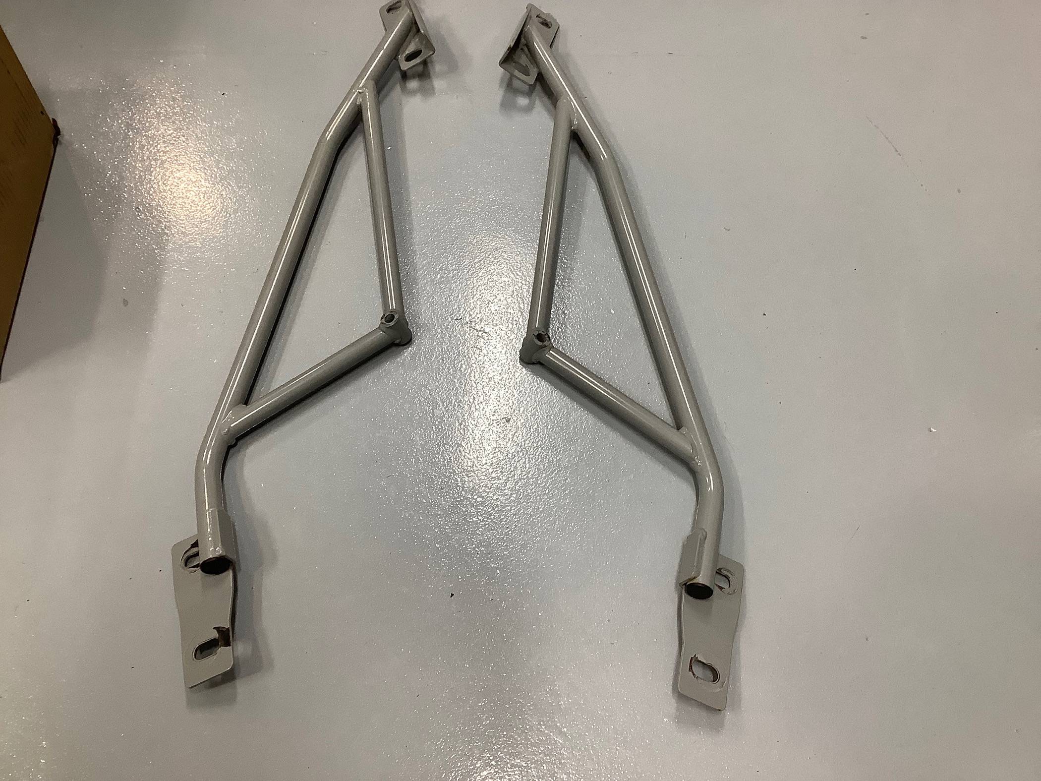

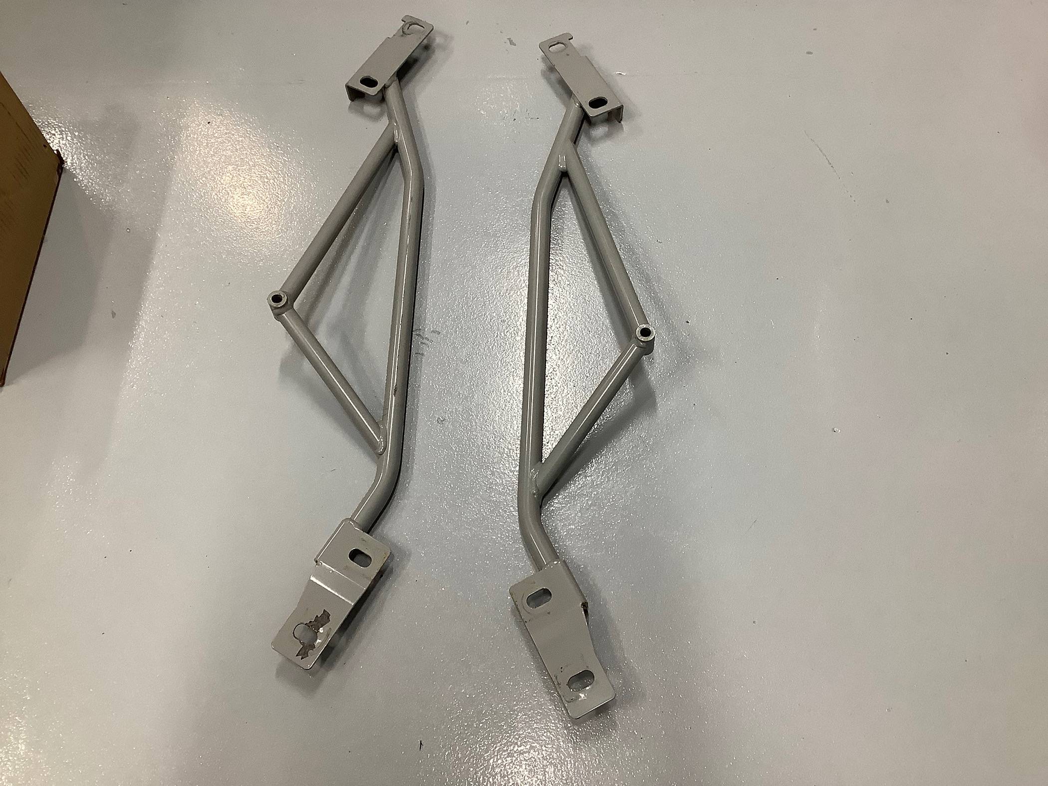

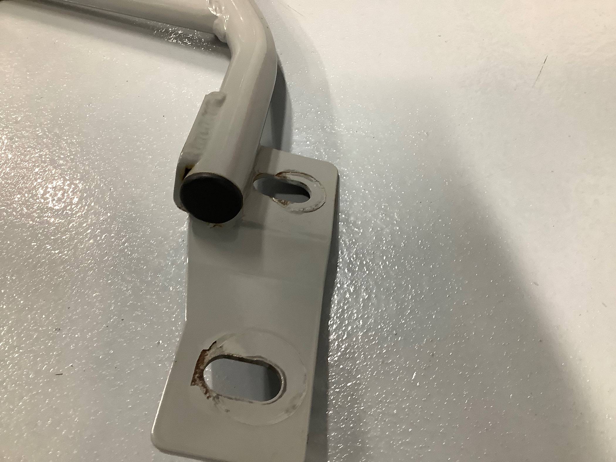

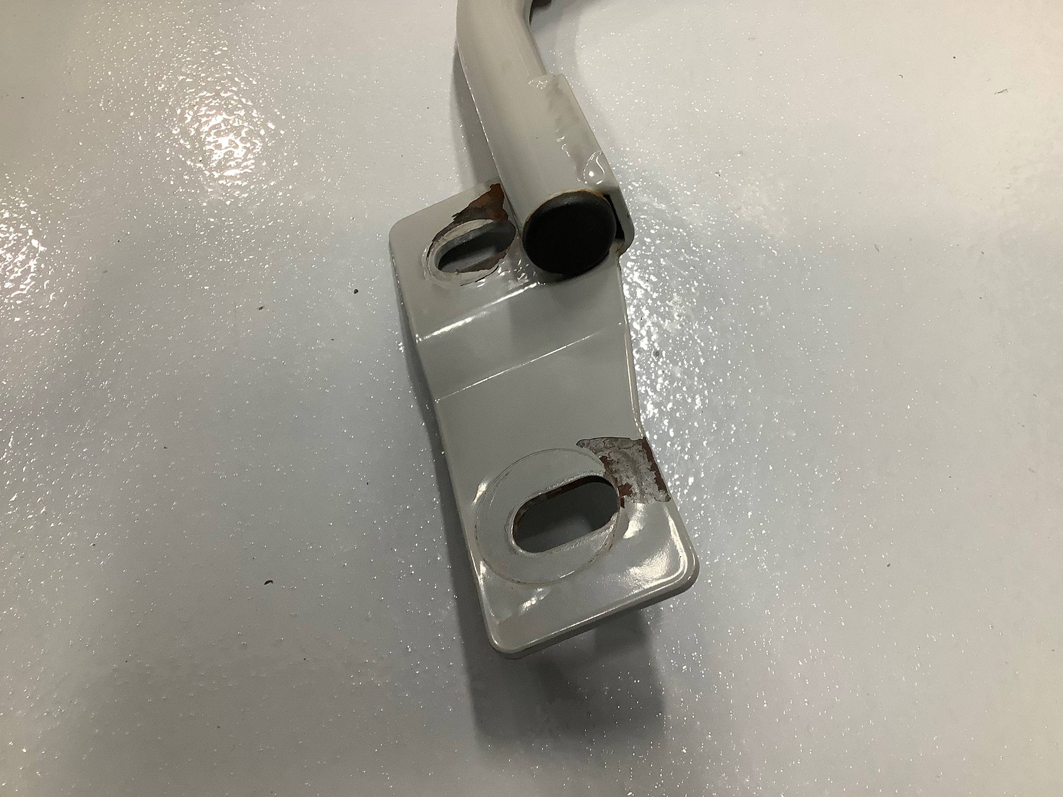

They already come from Steeda powder coated. However, the thing that I’ve noticed is, the metal seems to have not been sandblasted prior to powder coating them.
My car has never been driven in the snow and has only been driven in rain a handful of times in 3 1/2 years. My braces are peeling and slightly rusting already. I just pulled them off a couple of weeks ago to do more suspension work. Here is what they look like today (still off of the car). I’m thinking of touching them up with some gray Rustoleum.
It would be costly and a PITA to have to wait on a shop to powder coat them. Besides that, it would also mean removing and taking my Steeda drive shaft safety loop and rear adj. toe links to have them done, so that everything matches. I could easily see a $300-$500 cost associated with having all parts done.

I used silver high temp Rustoleum on mine. Did 4 coats, we’ll see how well it holds up under the car.

Oh man you're right. I put POR-15 on the car itself under there before I put them on, but did not coat the actual rails. I am dreading the idea of taking them off and putting that on those too. It stops rust dead but looks meh.

They are thick gauge so won’t rust through, even if the surface looks poor - just get them done at a later date / when the cars off the road / when your looking for a bit of a project / when you feel they need it etc etc.

My set, defo didn’t have any surface prep.
I don’t know what costs over that side of the pond are like, but talk to your local wheel refurbishment place - a set of braces will cost approx the same as a single wheel :like:
