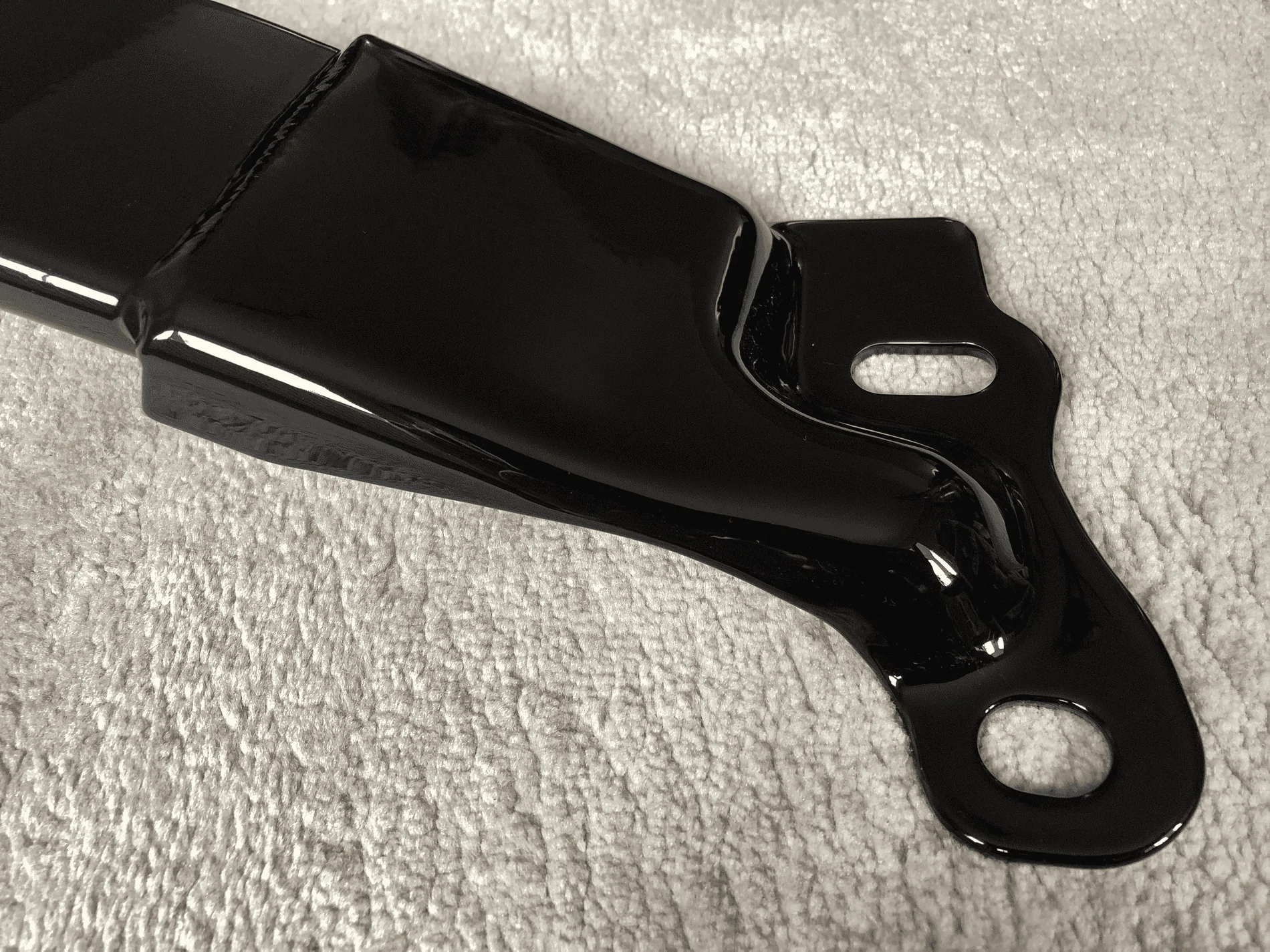

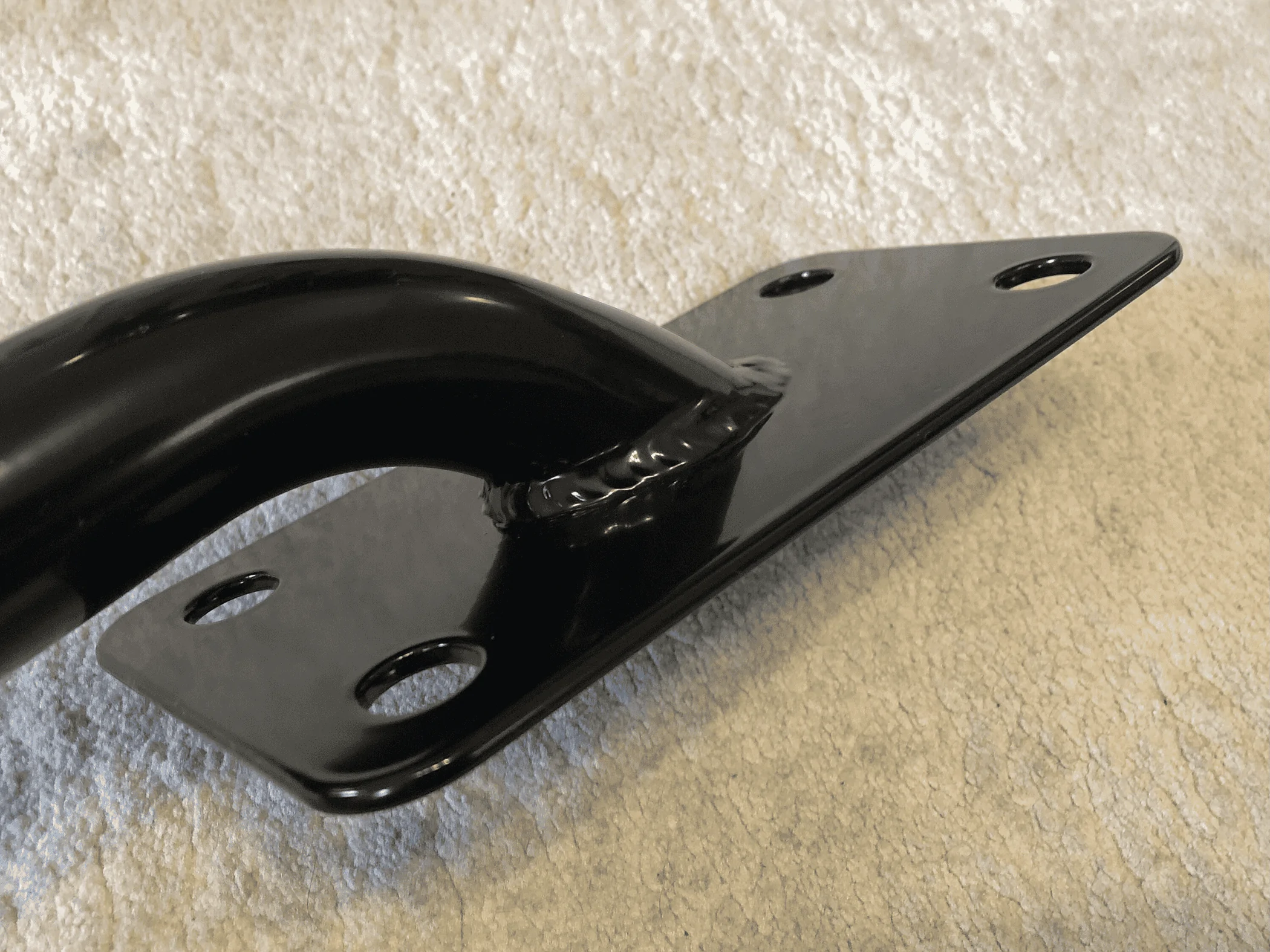

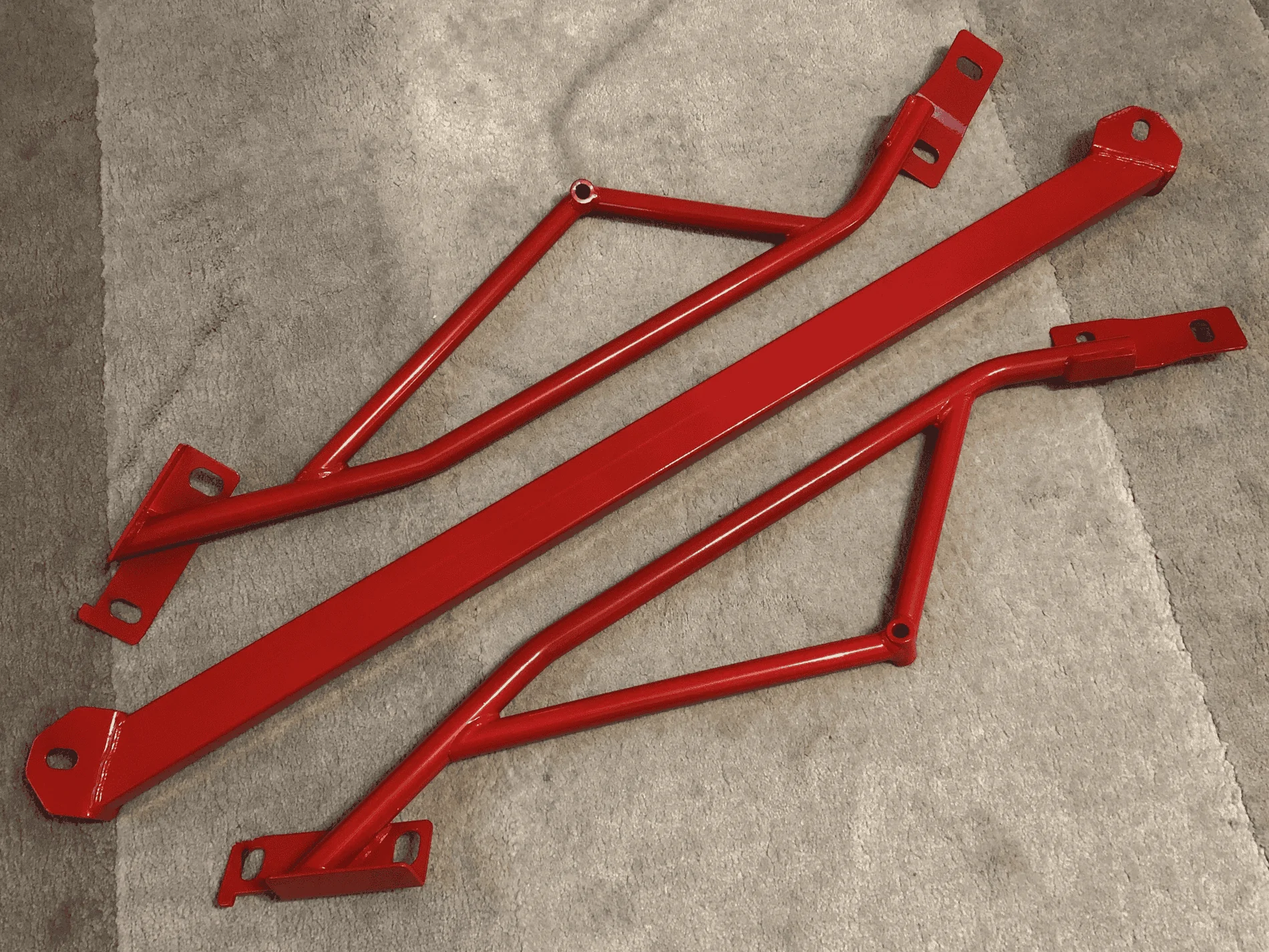

Looks great! What product did you use on them? How did you prep the surface?
Hi,
Here is the process I followed :
  • Found a reasonably good quality / reasonably good value local wheel refurbisher who was prepared to work with me.
  • Took the front and rear braces for the standard process.
  • Interrupted the process after chemical stripping.
  • Took the stuff away to fabricate / modify.
  • Returned it back to the powder coaters.
  • They finished the blasting and coating process.
  • On the rear braces, I sprayed (way to much) cavity wax into them, then put the bungs back in
I've done the exact same process for my 350 aluminum upper brace (gloss black) and the Steeda front bumper bar (satin black).
The front bumper bar will only get cavity wax once it's fitted, but before the front loom mounting bolts get screwed in.
Although they were 'cash' jobs (if my memory serves me correctly), I think for the 2 x rear braces, 1 x front brace, 350 brace and front bumper bar, I'm up to about £240 split over three visits :like:
I've loads more pictures of the process (as supplied / stripped / modified / re coated etc), but didn't particularly want to clutter this thread - I only posted the above as you are the OP, and it's you who were asking lol :like:

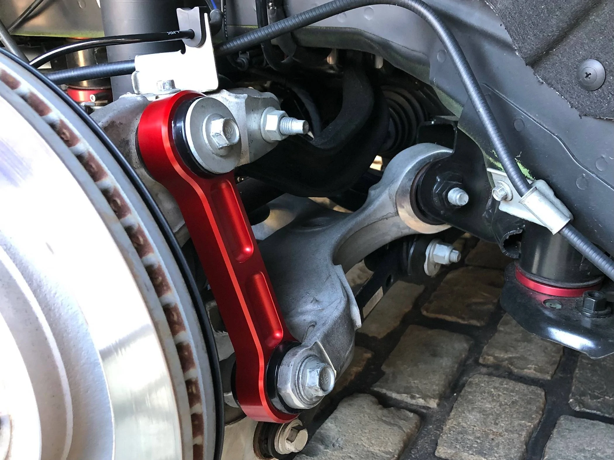

I’ve since done spherical vertical links, and I’ve got spherical toe link bearings to go in :like:

Did you get the Steeda vertical links? I like that they're aluminum. You know, right after the discussion about Steeda's coatings lol.
I went with J&M - replaceable spherical bearings in both ends, really nice CNC work, one less thing to get anodised red, and they made themselves really easy to deal with (oversees shipping) :
WD :like:

Ah yes they do look good and are also aluminum. It's going to be another 7-8 months before I drop the rear subframe again but I'll keep those in mind.
