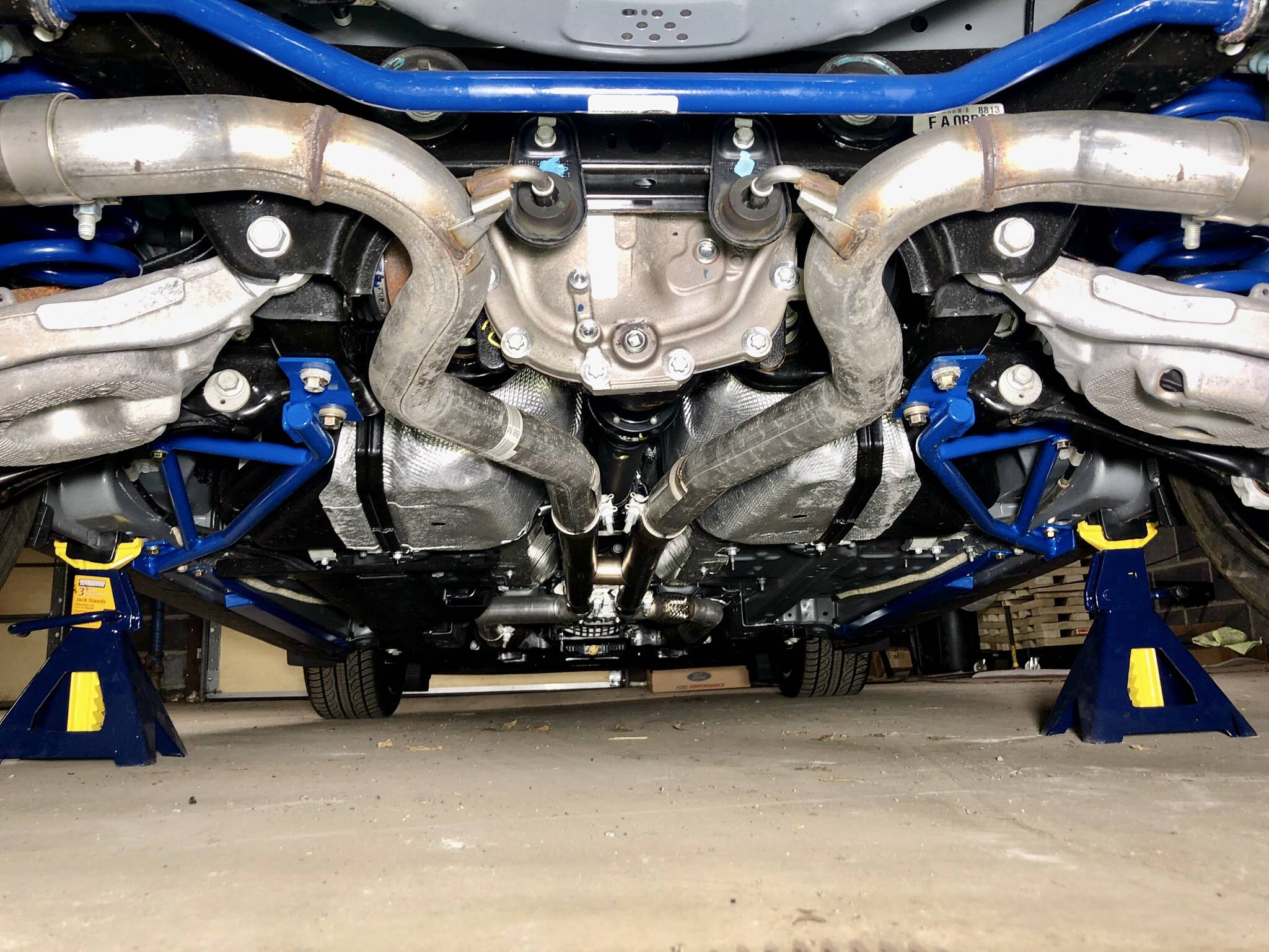

With inferior coating, it would almost be nice if Steeda would offer them bare, so the end user can select their color of choice and be able to touch them up much more easily when needed.
I matched the other blue bits !

What prep method did you use and how many coats? Did you sand between coats?
Like yourself I used scotch Brite extreme scrub, 4 coats & no, I didn’t sand between coats.

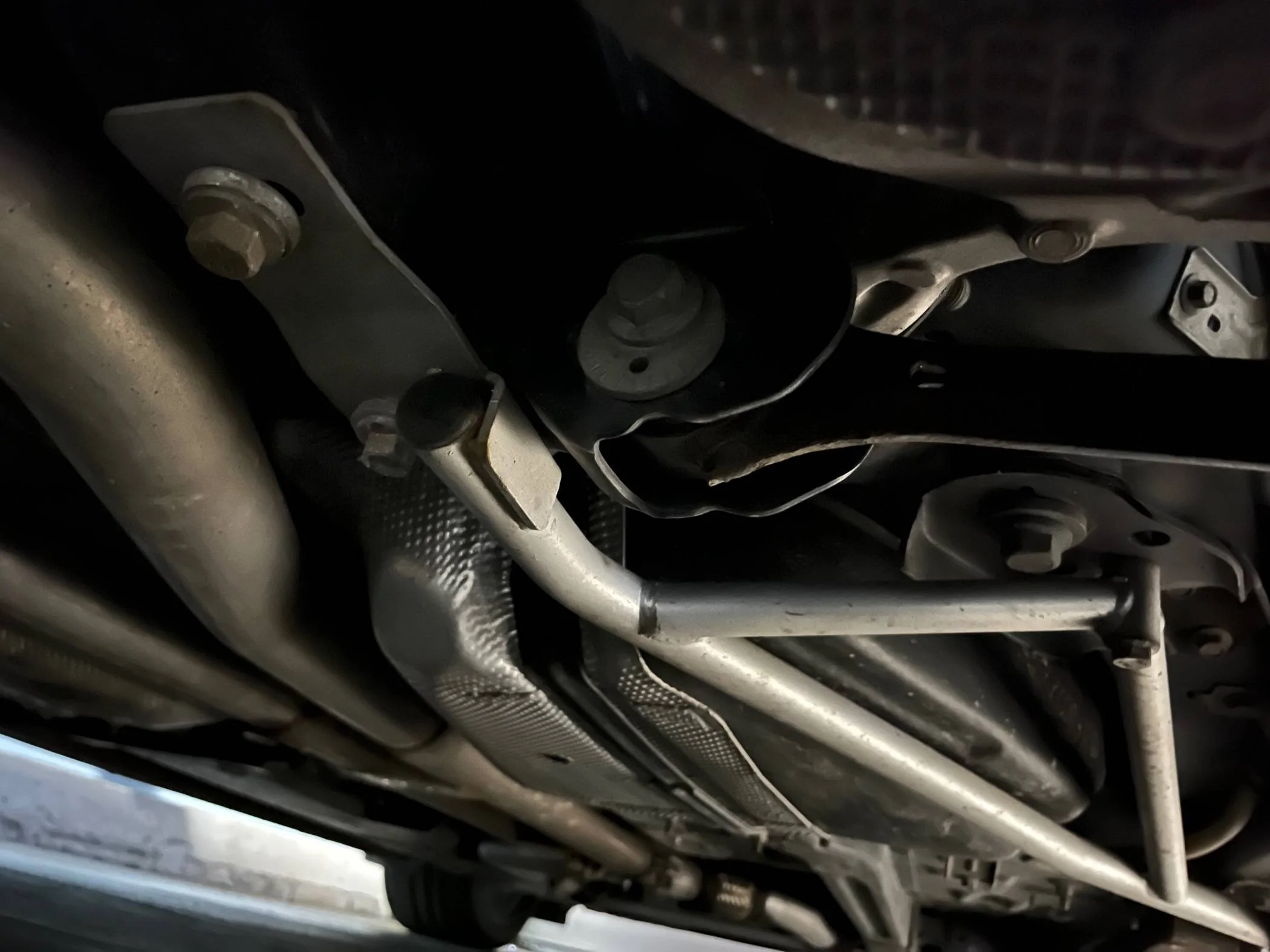

Yes, please! That would be great! I have one good coat of black on them and will probably end up putting one or two coats of gray on them. The gray is going to be lighter in color than the powder coat, but I’m hoping the black undercoat may help the darken up the gray a bit. I’m no painter, so Iā€˜m not sure if that will or won’t work. I’ll know soon enough though.
Finally remembered to lay under the car this morning and get a pic. Looks to be holding up well so far
That’s good to hear! I just went out and sprayed mine with the gray paint today.
Man, this is taking a LONG time! Now it’s wait 2 more days, go back to spot check and correct some areas. The darn tarp blew up onto one end of one of the braces while it was still wet, so I’ll have to try and scuff and touch that up and then it will be 2 more days of waiting before they’re completely cured and can go back on the car.
SMH, I went from replacing a ruptured fuel line, to installing rear drag springs, a drag race sway bar and now, painting subframe braces? I guess that’s what happens when there’s too much down time waiting for parts. I need to get this thing back on the road ASAP!
