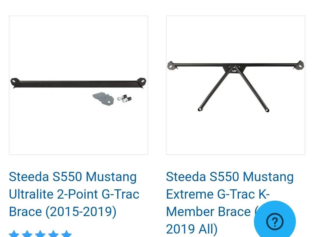

This is going to be the next mod but can't decide on which one. Obviously the 4 point is "better" but is it overkill for a car that won't ever see track duty?
Which one gives better ground clearance?
Can anyone with either of these post up their before / after impressions, and difficulty of install for either one.
@steeda, also your recommendation on this one?
Only reason to not do the 4 point from my understanding is to save the $50 difference or if it doesn't fit your car.
The 2 point will have slightly better clearance because the bottom of the 4 point picture in your post extends a bit lower.

I use the 2-point and love it. While I can’t say it turned my car into a larerally-traversing monster, I can say that it provided more input into the steering which was 110% worth the price.
I can safely assume the 4-point will only improve things further; I think the only drawbacks to the larger brace are price, install time (by a few minutes), and possible issues running longtube headers.

So I went with the 2 point brace. It was like 65$ with Steeda's black Friday sales. I already have the upper cowl/firewall/strut brace so this should be the lower layer of the cake lol.
I went with this one because of ease of install, ground clearance and of course the price.

I think the 2 point is more than enough for street duty. The front end of my car feels solid already, so I didn't buy it to remedy any noticable issues.
Just one of those why not for that price items on my list. Plus any reviews I've read of it were positive with notable improvements.

I have a vert, so anything that stiffens the chassis is a positive. I installed the 2 point version as I will not be tracking it. Ground clearance is not a problem.

I installed mine on a chassis lift, but using ramps should have no issues. In fact, it may even be better to use ramps as you can lay on the ground when chipping away at the slag bits (my arms almost hit muscle failure lol).

I installed the 2 point brace today using jack stands. The driver's side was difficult to put in the sleeve due to hard to remove slag on the inside of the mounting hole but I got it in with a little extra grinding with a file. Front end feels tighter but I'll make that evaluation when I take it out on my favorite testing road. My car more than likely won't see any track time, although I'd like to simply for the experience of driving it closer to its maximum capability than I ever could on the street.
