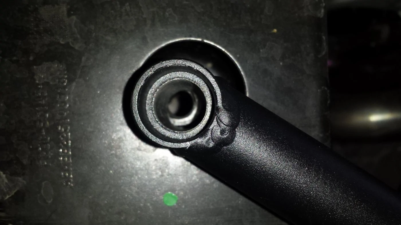

I tried installing mine yesterday and had the exact same alignment issue with the driver side front. It's about 1/2" off. Those slide in spacers for the rear required me to take a prybar and open it up inside some for them to slide in. They were probably slightly crushed from Ford or when my headers were installed and they dropped that same subframe. Gonna put mine on a lift Saturday and try again. It's definitely the bar, hopefully I can coax it to go in place.

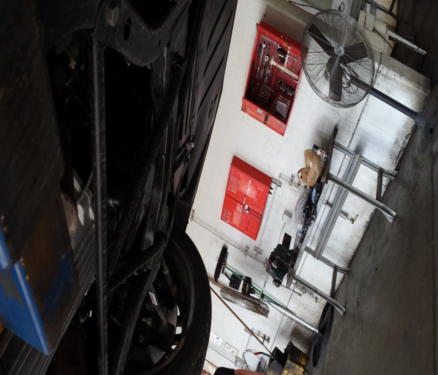

I brought mine to work and put it on a drive on lift. I was able to get the left front in using a prybar between it and the subframe in the hole. I appears the angle of the vertical tube that the bolt goes through is the wrong angle. That or the tubing needs to be slightly longer if I remember correctly. The other side was touching the subframe once I tightened them all up. Nothing I did helped move it away from touching. I haven't really heard any noise yet.
