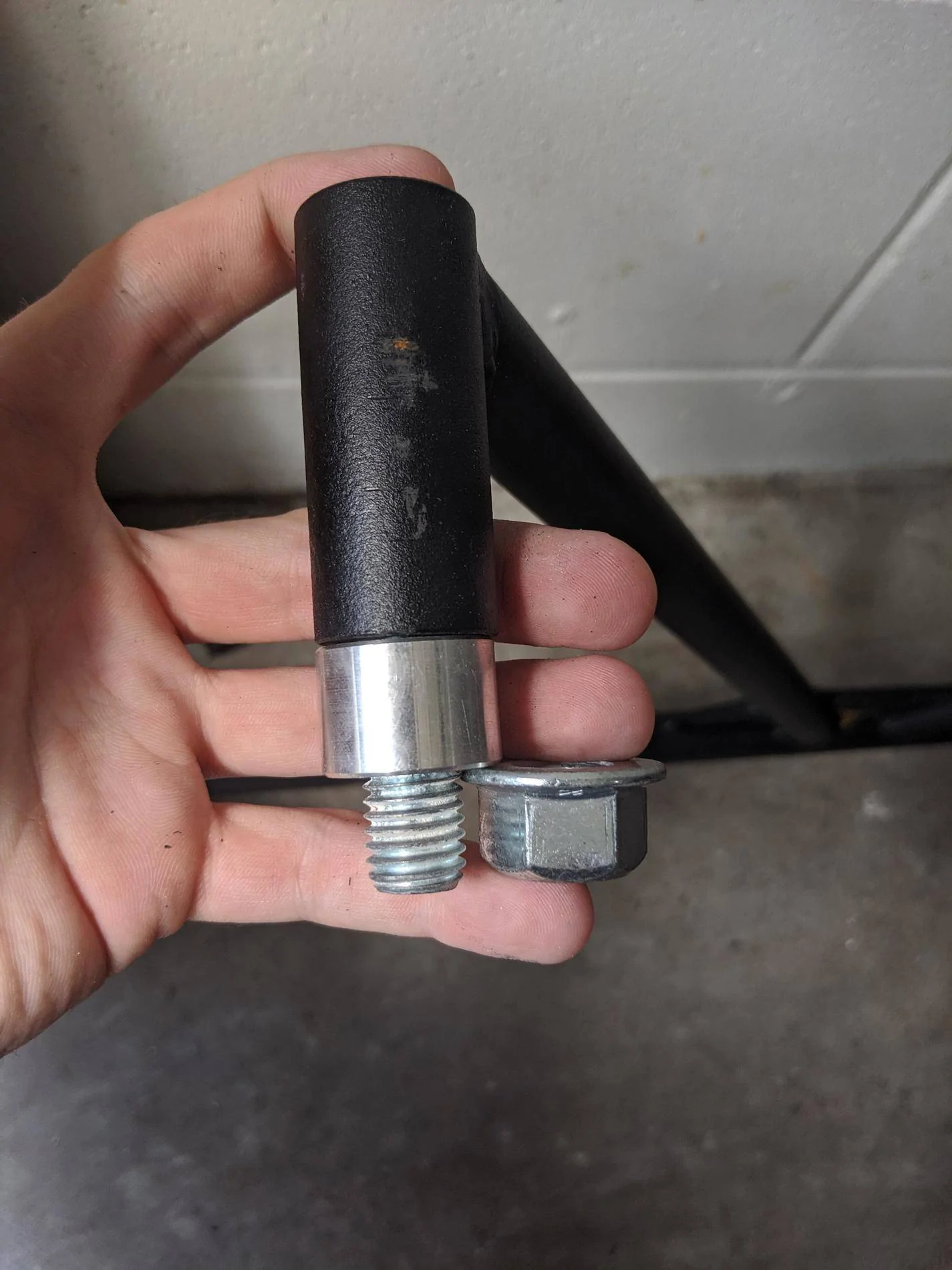

    @SteedaTech
    Did I receive the correct bolts with my brace? (picture below)
    I had an issue with a groaning noise and removed it. I noted on install that the bolt did not pass all the way through the nut when the subframe was in between.

    Acemastr, you did get the correct bolts. That SHCS bolt should be 80mm long.
    The picture provided, (once screwed together with the nut) has an air gap of .130” once the bolt starts to engage with the locking threads. The piece of sheet metal this attaches to is .080” thick, providing .050” of engagement into the locking portion of the threads.
    You should be able to bolt everything together just fine.
    -SteedaTech
