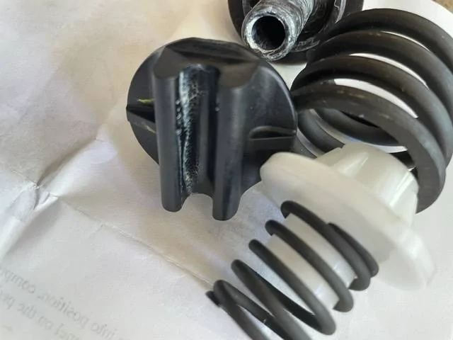

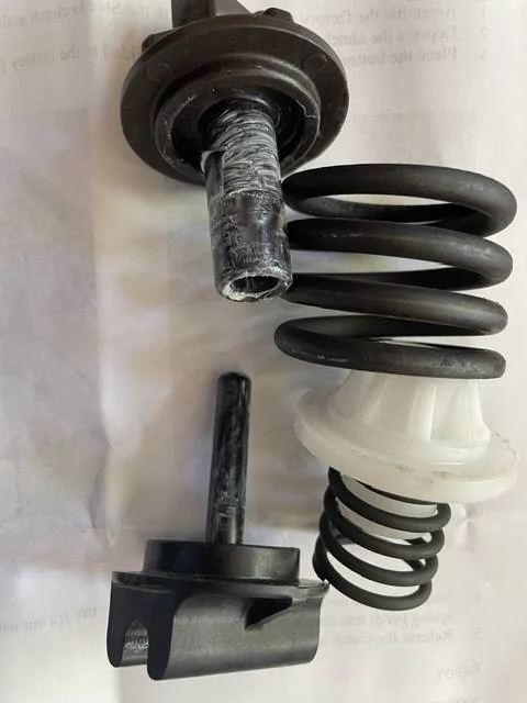

To address the sqeuak/creak, I'd start with the most simple possible fix first - get a little tube of white lithium grease and lube the perch in two spots: where the two halves of the perch intersect, and where the perch mounts into the channel at the clutch pedal assembly.
This the stock perch and spring out of my GT350 that I took out the day of delivery. You can see where they're lubed at the factory
Of course, your issue may be something else but this "fix" is an easy one to try.
