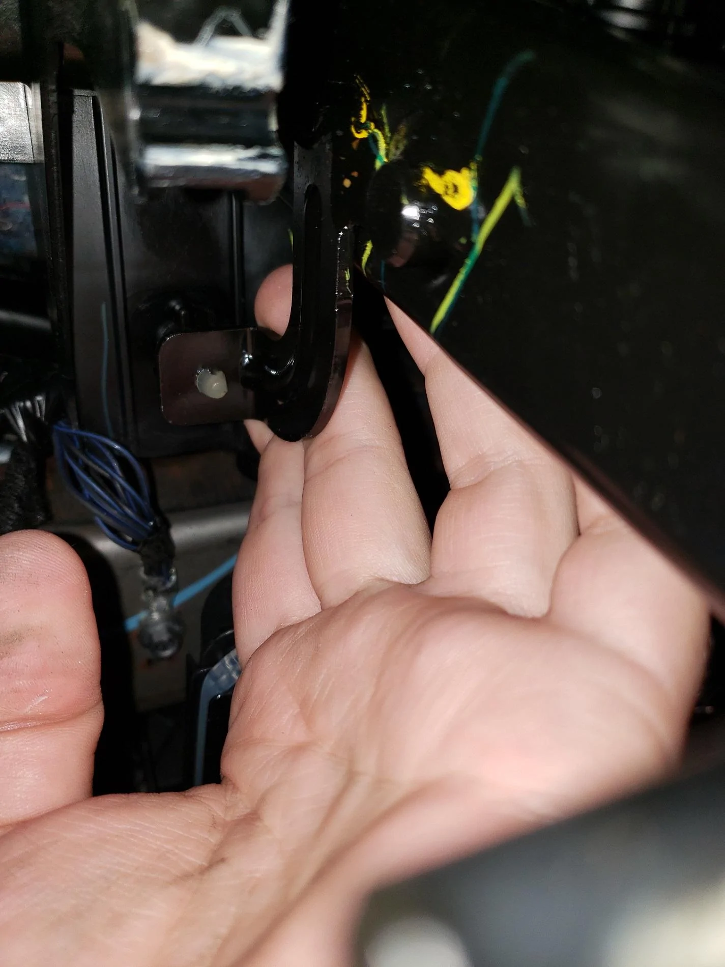

Could you point to me where the switch is? I also have the steeda spring, want to make sure it's not interfering with any functions of the car.
Edit: just talked to ford performance, they neither confirmed nor denied the clutch spring can cause problems, only said it "they can see why it might". But that's enough for me to start thinking about putting back the stock springs. I'd still like to know which switch you guys are talking about though, only switch I remember seeing is the one for starting up the car that's behind the clutch, so when you press the clutch down, the car can be started. Also confirmed with them that no-lift shifting is a feature built-in to all 2018 manuals, so I'll try that after making sure the whatever switch is still working as it should.
There is a button that this piece of metal engages when the clutch is not depressed.
Awesome, thanks! I'll get under the dash and check it after lunch. :thumbsup:
No problem. It's pretty far up on the clutch arm. I pressed my clutch in while keeping my finger on it. The button extends a pretty good distance before it is fully released. Also, I removed my clutch spring over a year ago and have not had any issues. Though, I have a 2016, which doesn't have no lift shift.
