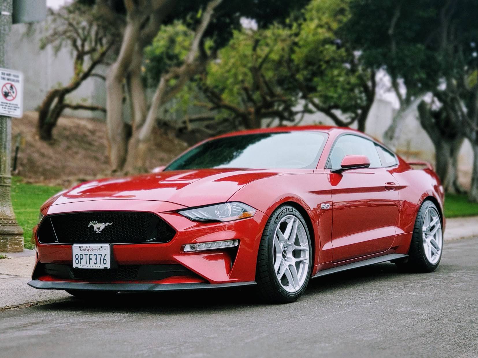

My S550,which I have since sold, the rear dropped .7" while he front dropped .875"
