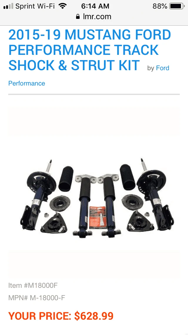

So would adding this to stock pp1 car be a worthy investment and handling improvement?

Yes, definitely. Handling and ride.
$518 not bad. I assume this would be something I could do myself without need for spring compressor etc.? Not interested in lowering car. Would I need a 4 wheel alignment after install?

You would definitely need the spring compressor unless you bought a full preassembled kit. If you use your stock springs, the full range of compliments you normally see on here won't apply but it will be better than what you've currently got equipped - no drop though. Yes, definitely a 4 wheel alignment after install.

You can rent spring compressors from auto stores. I’d get at least a 5lb hammer and extra splined bolts in case you damage them getting them out. Can’t remember the part name.
