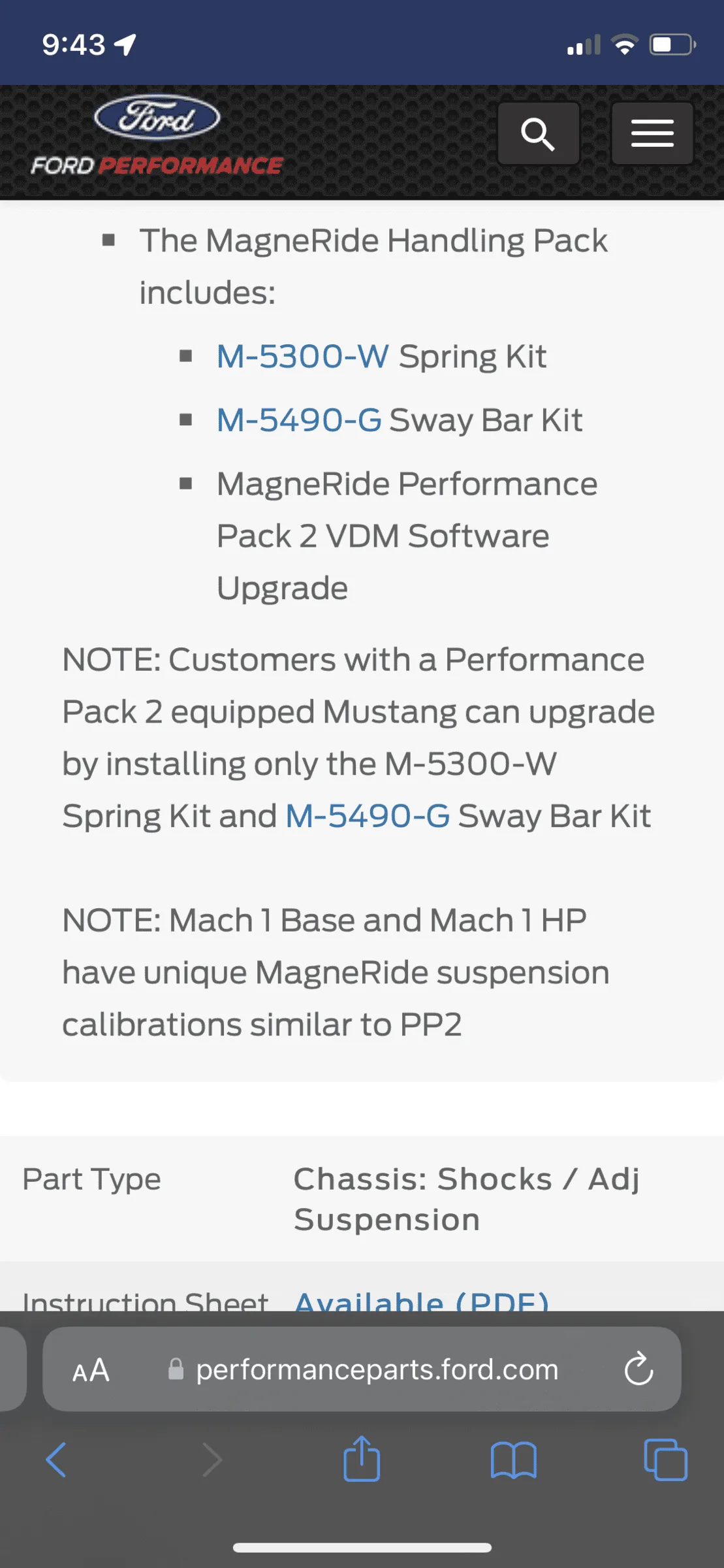

Any suggestions on lowering springs for a 2021 Mach 1 Handling Package ?
Can't seem to find anything on the internet.
I think the springs and bars from the FP kit are still an upgrade for the M1 HP :like:
https://performanceparts.ford.com/part/M-9602-M
Note the wording :
I know for sure that the spring rates are higher and bar diameters are larger than the M1 HP.
Might be worth a call to FP to double check suitability / that it ticks the boxes you are looking for :like:

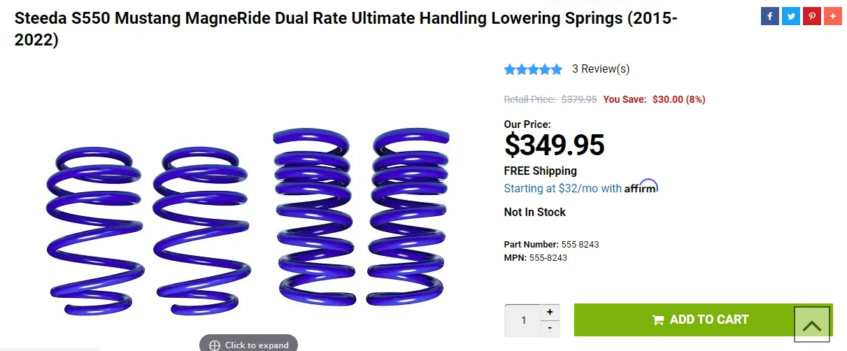

Thank you guys! Was initially looking at the FP and Steeda Dual Rate springs.
Anyone knows the spring rates for the FP ones ?
