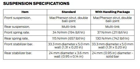

Would anyone have the spring rates on the regular Mach 1 and the Mach 1 Handling Package? Thank you
