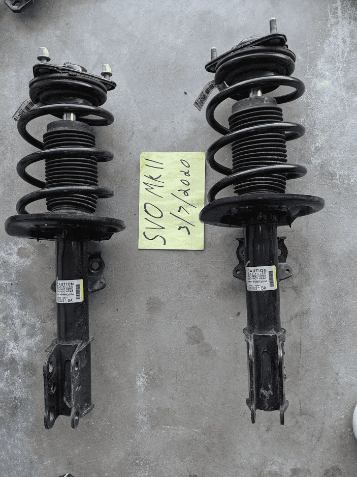

SVO MkII
Mar 1, 2018
35
647
286
IL
2018 Ecoboost, 6sp, PP, 2017 GT Convertible
I've asked this question on another thread, but this might be a better place for it;
Q: Would an entire suspension from a 2018 EB PP coupe offer an improvement in handling/control over the stock suspension on a 2017 GT convertible?
I replaced my '18 EB PP with the FP Track Pack last year and I still have all the stock PP parts. I just picked up a stock '17 GT vert and feel that the handling/control is not as good as the '18 EB was with the PP suspension. The GT vert will be a cruiser (the EB coupe is the track car), so I don't need track ready suspension. But I do like a controlled, confidence inspiring ride.
My main concern is the front springs with the EB PP setup, given the weight increase with the GT. It is maddening trying to figure out the differences between the various Ford part numbers. I was hoping that maybe I could cross reference the EB PP parts with GT parts to see if they are similar/same. Virtually impossible to do (for me at least). Here is a pic of the '18 EB PP front struts. You can see the part numbers for the springs and the struts. I can't match these specific part numbers anywhere. Any thoughts/suggestions are appreciated.
TicTocTach
Mar 15, 2018
983
1,010
DFWTX
Clair
2018 EBPP
A quick check would be to put digital calipers on the spring coil and measure the thickness. If the EBPP spring coil is thicker than the GT spring, it will most likely be stiffer. You could also take the VIN's and have a dealership cross reference the numbers on the parts, but those numbers don't seem to be the same as the PN's in the online catalogs. I agree, it's a giant PITA. Have you looked in the big spreadsheet that is out there for spring rates, etc. by body type? Ecoboosts are
All that said, I don't think the weight of the EBPP is enough lighter than a GT to make a difference in the long run. My car ('18 Premium EBPP +Magneride) weighs MORE than a GT350R. I replaced my EBPP+MR springs with GT350R springs and there was essentially zero change.
