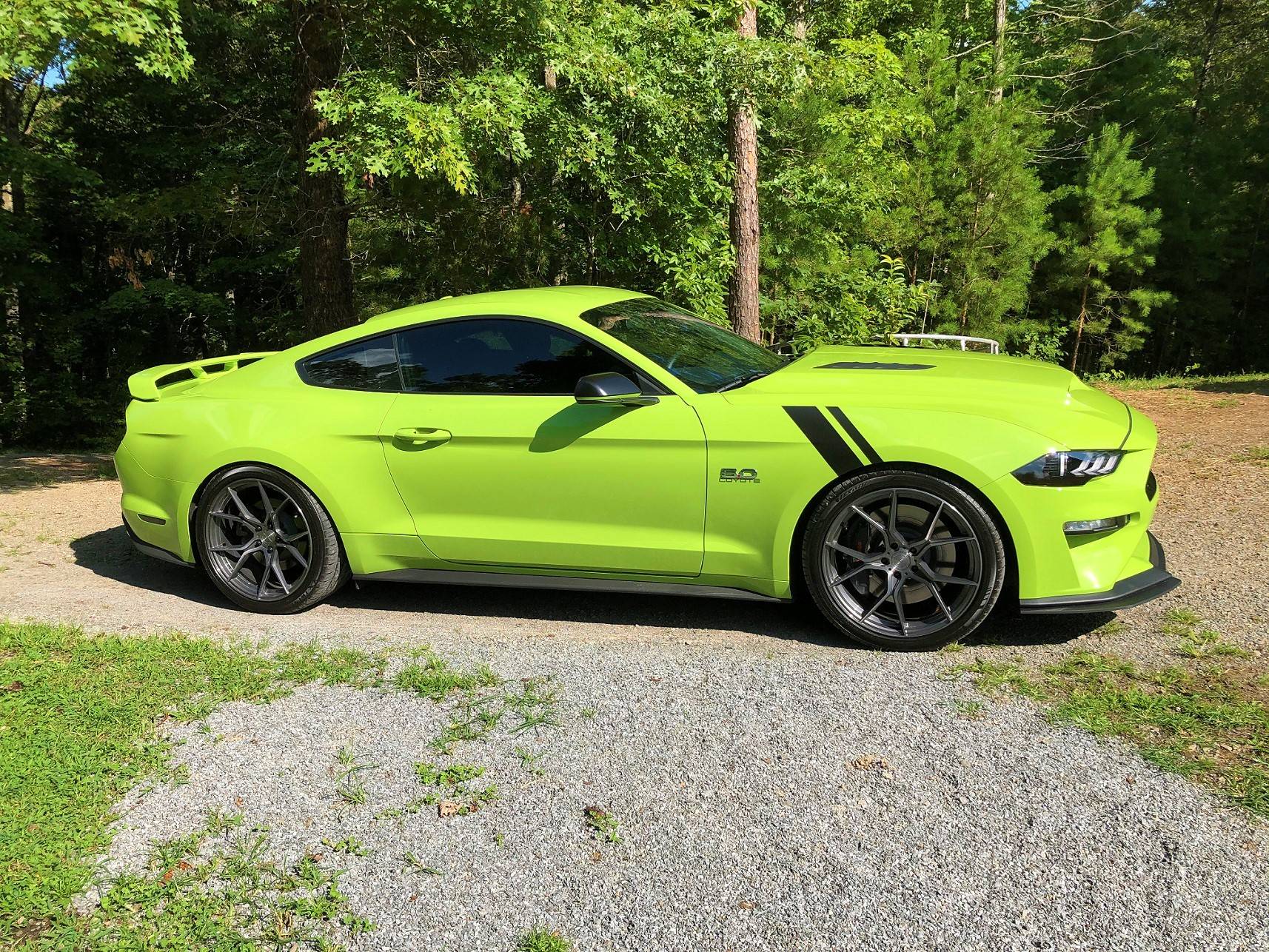

Installed the Steeda Ultra Light springs last week on my 2020 GT PP1. Just wanted to share what others have said, they seemed to drop the car way more than the advertised 1.125" F / 1.0" R. The rear is so low that I don't even want to clock the bushings at the risk it will drop lower. Just ordered a set of BMR springs for a more subtle drop. I have maybe 1/8th of an inch or less in the rear wheel gap, don't feel comfortable with that personally. I didn't even have to compress the front springs to get them installed on Koni front struts either. No rubbing though.

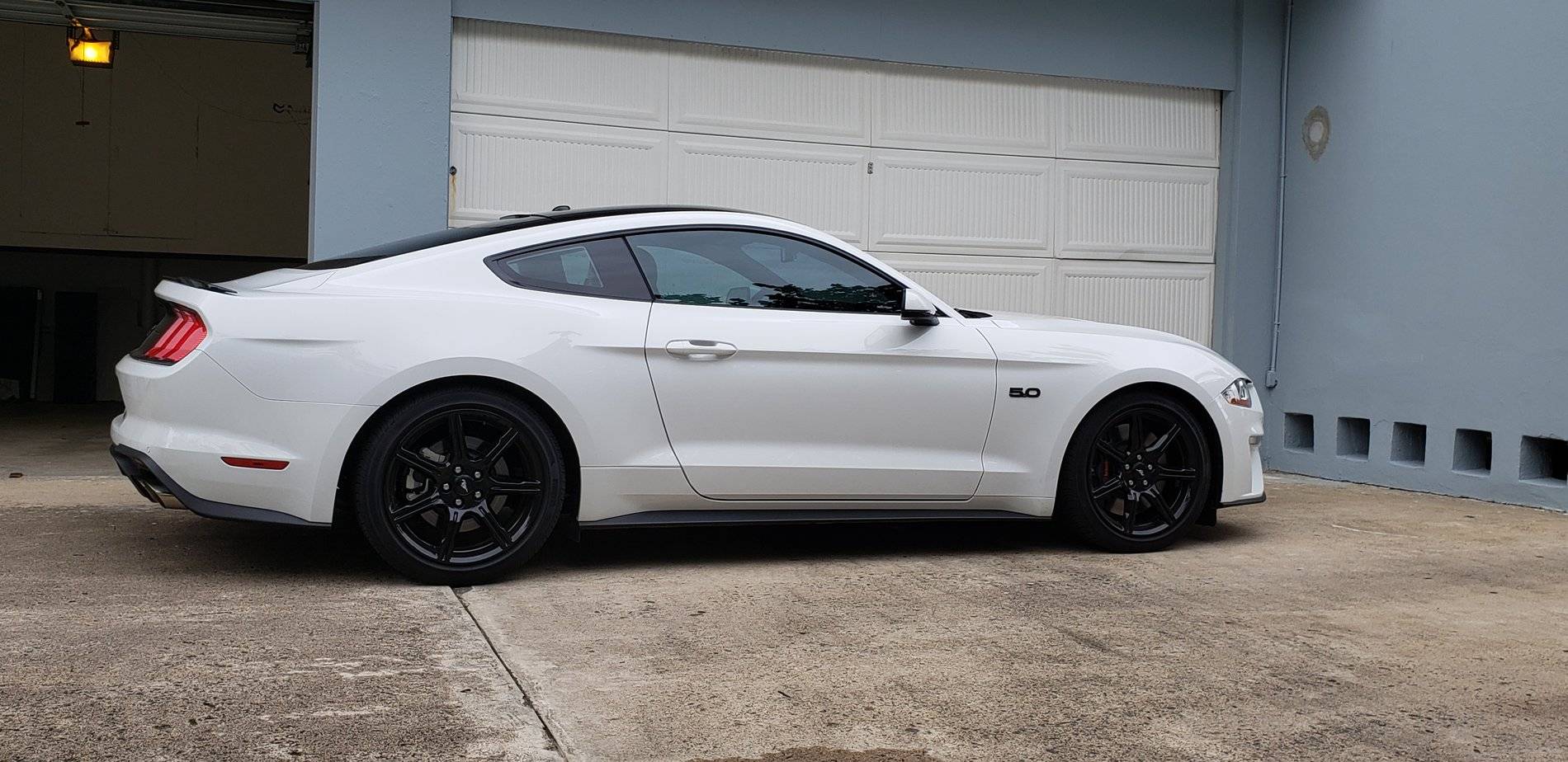

Here is my GT with the steeda minimal drop springs, it sits lower on springs than what I have seen from previous years for whatever reason so these worked perfect.
