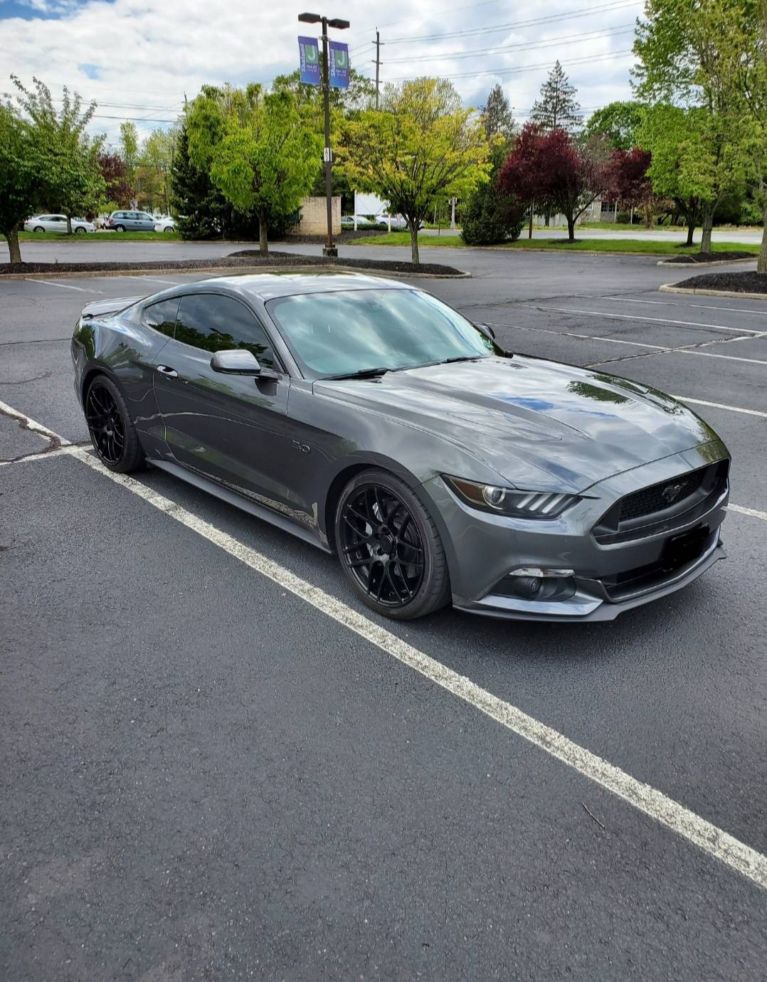

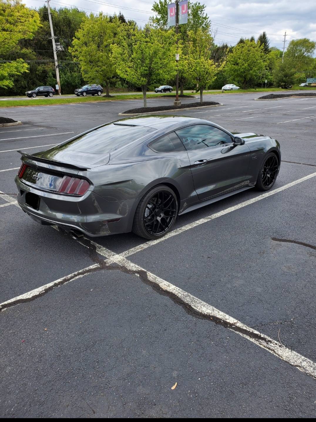

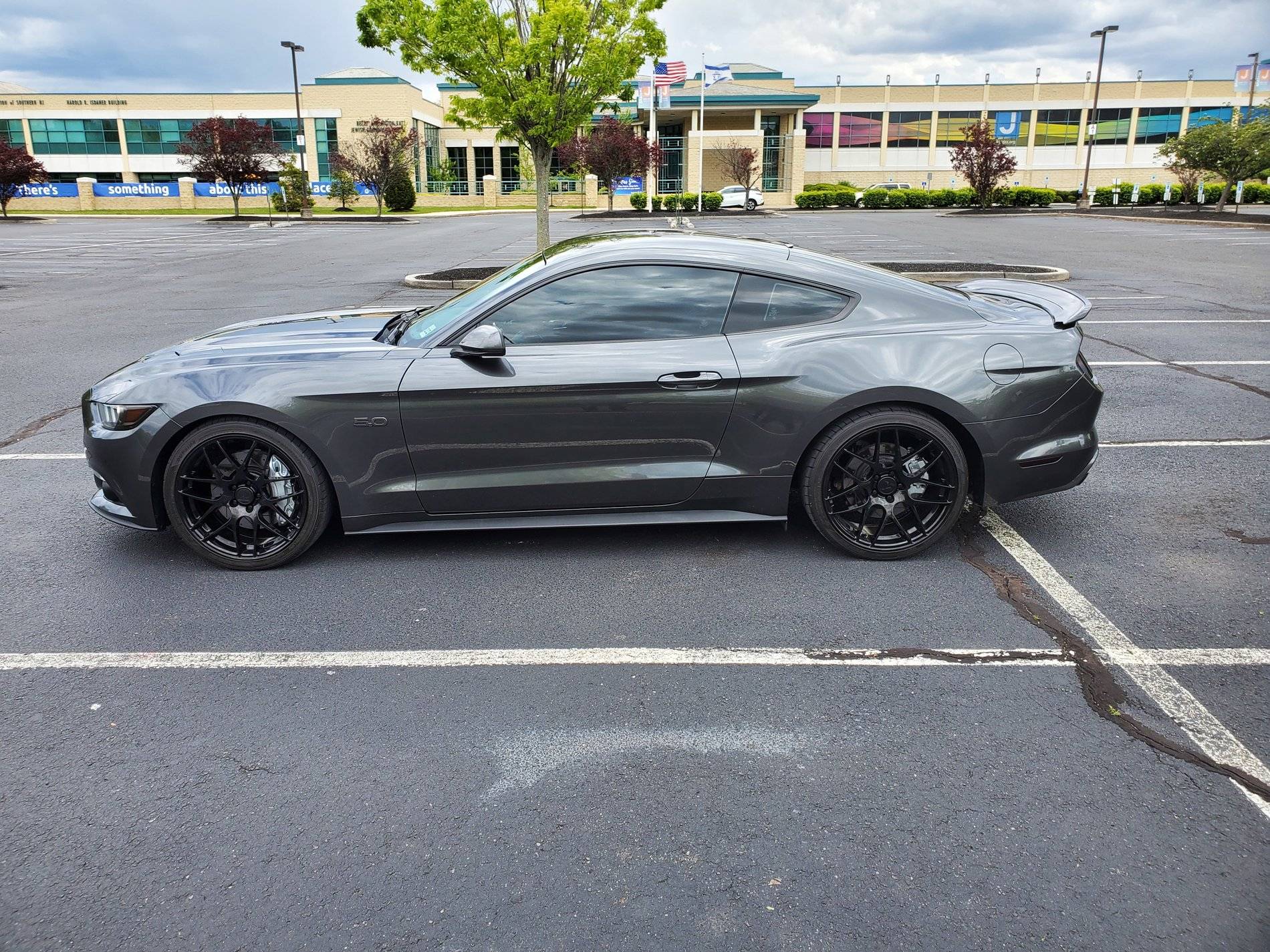

I installed ford performance track strut/shocks and bmr sp763 spring kit this weekend. I'm pretty happy with the look with the mild drop and with the new dampers it feels just like stock as far as harshness, but way more planted coing around curves.
