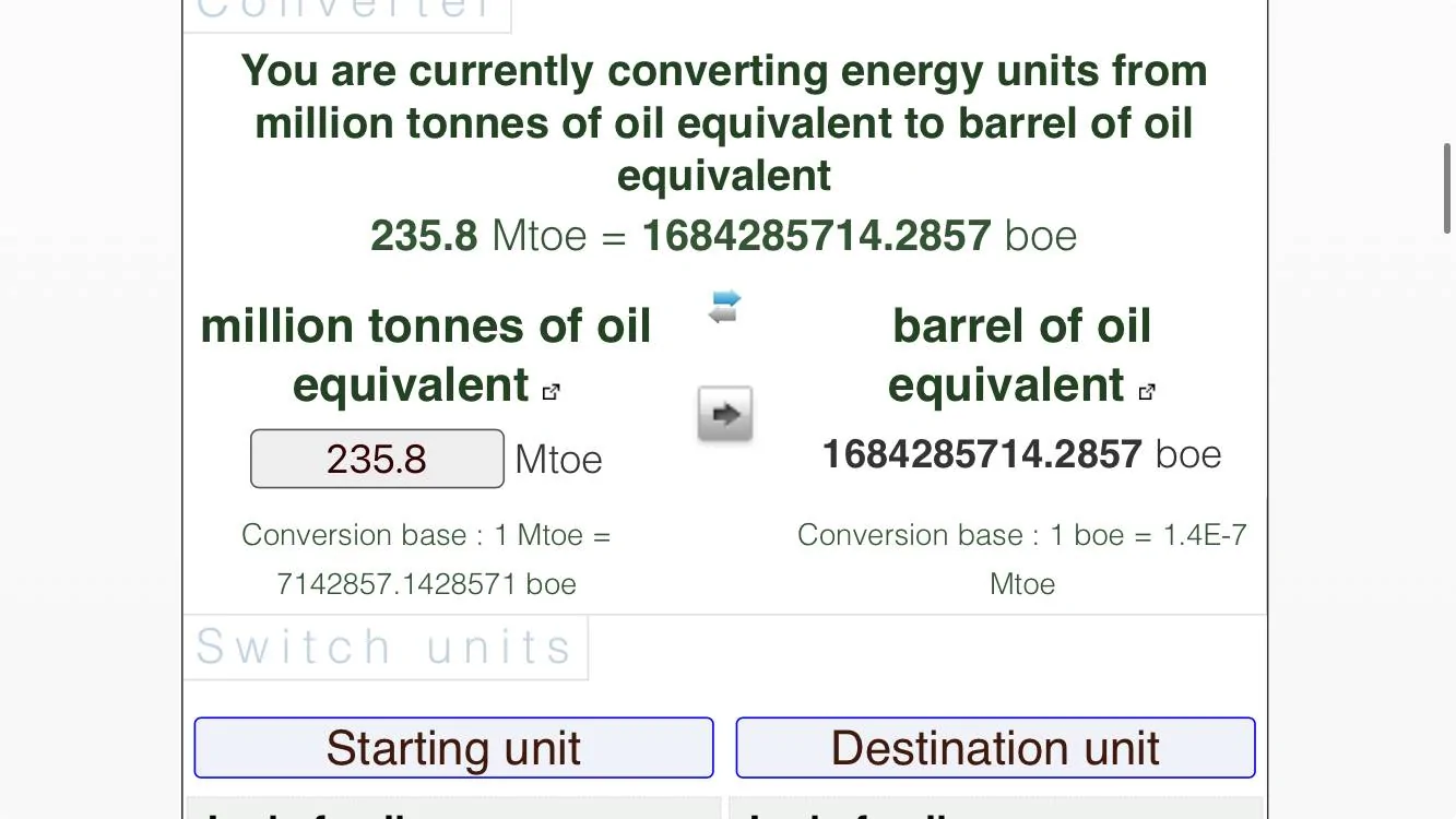

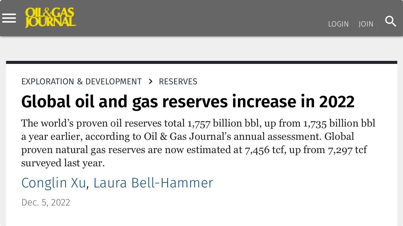

It states "By the end of 2012, there are only 235.8 million tonnes of proved oil reserve in the world." Conveniently, that is exactly 50 years worth of oil reserves at the world average consumption since 2012. Bullshit.
Yea, I wondered about that too. If I recall correctly "they" thought we were going to run out of oil around 1960.
I do come from a fracking background and last I recall there was 3 or 400 years of known oil at the then current rate of increase in use.. 2012 or so.

So I am already having an issue with the article in the introduction. It states "By the end of 2012, there are only 235.8 million tonnes of proved oil reserve in the world." Conveniently, that is exactly 50 years worth of oil reserves at the world average consumption since 2012. Bullshit.
I imagine if oil exploration stopped in 2012 the reserve would be less today. But exploration continued and here we are a decade later.
