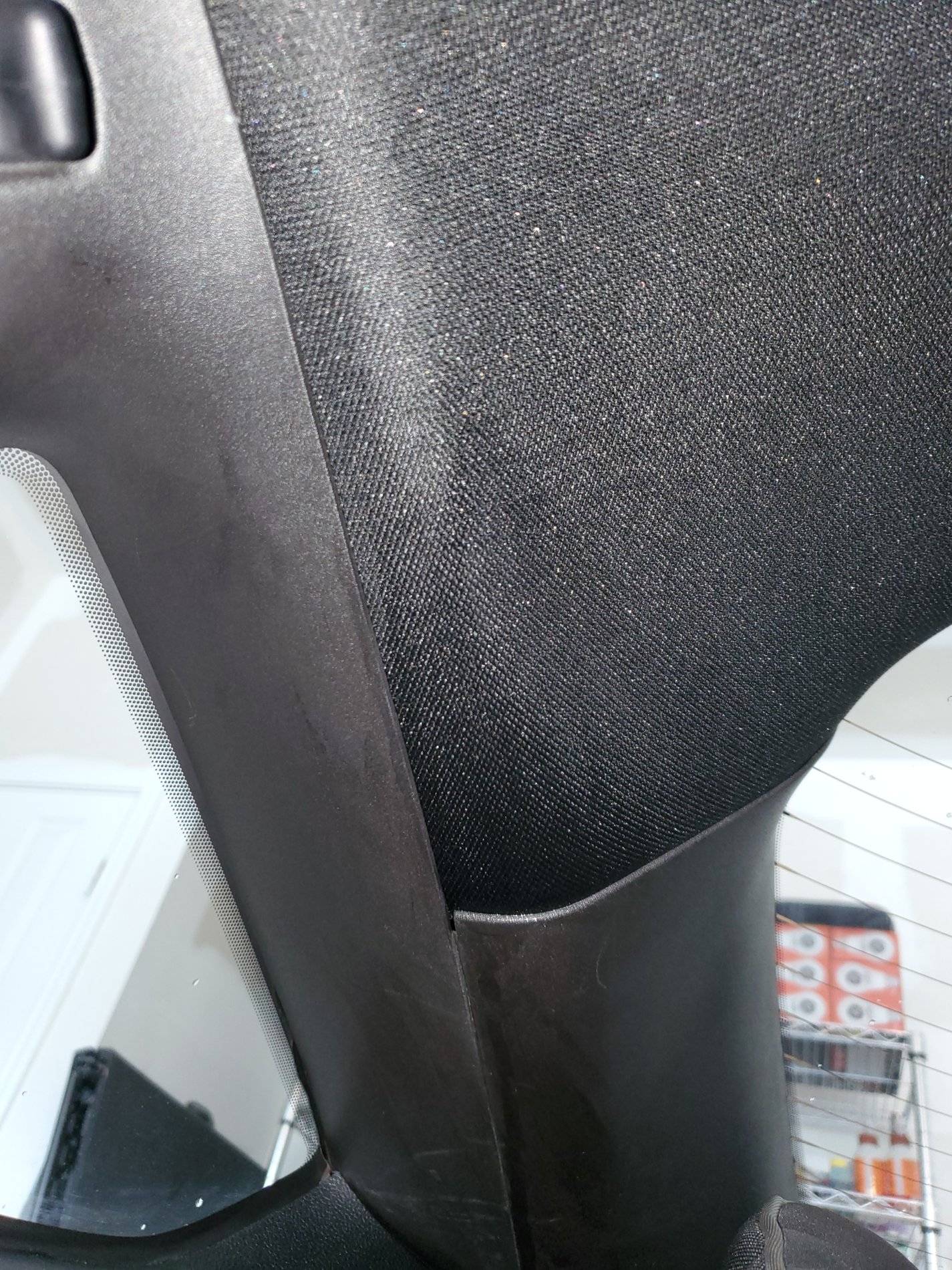

Now this is completely off topic but have ever had an issue with your mustang leaking water through the rear windows panels of the car? I went to wash my car the other day, and water was leaking on the back passenger side of the headliner near the rear window.
Like this:
