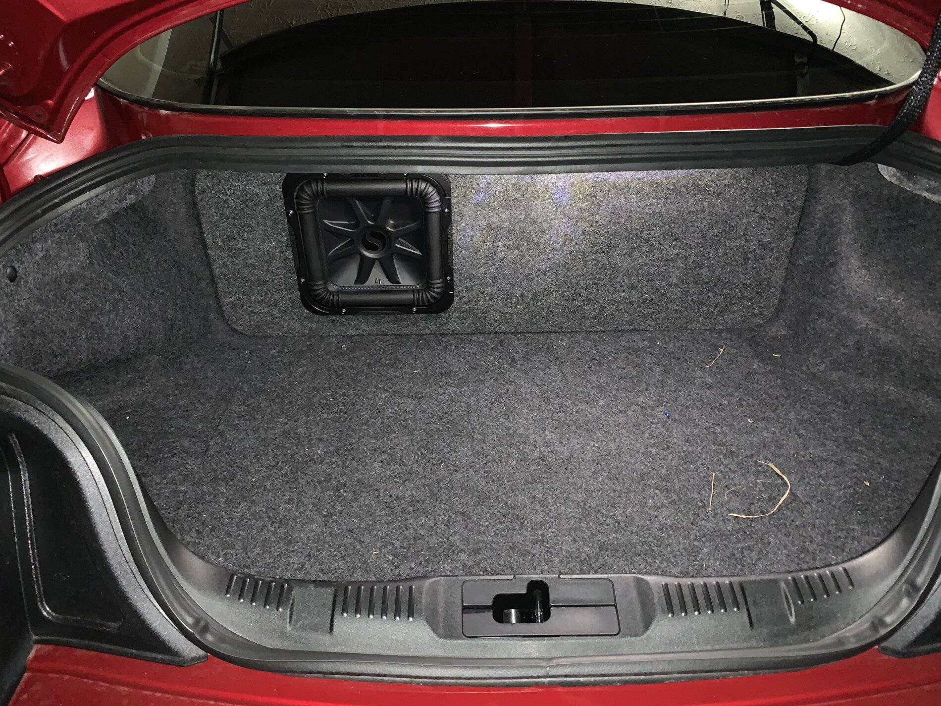

Stage one of my sound system up grade is complete.
I have a 301a GT, which includes the 9 speaker system with sync 3. Overall it’s not terrible, but leaves a lot to be desired.
I decided I’d breakmy upgrades down into stages until I get to something I’m happy with, stage one is add some bass, stage two is change door and deck speakers on the factory amp, and stage three is a dsp and 5 channel amp. I’m really hoping, though not expecting, to be happy with changing the door and deck speakers and leaving the factory amp.
As for stage one, I went with zenclosure’s box with a kicker L7S 10” sub, for an amp I’m reusing an older Kenwood amp that’s rated for 500w rms at 4 ohm. The birth sheet for the amp comes in at just over 500w (512w if I recall) but that was many years ago. Connected to the rear speakers via an LC2i. I also disabled eq via forscan.
Going to take a little time and get the sub broken in properly while I look at component speakers for the rest. Any recommendations?
