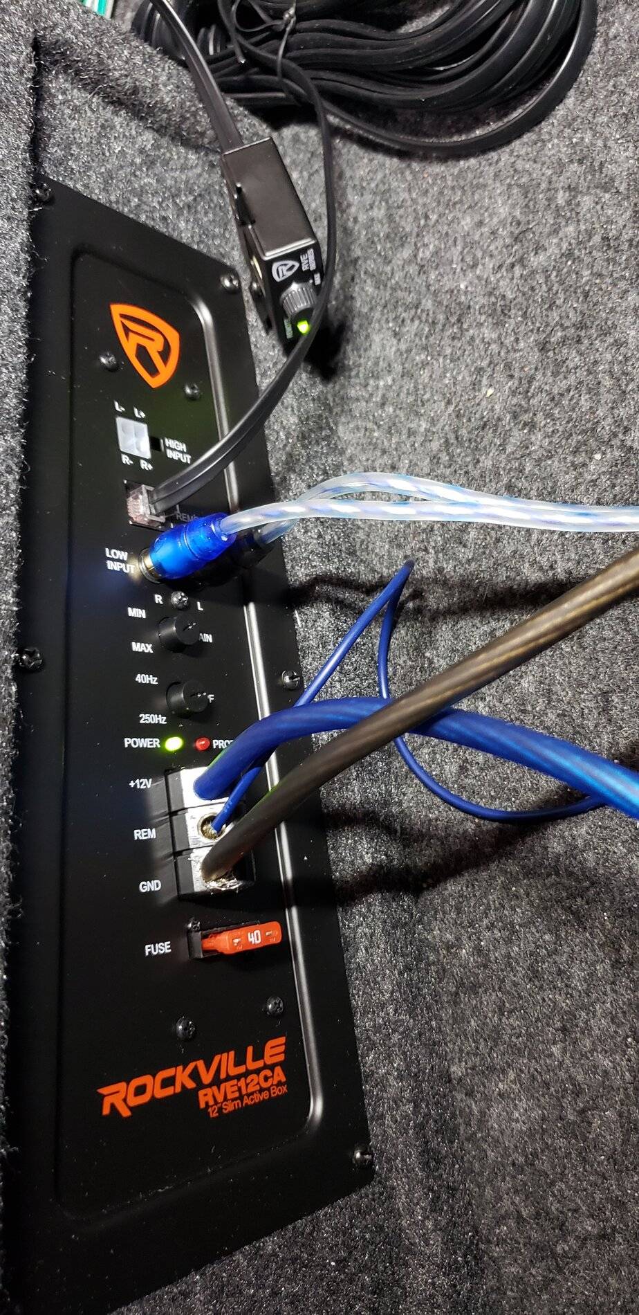

I just installed a subwoofer and I super happy with the results.
Here is what I did.
1) upgraded the door speakers to Kicker 6.5
https://www.stage3motorsports.com/k...-6-5-door-speaker-upgrade-kit-base-audio.html
~ 180$
These have a much cleaner sound than the factor.
2) Rockville RWS12CA Slim 1200 Watt 12"
https://www.amazon.com/gp/product/B01DNT4YBA/ref=ppx_yo_dt_b_asin_title_o08_s00?ie=UTF8&psc=1
This fits perfect just behind the seats, facing the trunk. Speaker is self powered, so less cable mess
I set it to 50% gain, otherwise too gangster for me ;)
~150$
3) Wiring kit is crap on the Sub\Amp so I went with:
TOPSTRONGGEAR 4 Gauge Amp Kit True 4 AWG Amplifier
https://www.amazon.com/gp/product/B07WTTV19N/ref=ppx_yo_dt_b_asin_title_o01_s00?ie=UTF8&psc=1
~38$
4) Since I was going to replace my 4inch unit with an 8 inch, I decided to use a harness kit for the RCA inputs:
2015 - 2020 Ford Mustang 4 OR 8 Inch Screen Non Amplified Base Model Radio Plug & Play Audio Harnesses: Kits Ă— 1
https://plugnplaykits.com/products/...io-harnesses-kits?_pos=2&_sid=7f64f4692&_ss=r
~65$
* Blue remote wire does not work with the harness, amp stays on. I just tapped into the trunk wiring cables , its the blue wire with white strip.
Ground cable tap: I attached a bolt\washer where the spare tire goes, there are two spots to put a screw, this works even with the spare tire.
I Hope this helps someone. The difference with this sub is night and day, even with the seats up.
I copied your setup. Everything seems to power on but no sound comes from the sub. Did you have any problems when you first powered it up?
CricketSP
Jun 26, 2019
Pembroke Pines Florida
2020 Mustang GT Base Model 10R80
No issues with sound, did you use the same harness and connect the RCAs ? I did make sure the sound worked before I put the stereo back in place. Maybe the cables got disconnected? It was a pretty
right fit with the harness, RCA/ adapter.
